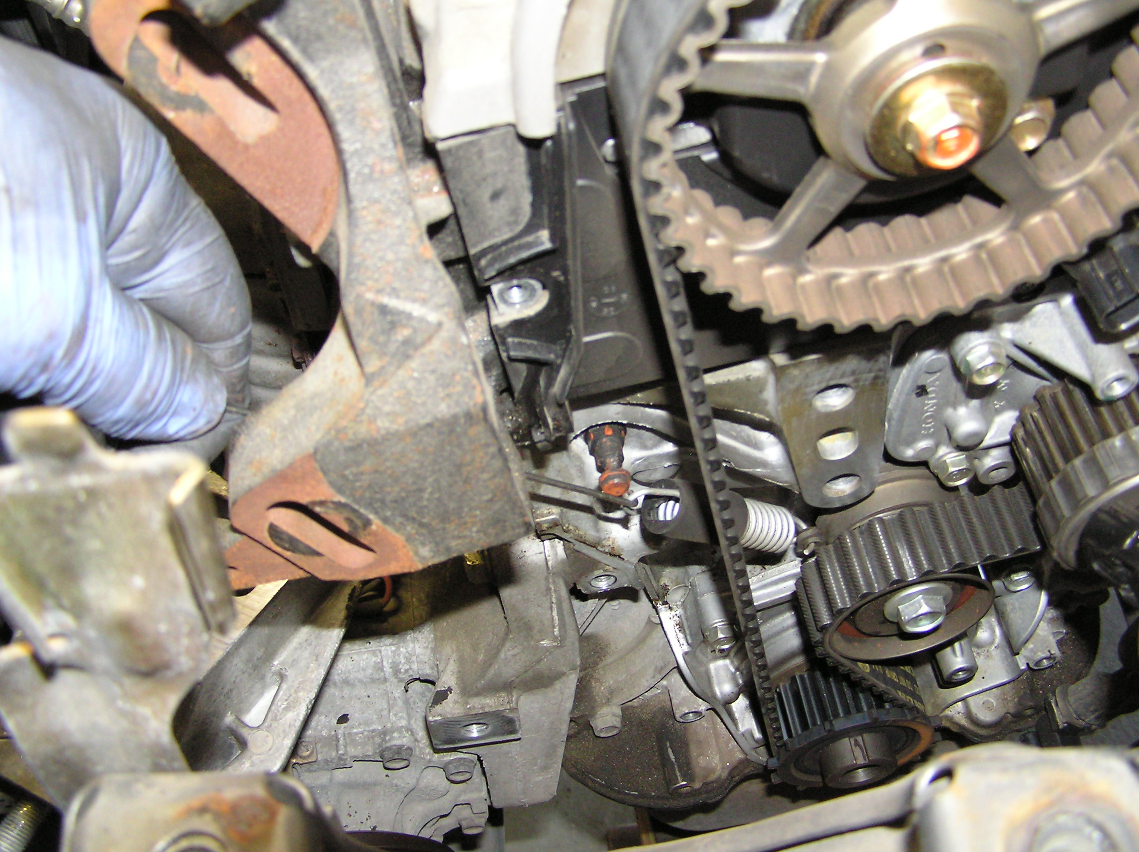

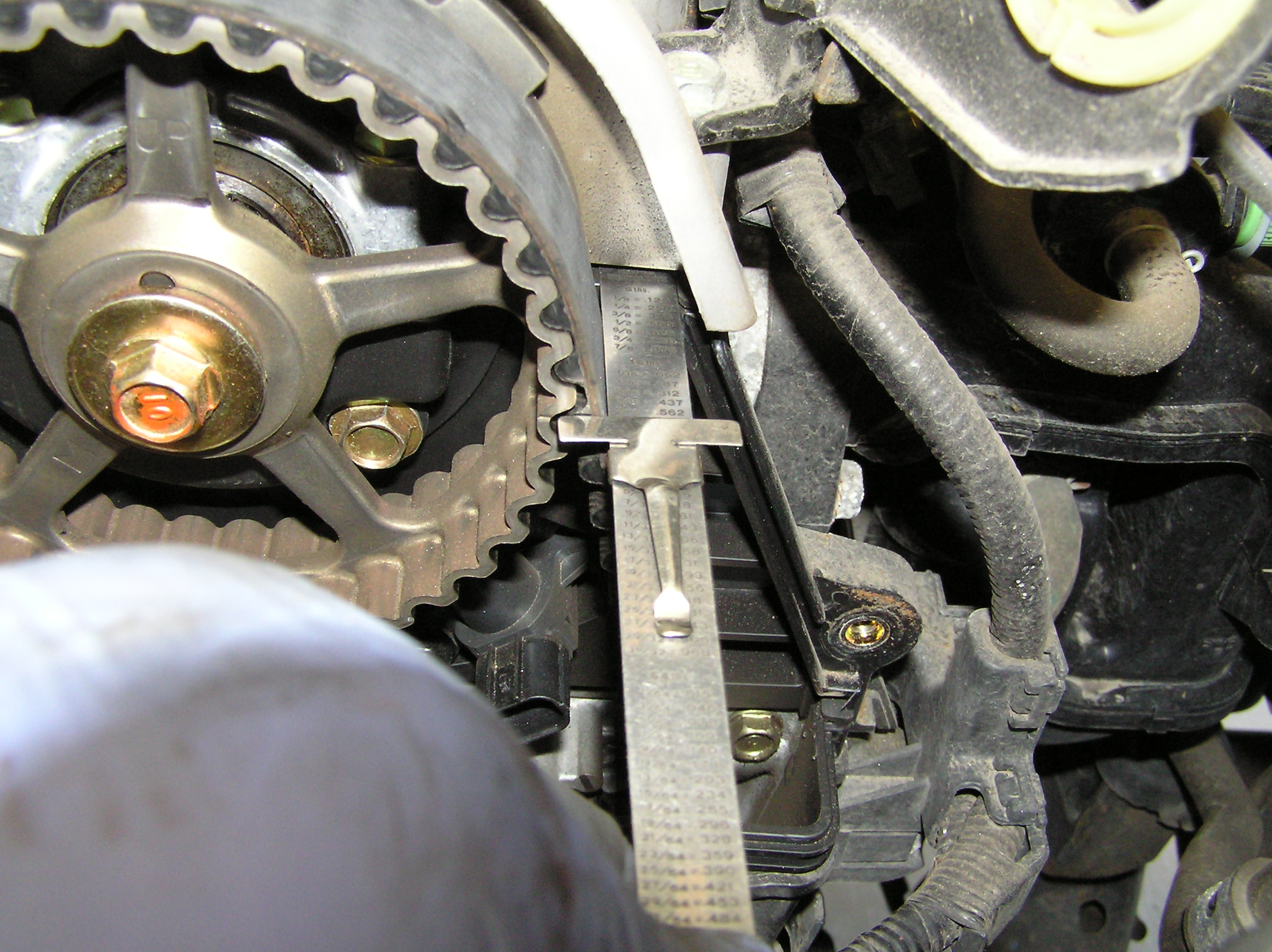

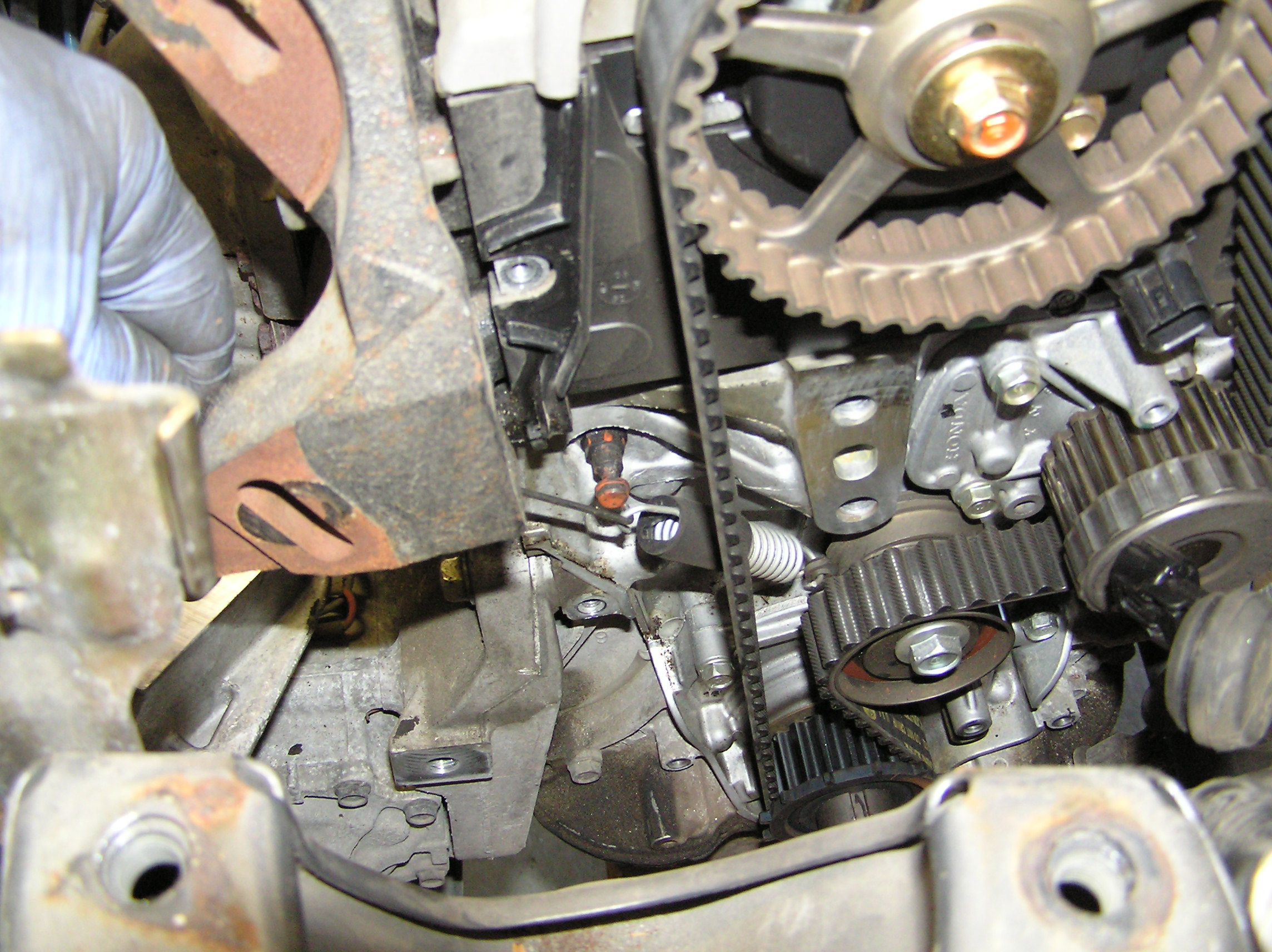

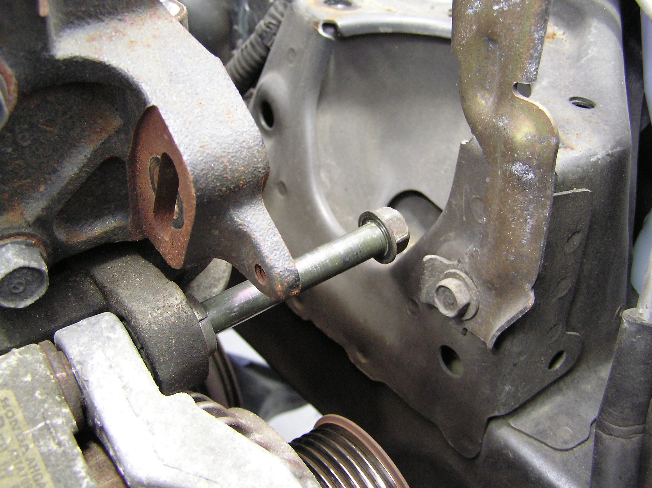

Re: Can't Seem To Remove Upper Timing Belt Cover
If you don't have the cast bracket correctly installed within the folds of the inner plastic covers, then that might make the outer covers difficult to fit properly.
They all seem to eventually break out one of the bolt holes from the lower cover too.
Ill see if I can come up with some pics in a little while.
Old Apr 28, 2015
Pic
Hold cast bracket up against the block flat on both surfaces, them slide it upward until it aligns with the upper cover and all 5 bolts will thread in easily
Screwdriver points to the area in question:

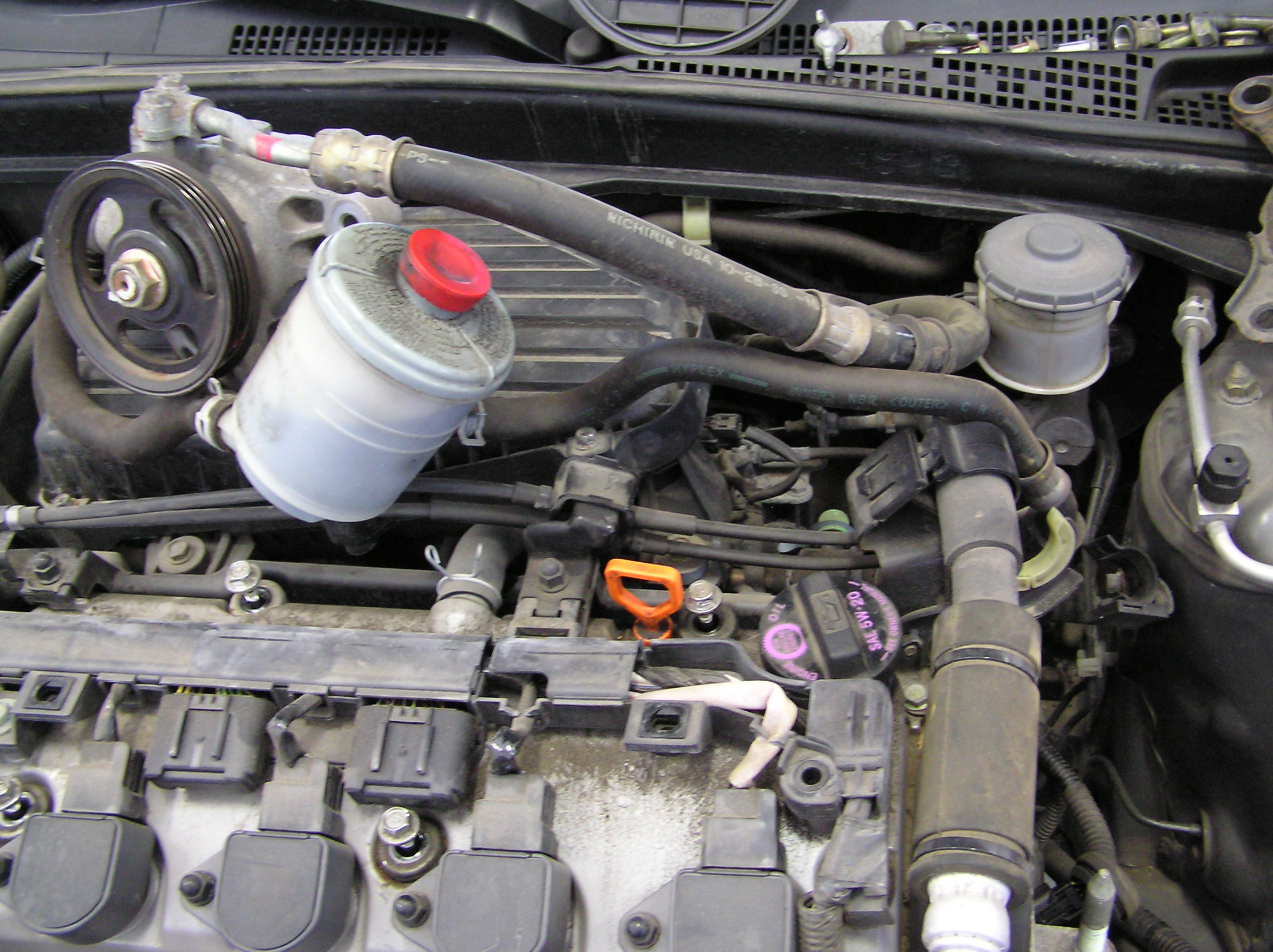

More random pics during 2005 Civic timing belt job this afternoon

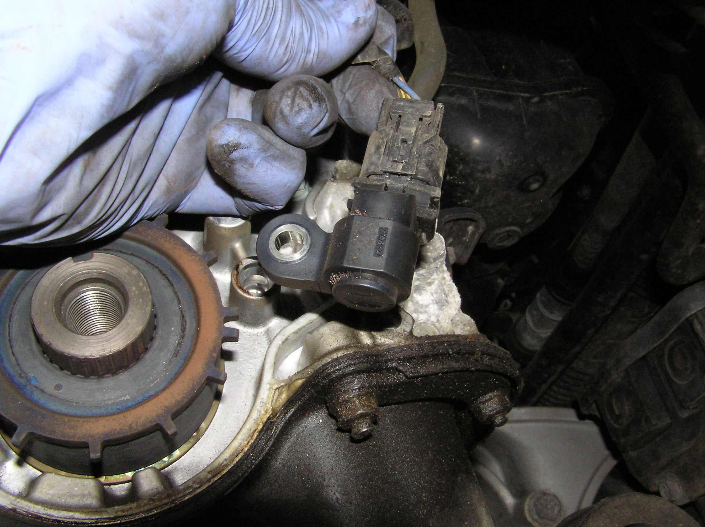

When looking at that one photo you posted the ribbed spline on that crank extends to the end of the shaft. That was what I was expecting, but NO it's smooth. It stopped me in my tracks wondering "What's the deal with this?" But, then if it purred that way for 123K it should be good for another 123K. Then thinking about it again realized there isn't much stress put on the HB when spinning the A/C Compressor, Alternator and Power Steering. YES, i did remember to reattach the Crank Sensor.

Another Question on that CU Photo of You holding the Crank Sensor (by the Timing Belt Pulley on the Crank Shaft).
Does that splined Timng Belt Pulley behind the Harmonic Balancer only go on the Crank Shaft one way and only ONE WAY (as its keyed?). The reason i ask is because i put two Whiteout Marks on the old Timing Belt before removing it. One mark was exactly at TDC and the other on the TB where it goes around that Crank Pulley. I transferred the position of these two marks on the removed belt to the new TB (same number of teeth apart on both belts). Then put the new TB on in the same position with the Whiteout Mark on same Cam Tooth at TDC.

Another Question with respect to that CU Photo of You holding the Crank Sensor (by the Timing Belt Pulley on the Crank Shaft).
Does that Splined Timng Belt Pulley (behind the Harmonic Balancer) only go on the Crank Shaft one way and only ONE WAY (as its keyed?). The reason i ask is because i put two Whiteout Marks on the old Timing Belt before removing it. One WM was exactly at Cam (Arm UP) TDC and the other on the TB where it goes around that Crank Pulley. I transferred the position of these two marks on the removed TB to the new TB (same number of teeth apart on both belts). Then put the new TB on in the same position with the Whiteout Mark on same Cam Tooth at TDC.
However, after installing the Water Pump, Idler Pulley and turning the Crank CCW to double check TDC the topside Whiteout Mark on the belt was now two teeth to the left of TDC. And yet, those two Timing Marks on the Crank Timing Belt Pulley and Engine Housing were in line with each other with the Cam at TDC (UP) and those Cam marks lined up on each side of the Head. So, according to the Cam (UP) being at TDC and the Crank Marks in line with each other ... the TIMING should be CORRECT ... RIGHT ? As long as the Cam (UP arm) at TDC and the Crank Pulley engraved line is in line with the arrow on Engine Line the TIMNG should be AOK! ... RIGHT ?

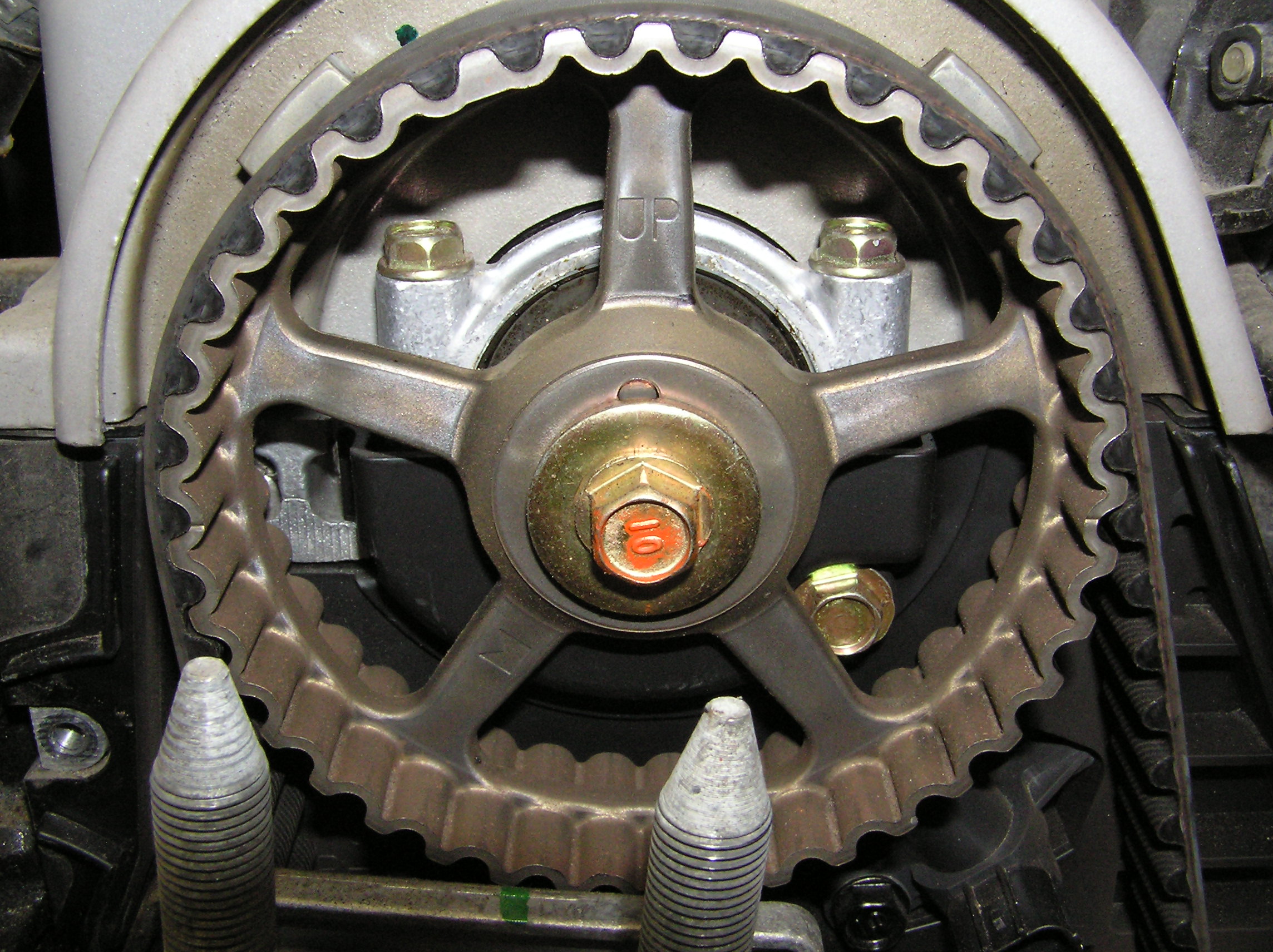

go by the marks on the engine/crank/cam,
if they all line up you should be fine

Apparently the only thing holding the HB in place is that little key and 180-200 ft. lbs. of torque?
Yup. The key is only there to keep it correctly aligned during assembly....After torquing, the bolt does all the holding.
to remove the AFC from my CivicEX is a challenge i haven't yet conquered. Any suggestions would be most appreciated
There is like a large hose clamp around the base of the filter housing at the throttle body that needs loosened.
Right. Reluctor teeth outward.
You know what's wrong with this method?
If it was wrong to begin with, your new one will be wrong too. (When one does this all the time, one learns to never trust the last guy that had his grubby mitts in there, he might have been an idiot.)
Use the factory timing markings and methods.
At least double check against the factory marks before you close it up. Factory marks are always trustworthy.
See the pic of the steel ruler aligned with one side of the cam gear, the slashes stamped in the edge of the gear in two places are the timing marks. The word UP is only used for orientation, and so one may know which cylinder should be at TDC (#1 or #4) when adjusting valves.
I wrap around crank and cam first so I can check marks as I go, then around the water pump and lastly the tensioner pulley.
Always refer to the factory timing marks.

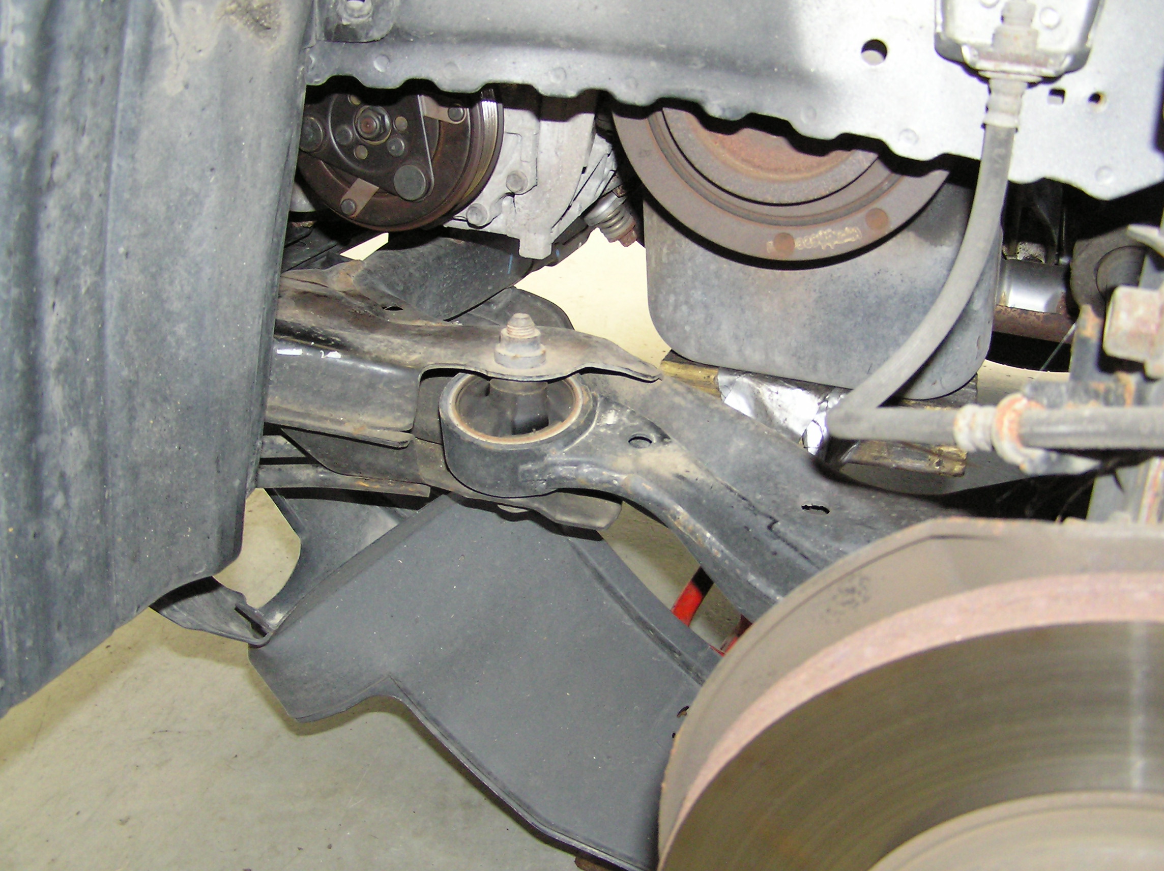

The protective spash guard covering the Harmonic Balancer and A/C Compressor Pulley was missing so am fabricating one to fit from another Honda. Also the nearby lower front wheel fender liner needs some refab with partial liner i removed from another Salvage Yard Civic. Still have to figure out how to remove the abused Air Filter Compartment and reinstall with a good/used U Pull R Parts replacement.

Finished installing the modified spash guard to protect the A/C Compressor Pulley and Harmonic Balancer. Also repaired the nearby lower part of the Fender Well Liner. Thought I would have the Valve Cover on by now ... maybe will still get everything else that needs to be done under the hood yet today ... even if i have to use a Trouble Light to FINISH. Then give it a rest, sleep on it and take a mental inventory of anything I may have forgotten to do. Will wait to install the battery tomorrow morning and then turn the Key ... don't want to rush these things
