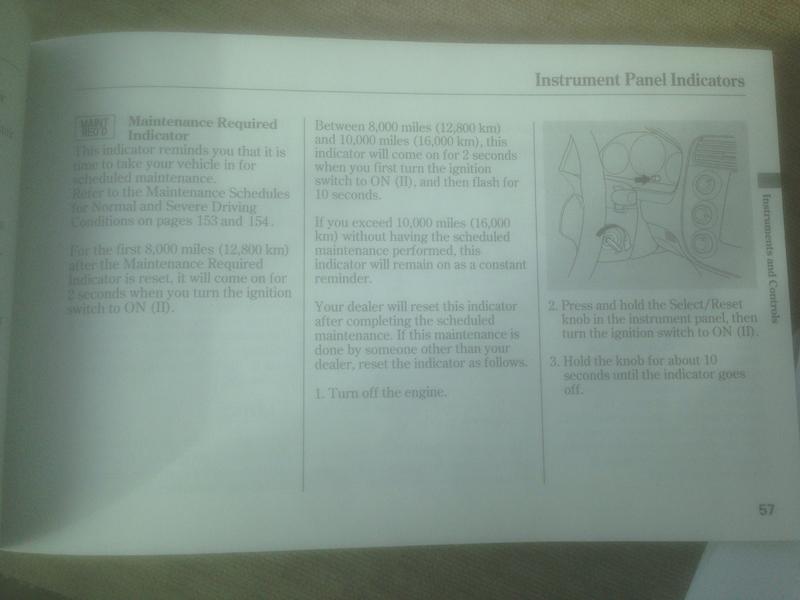

Hello everyone. New member, first time posting. I hope this helps.
