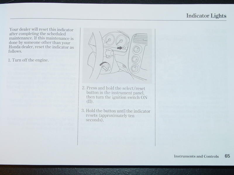

Arrow
For the people that are too damn lazy to look in the manual here it is.
