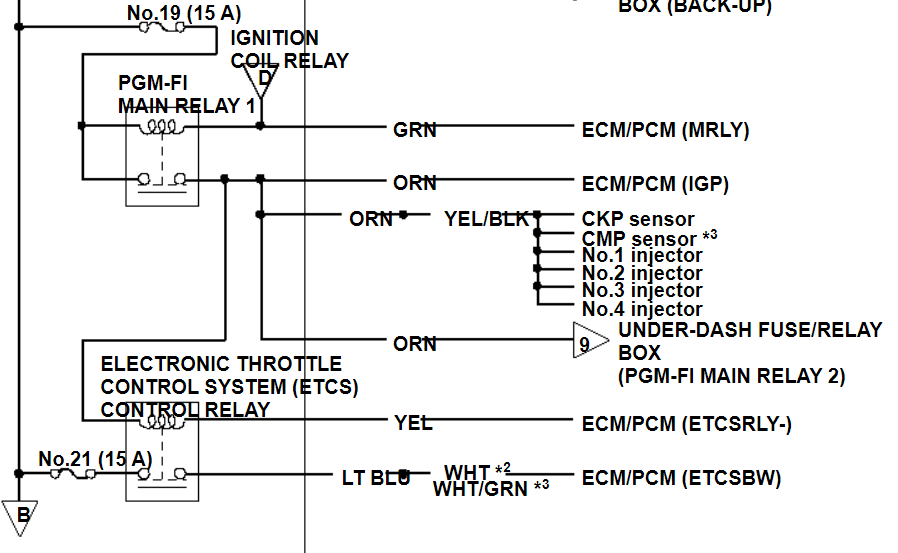

Fuse 19 keeps popping, it’s called a F1 Main fuse, but I’m not too sure what it powers as I can’t find anything about it anywhere I look

Need to check what components are on that circuit and disconnect them one by one until the fuse stops blowing

it’s hard to find anything on this fuse. Checked forums, owners manual, online, nothing on the F1 Main fuse
Unplugged everything on the wiring harness that goes to the fuse box and it would still blow. Unplugged it from the computer and it wouldn’t blow. Thinking something on my harness, or the computer is fried. Gonna try a new harness later today

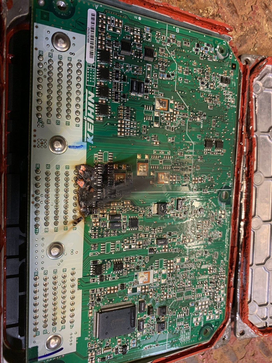

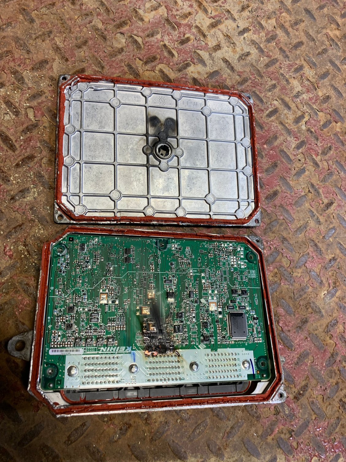

found the issue
bad computer
tested the computer by putting a test light on the fuse that was popping. The light turned on meaning I had a short somewhere. I hooked up another computer and ran the same tests and the light wouldn’t turn on. Took the old computer off and tore it open to find burn marks on the inside

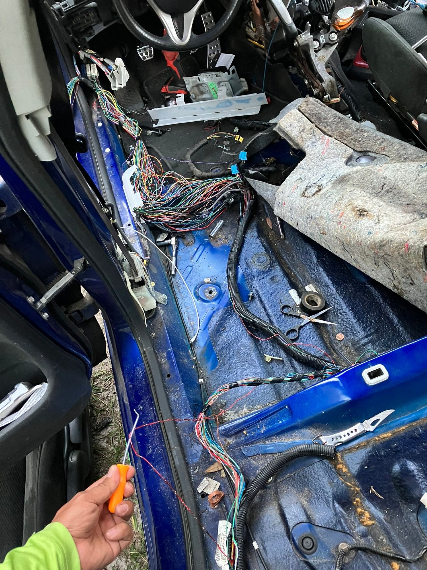

Have the same issue. 15 & 19 keep blowing. Tore everything up and found
Old Oct 27, 2023
BrotatoChip's Avatar
Super Moderator
Joined: Jun 2012
Posts: 5,073
Likes: 2,096
From: Ohio
Rep Power: 225
Re: 2007 Civic Fuse 19 keeps popping [solved]
Left us with a cliffhanger. Is the wire burned below your pick?
Old Oct 27, 2023
bluesluggishsi's Avatar
Joined: Oct 2023
Posts: 2
bluesluggishsi is an unknown quantity at this point
not sure how to use this , but yeah it did. I used a bigger fuse then what’s intended and obviously fked it up myself
