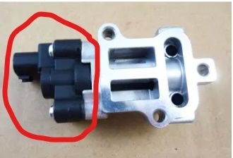

In cleaning the IACV, should you take out the sensor part (red encircle on the image)? If yes, is it safe? Because I've watched some videos on youtube that they are also taking that part out to thoroughly clean the valve. I want to give it a try but I'm afraid if that will give me a problem after putting it all back.
By the way, the photo is not the actual IACV from my car. I just grabbed it. Mine is dirtier.

Yes you can pull it off. That will allow you to spin the valve by hand to make cleaning easier. Those screws will likely strip or break on you and you'll have to replace them.

Is there a proper adjustment or alignment of the sensor and the valve when putting it back? And do you know what is the size of the screws?

Originally Posted by felicianojerome
Is there a proper adjustment or alignment of the sensor and the valve when putting it back?​​​​​​
The valve has a "key" on it so the solenoid portion will only fit one way.
And do you know what is the size of the screws?​​​​​​
You may get lucky and not have issues with the screws. I don't remember what size they are.

Remove the screws with an impact screwdriver to prevent stripping the slots. Harbor Freight sells one for $7. If they do strip use a reverse drill bit to back them out. When you get them out bring to Honda dealer or Ace hardware and match the diameter/pitch/length. Also, a 10 grade or higher for heat expansion.
If you do remove it you might as well order a gasket for it, and the larger gasket for mating to the cylinder head.

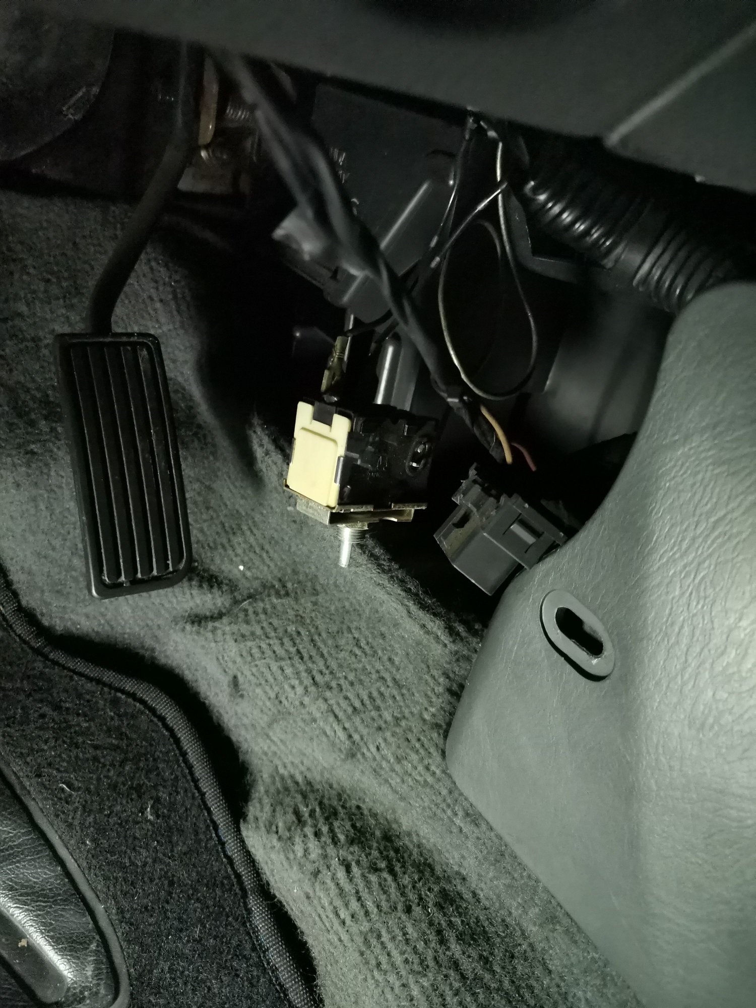

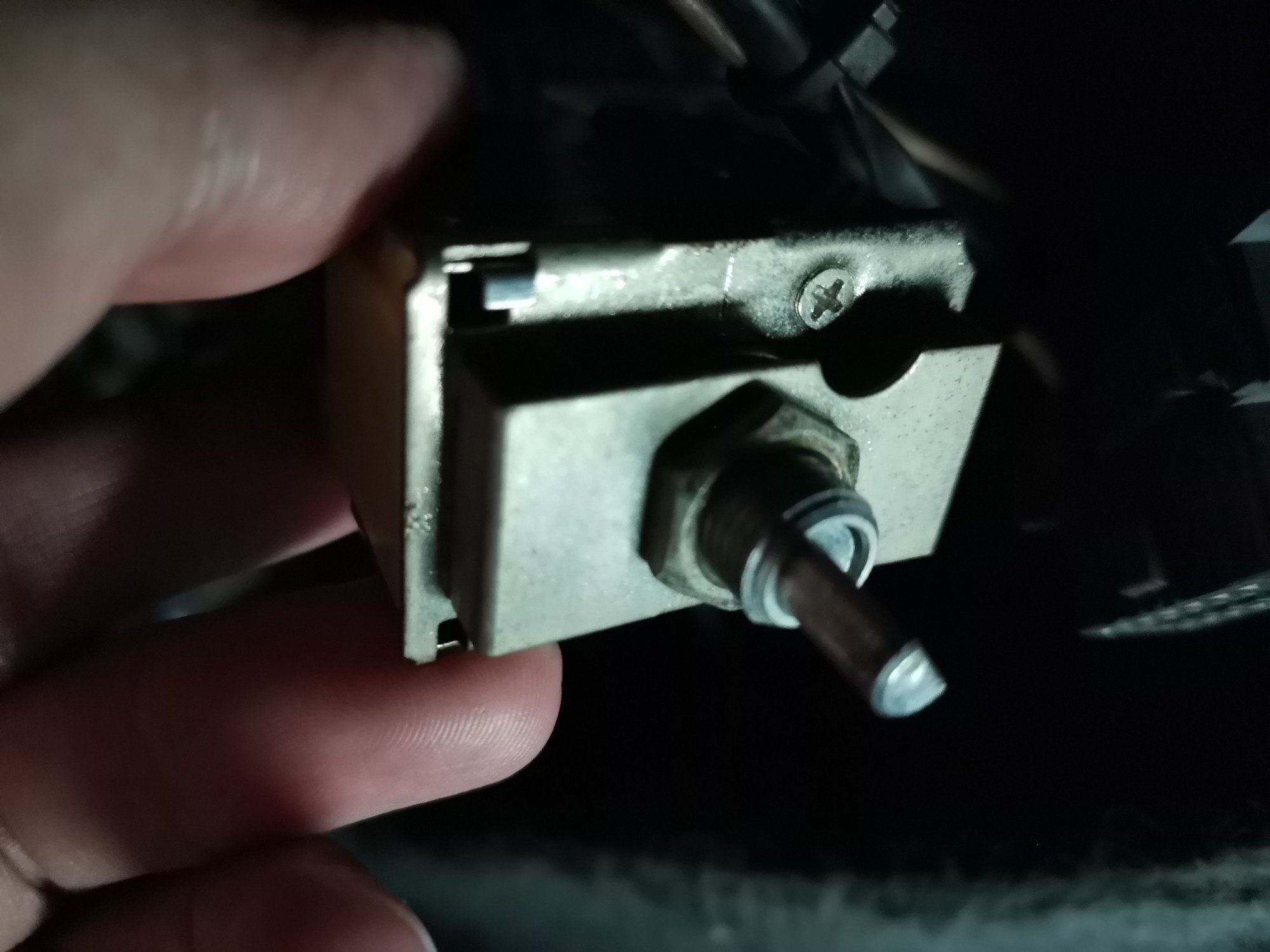

Going back to the main problem, when the mechanic is reaching for the OBD port under the steering wheel, he noticed this switch (and I have seen that switch before but I have not idea what it is for).
He then make a conclusion that the AC is already converted (and I have no idea what that means) and it is no longer the original AC system. He said that he's 70% sure that it is the culprit.
Do you guys have any idea what he's saying? And do you think this might solved my problem?

Is it a rheostat (turns) or an on/off toggle switch?
Looks to be wired in by a prior owner. Have you tried turning or flipping the switch to see what happens when engine is idling?
Possibly a dimmer switch for dash lights, other lights, or windshield wipers?
It's a rheostat I think. I tried to turn it slowly but nothing happens on the idle, dash and other lights and on wipers. I was told by my uncle before that it is for the AC fan if I remember it right.

I've replaced the vehicle speed sensor this morning and went for a drive. Before that, I've tried to slightly turn the rheostat switch to see if that will make a difference on the idle when the AC is on. And I noticed that it gives maybe 40-50% improvement on the idle. RPM will still drop from 800 down to 650-700 when you turn on the AC. Unlike before that, it will drop to almost 500 and the car will violently shake like it's going to stall. And I've noticed also that after slightly turning that rheostat switch, when the rad and AC fan starts to kick in, there were times that the idle is stable to 800. Kinda strange for me.
So what do you think guys?
Old Jun 7, 2020
Colin42's Avatar
Posts: 9,645
Likes: 1,283
From: Barrie, ON Canada
Rep Power: 223
Re: IACV cleaning
I don't know why someone would put that rheostat in, but if you've got it where the car is drivable and the AC works I would just leave it be
