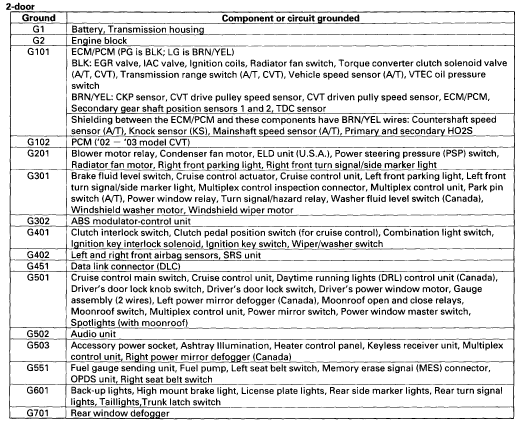

Hi to all
i need to know where is the ground wires for 01 honda civic
I think there is one near to the radiator
One under the fuse box
One under the right head light
If anyone know where is the other wires please help me
Thanks

1) battery to chassis (forward/under fuse box)
2) chassis (same point as #1) to tranny
3) chassis (upper radiator support) to engine (by upper radiator hose)
Now, if you're just looking for wherever random ground bolts are (where they grounded out various electrical components from the factory), they're all over the place. There is, indeed, one of those below the passenger headlight. There's also one under the center console. Another behind the rear trim piece in the trunk. Probably a bunch of other places I haven't looked or have forgotten. The aforementioned list is the "big 3" people upgrade.
