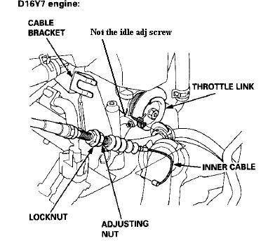

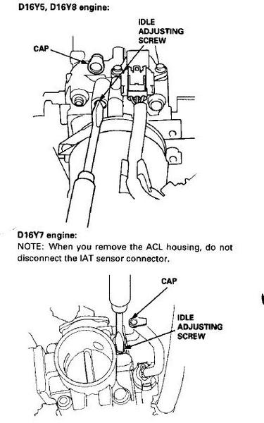

Originally Posted by Cleft_Asunder
Idle adjustment screw moves the TB butterfly NOT IAC valve mechanism.
I think you you have your screws mixed up.
If you're turning a screw on the TB and you see the throttle plate move (what you call the butterfly) then you're adjusting the wrong screw. That screw adjusts the travel of the throttle rotor and should not be adjusted.
The idle adjustment screw normally has a plastic cover on it which needs to be removed in order to access the screw. It controls the airflow through the TB via the IACV when the plate is fully closed at idle.
ID:	74683   Click image for larger version

Nope, you guys are right. Idle screw does NOT move TB butterfly, only base screw does that. Idle screw manipulates IAC air flow. The confusion was entirely my fault, since I had the preconceived idea that idle screw moves TBBF. I was seeing things.
So what now? Should I adjust butterfly using base screw to make it fully closed? What's the best way of doing that?
do you think this was the cause of my idle air control system light? I had it set up so TB was open based off the base screw. Then, I adjusted IAC idle screw to fine tune RPM.

So the way I re-adjusted it was, I totally backed off the base screw so that the butterfly bottomed out on the TB itself. Then I adjusted the screw so that it barely pushed the throttle link. The only point of the base screw that I can see is to act as a resting point for the throttle link. If it wasn't there, then the butterfly would bottom out on the aluminum TB every time, which would cause it to dent more and more, especially after peddle is released quickly. So it's a metal-to-metal contact.
Then I adjusted the IAC idle adjustment screw on the TB to 670 RPM.
