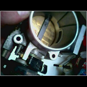

Cleaned my IACV valve and throttle body this weekend...
Some pics of before and after...
Before
After
I couldnt get it as clean as "bobsagator" did but thanks to his help I managed to get everything cleaned and smooth!
The benefit of cleaning your EGR valve is a MUCH SMOOTHER IDLE and the car even accelerates a little better. Changed my spark plugs too...

Looks good. What did you use to clean it with? Did you replace the gasket or just re-use the original?

I re used the original gaskett. (it was perfect)
and used carb cleaner to clean it.

then just tell me where the egr valve is
Old May 2, 2007
02BLKCIVIC's Avatar
Official Rattlesnake Hunter
Posts: 5,491
From: Valley Of The Sun...
Rep Power: 315
Re: Rough Idle? I Got You Covered!!!
Its to the left of the throttle body.
phisically on the throttle body heald on by three bolts
this pic shows where its monted the best...(see the oppisite side of my thumb)
thats were its mounted
any more questions let me know...
