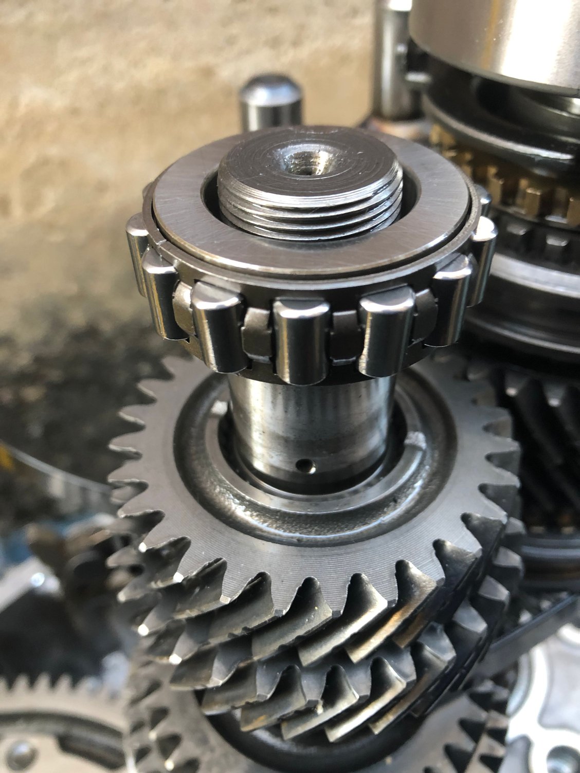

Hi Civicforum,
So I am doing a M/T rebuild because of the ISB issue, might as well rebuild the other bearing.
The first photo is the OEM bearing on both countershaft, before I take it off, needle bearing clearance has little bit millimeter gap on it on the gear.
So second photos is when I installed new countershaft and needle bearings.
My question is, did I do it right on needle bearing (the 2nd one on the latter that touches the gear so much) will it scratched on the gear, do I need to worry about it? And is there any peeler gauge measurement when doing this?
Cheers!
Elfred

Re: Installing countershaft & needle bearing; Did I do it right?
That bearing you mentioned earlier you said rubbed against the gear (" will it scratched on the gear, do I need to worry about it? "), it should not do that.
(fails a very basic rule of thumb: "is there enough clearance?") The race must be far enough away to not rub as the gear spins
But You needed to be using a real service manual anyway, hope that helped
I could not tell if maybe something got assembled upside down (a very real possibility) but that might be enough to cause a clearance issue like that
Ok Im not sure if I did it upside down, I might pull it gently, and re-install it again...
but using bearing puller will make this new installed bearing garbage,
I am thingking by pulling it to the shaft, I might drop the shaft to the ground upside down,
so only inner race on both CS bearing and needle bearing will move fair enough equally out
from the counter shaft to avoid bearing deformity.
Elfred

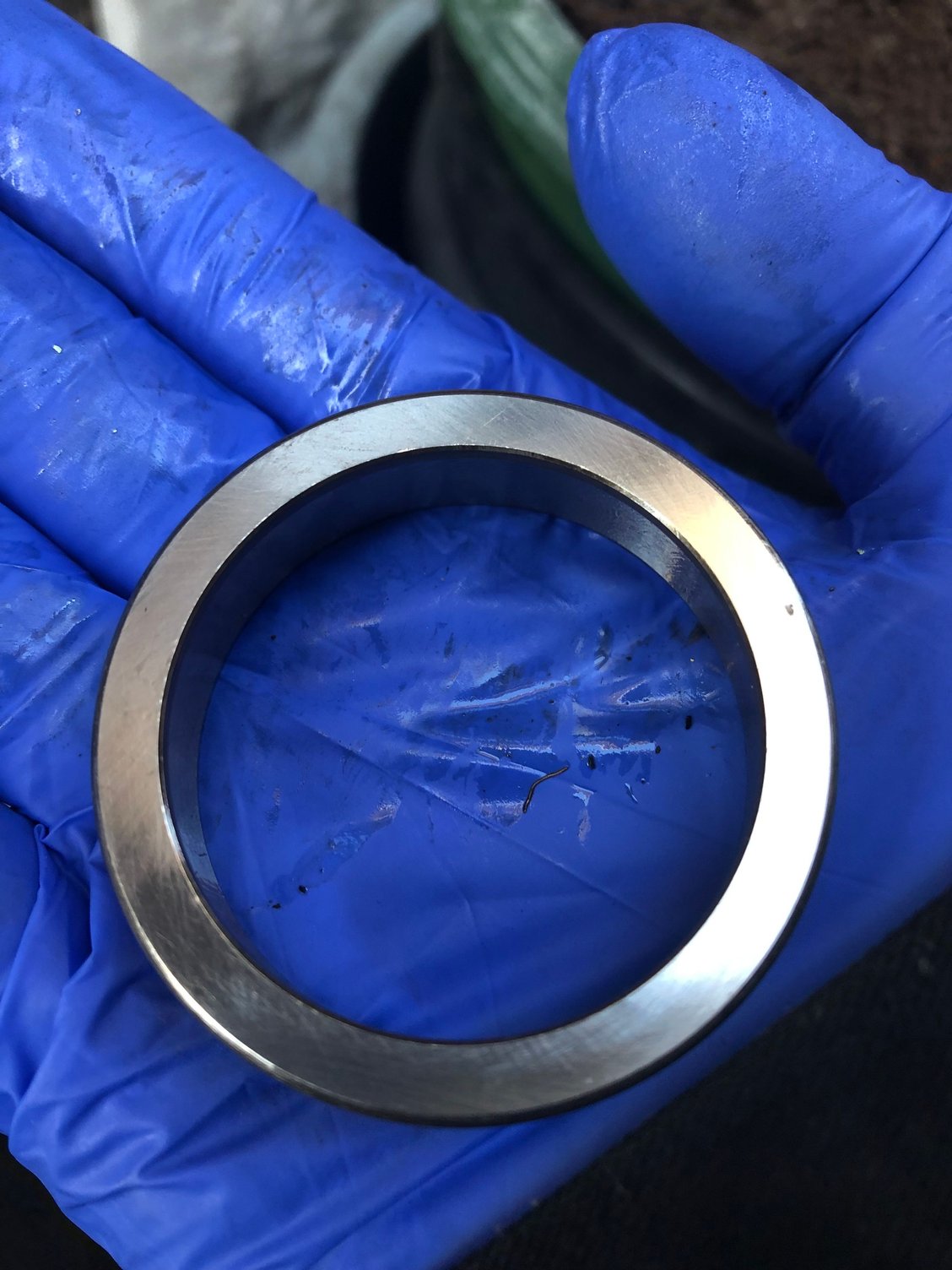

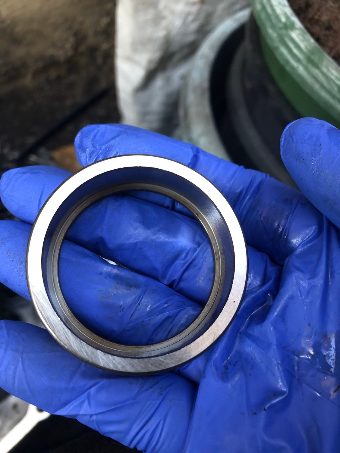

The inner needle bearing has a clearance, the only worries me is the casing of the inner bearing the one that rubs on the top latter of the splined fixed gear.
photos here as disassembled before installing.
