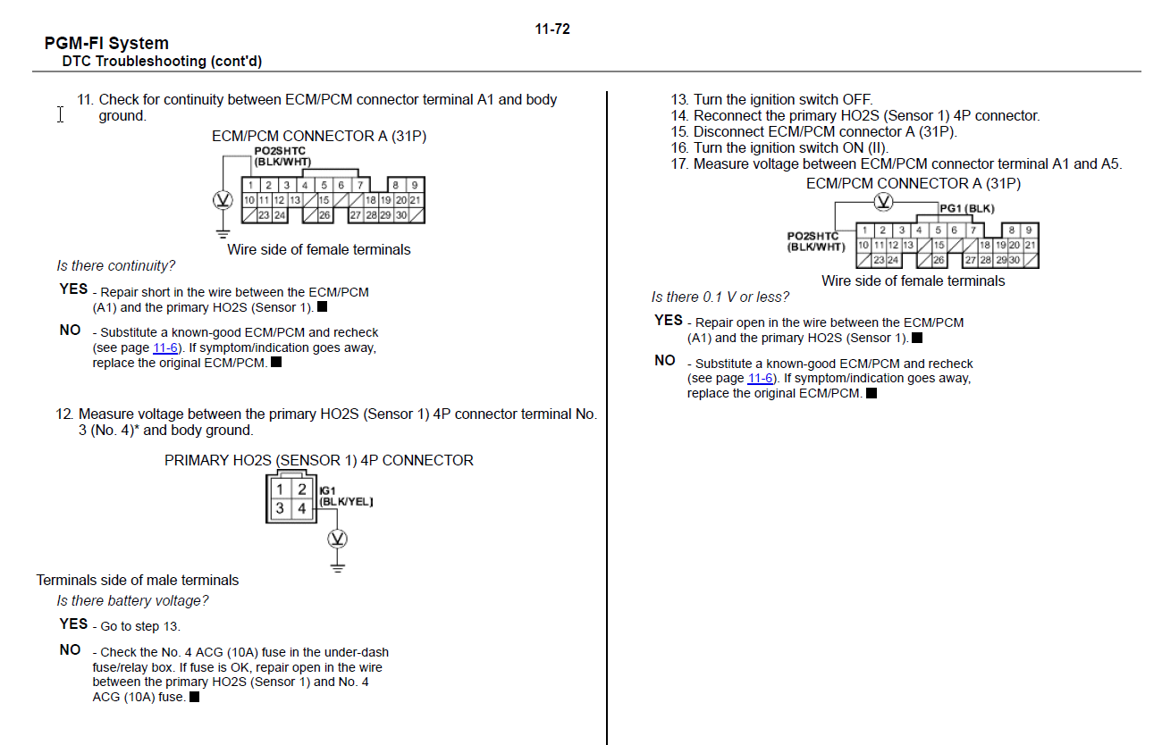

yes first thing i cannot locate the black/white ecm ground 02 senser wire that suppose to be on A 31 connecter puin# 1
is this connector/ plug on the ecm or aside from ecm
also i wonder where does this black /white wire start till it connects the other end to the up stream primary 02 senser
i would like to test continuity END TO END to determine if the wire is bad or ?

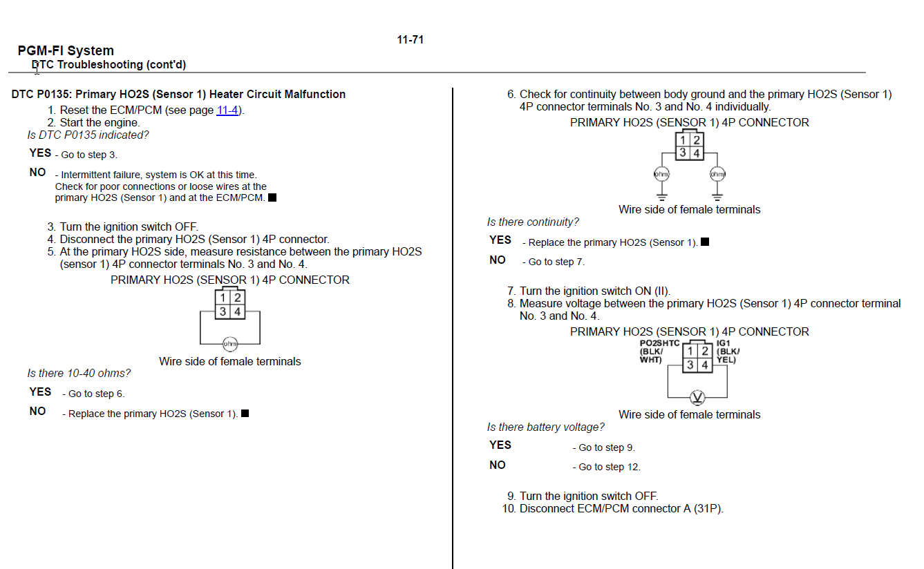

many thanks this instruction are awesome
