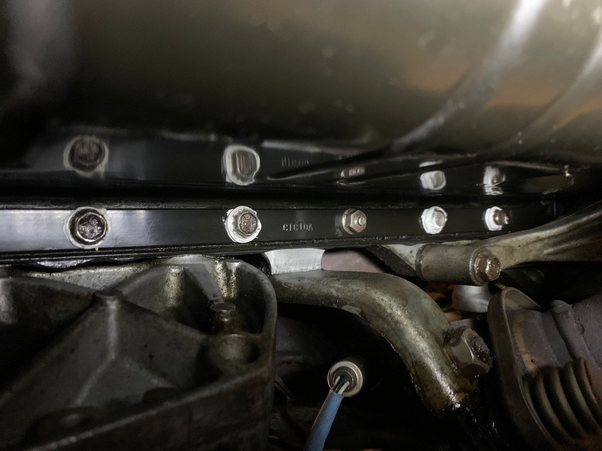

Caught a whiff of the oil burning today...***sigh***...sure enough, oil pooling on the bolts. The bolt with Hondabond (#1, counting from the left of the photo) was dry. The middle two bolts (#2 & 4) were wet, while the center nut (#3) also looked dry. #4 sets right above the exhaust pipe. I pulled out bolts 2, 4, and 5, cleaned them along with the pan edge. The bottom of each bolt was coated with Hondabond and reinstalled to 105 in-lbs. The threads on bolts 2 & 4 were very wet with oil - so strange with a brand new OEM gasket!

100% certain I got all of those spacers from prior gaskets off from both studs (where the spacer most often stick and stay behind) and the bolts (not usually found here, but can occur on the block or the pan). The leaks occurred on the bolts where there are only holes in the motor side. None of the studs are leaking.
I crawled under the car today with my light and took a look to see what this week brings. Knock on wood, it was still perfectly dry! The Hondabond seems to be doing the trick for those 4 bolts. Pondering if the reinforcement bar on the pan is not mating well with the bolts - could be bent or deformed from prior over-tightening. A new pan would solve this since it is part of the pan. If it stays dry, I will leave it alone and call it done for now.

I am finally feeling more confident about this. Zero signs of oil since adding the Hondabond to the bolts. Marking this one as closed. Knock on wood that I won't need to remove the oil pan again.

Six-month mark since using Hondabond on those four select front oil pan bolts. Approaching 167k miles and the garage floor is clean and dry, Hoping to get well past the 200k mile mark with this car.
