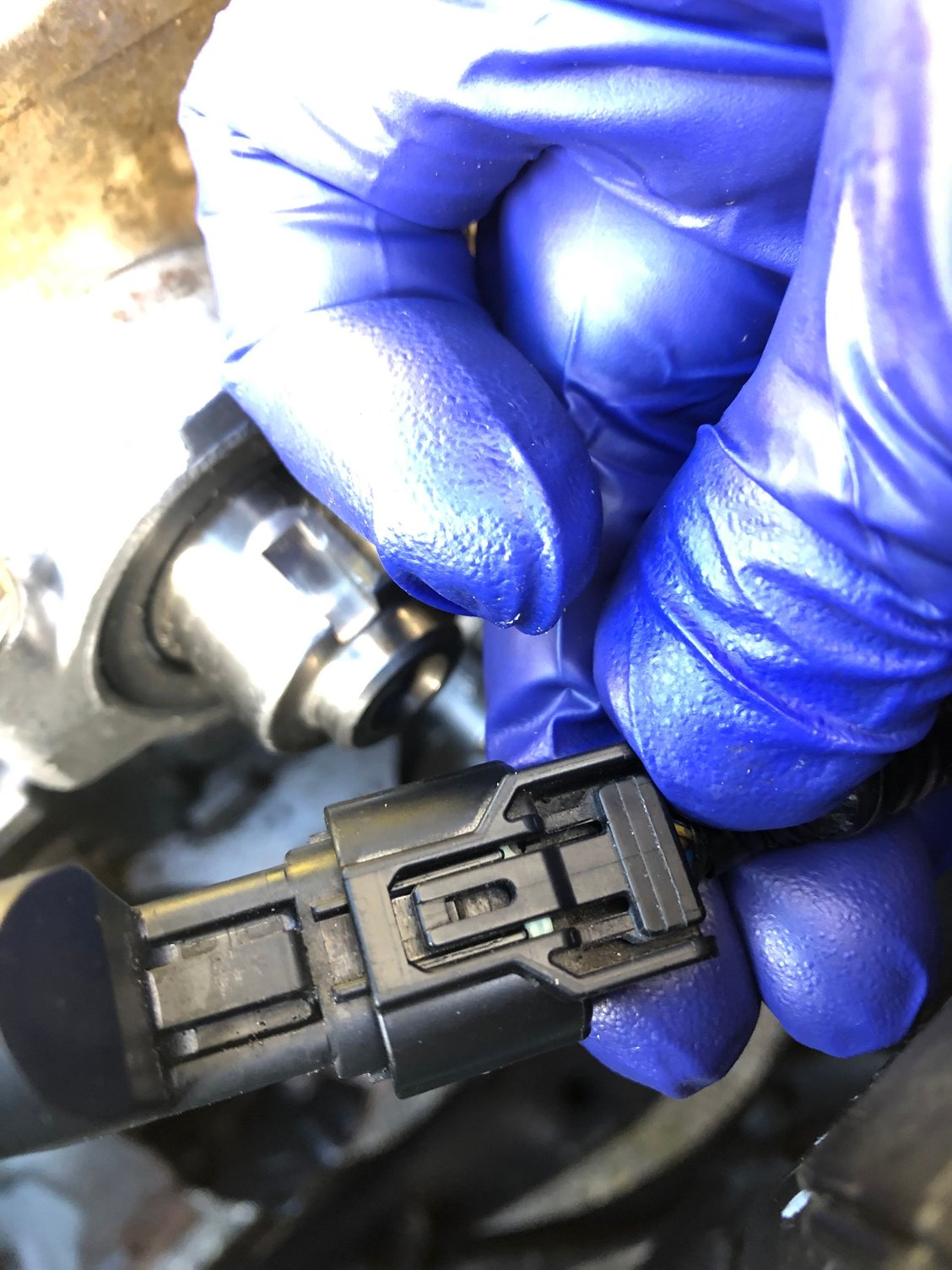

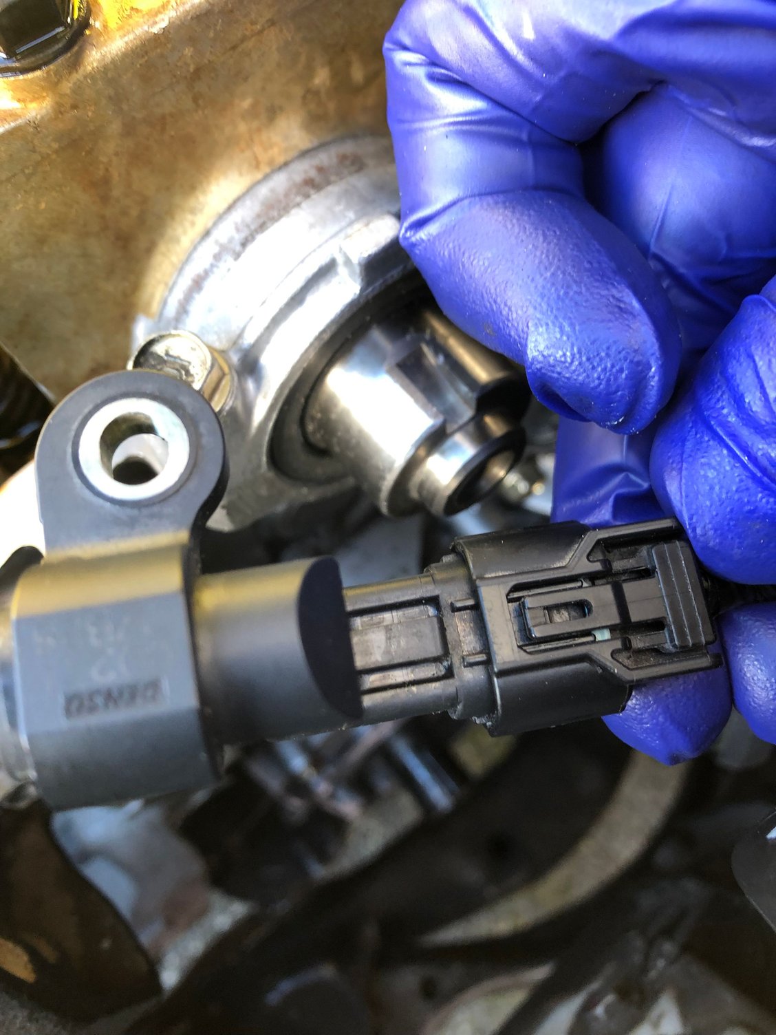

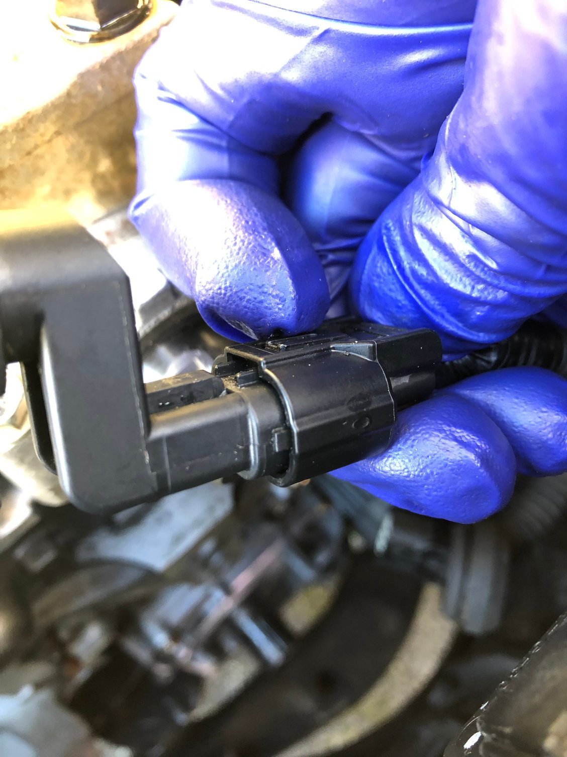

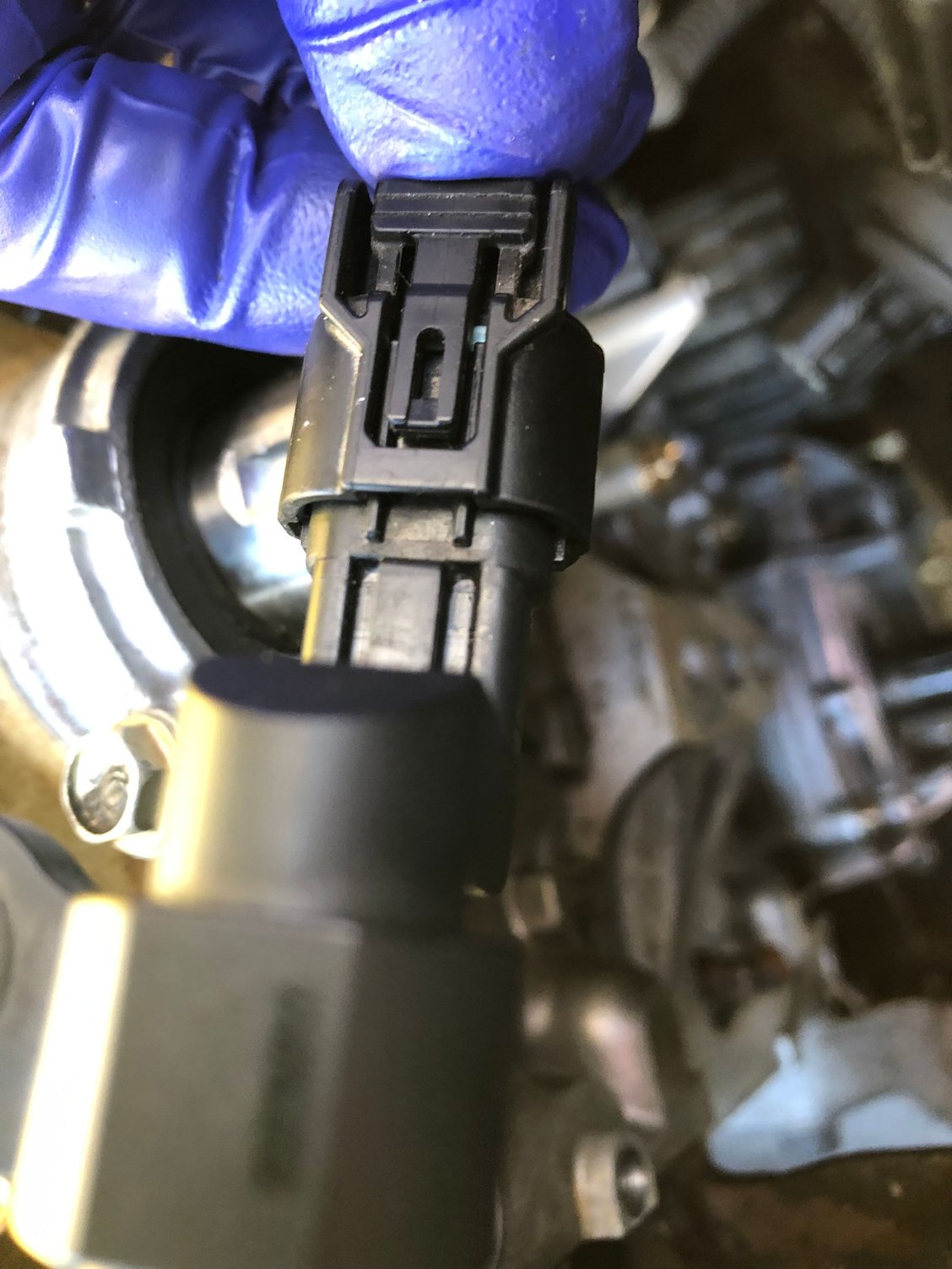

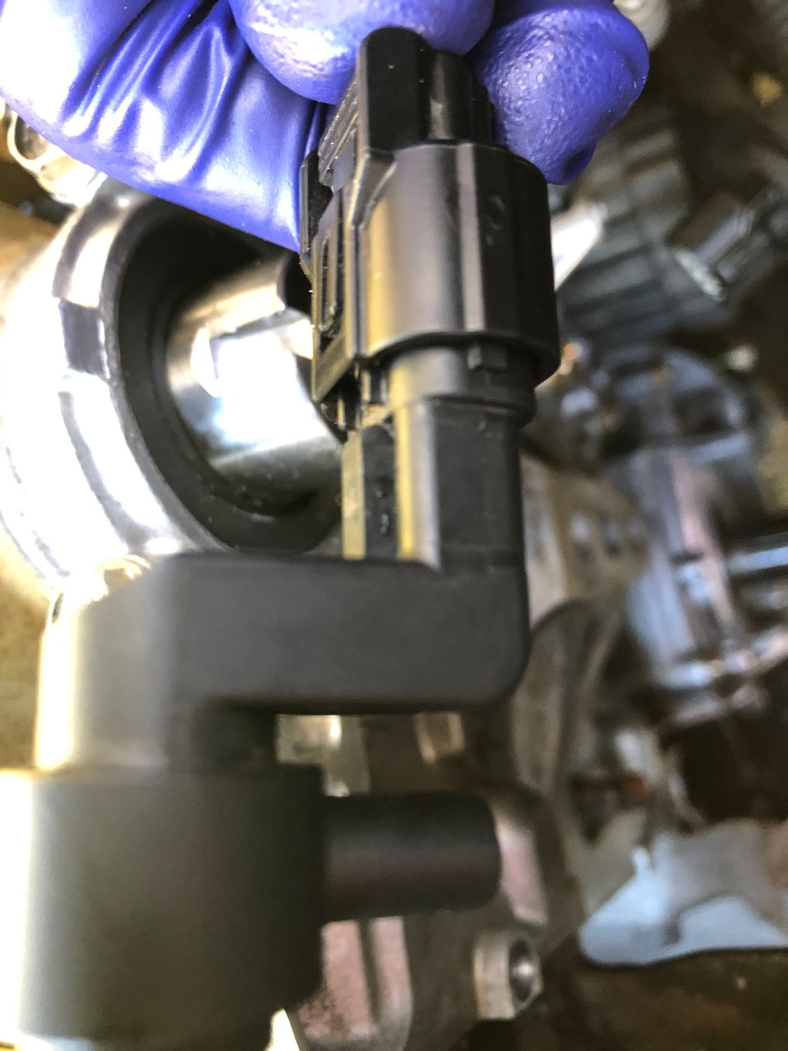

So I did my timing belt replacement on my 2001 Acura EL 1.7,
I forgot that I should just unbolt it, instead I disconnect it from the harness, my bad, and ehen I sm trying to reconnect it wont go all the way, is it just me that thinking too much about connecting all the way the CKP sensor to wire harness, or is it reaaly loose, it is snug already, scared to push and force it all the way, I might damage anything, plastic or the pin connector or bend all the way.
Below pics, need advice on this thanks.
Does it really ended up hear almost halfway connected or must all the way?
Camshaft Position Sensor goes all the way dmoothly.
Only this Crankshaft wont go flyshed to the connector wire harness.
Pkease need advice on this thanks in advance!!!
Cheers!!!

What's keeping it from fully seating?

Hello yeah thanks got it the mint color rubber grommet on the inside obstruct it, but make a way by doing it carefully, wiggle it, and now it is okey, I hear the click now.
