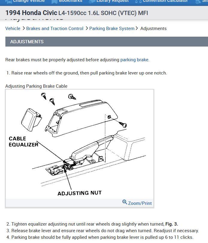

Howdy everyone! I recently bought a 1994 hatchback civic DX from a friend of mine. The car was converted to rear disc brakes before my friend got it (also a b18 swap, for some side info), and he did mention something about the parking brake, but wasn't too specific.The car sat in his driveway for about 6 months before I got it (although ever since we gave it a quick jump and started it there, it has had no problem starting and runs perfect). Anyway, I am looking to register it fairly soon, and I wanted to just do an overall check on the car and make sure everything was good to go and will pass inspection. Unfortunately the parking brake does not stop the wheels at all, and I even tried tightening the cables behind the brake lever and made it so it takes a lot of strength to pull it up. Both wheels spin exactly the same as they normally do when I spin them by hand with the car jacked, literally nothing changes with the lever pulled up. I want to buy both new cables and put them in myself, but I'm confused as to what exact model brake cables I need considering it was a rear disc conversion. Also confused as to which site to buy them from if I can find out the right ones to look for. I usually have been looking for most car stuff on

I did think maybe the cables are good, but something in the calipers or rotors weren't engaging just for the parking brake. I just thought cables because the main pedal brake system in the car seems to function the way it's supposed to. The cable lines all look like they are good from the outside, so I thought maybe stretched cables or something. I'll go out and try to remove the calipers and inspect it, and probably take pics.
