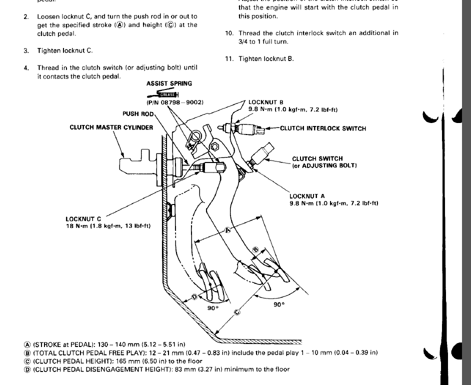

my service manual says 12mm is normal ok i rule that out..

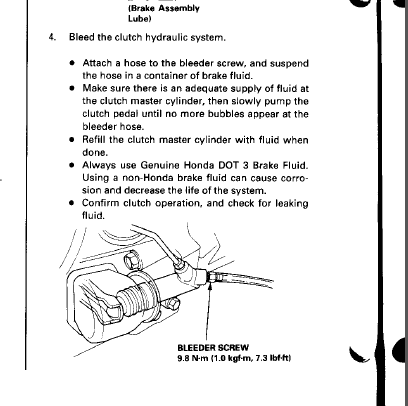

ok im gonna do the official honda way and bleed slowly into bottle of brake fluid until bubbles stop coming out....im doing this myself so ill just do it until i use up a whole bottle of 32 oz brake fluid.....
The second half of line B in that picture says 1-10mm. I'm pretty sure that's supposed to be the free play with no resistance....... and the 12-21mm is travel to make the TO bearing contact the pressure plate (slight resistance.......when it all works correctly).
IDK...Kinda not exactly crystal clear here in the manual.
Going by the look of your video, I think your free play looks a bit too much.

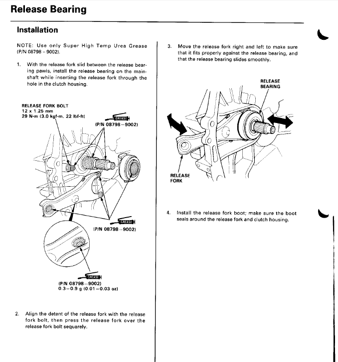

Do you think it has something to do with my release bearing? Do you think I can get to it without having to remove my tranny (get to it via going under my vehicle)

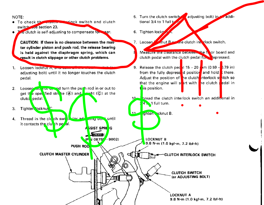

Bing-Bong I Thiiink I found My answer!!

Re: 97 civic Ex won't pop into gear
Not yet.
I don't know enough about the problems yet to say anything more than already said.
Nope. Trans has to be removed in order to access any clutch related parts.
A sane person wouldn't want to pull the trans out unless they are pretty damn sure it really needs to be done.
No, you have free play. According to you.
