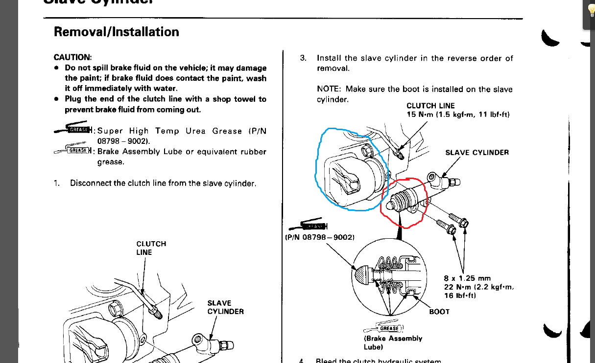

are you talking about this part (highlighted in red) i think its stuck inside the black rubber housing (highlighted in blue)...do i have to take it apart, etc..i need 411 before i tear into it

Old Sep 13, 2017
Rep Power: 518
Re: 97 civic Ex won't pop into gear
I guess it depends on if you can move the larger rubber cover out of the way easily.
My thinking is this: IF the boot has filled with fluid, if there is enough fluid pressure it can cause the pedal action to change (because that pressure causes the slaves piston to be pushed in when it should not), lowering the engagement point to the point it doesn't completely disengage.
Simply pulling the boot back to let built up fluid escape might get it to act right again, at least temporarily.
And it proves where all that fluid went the last time you had to refill it.
This actually happened on my truck several years ago (mysterious low pedal) , and rather than replace the slave cylinder that seeps I opted to cut a small slit in the boot to let the seepage escape. I have to top off the master cylinder about once every 3 years lol

Ok I measure w w ruler and it is CONFIRMED half an inch of free play or 12mm
here is a vid of my slave piston working
https://youtu.be/8ameaGKbz24
Old Sep 14, 2017
eager2learn's Avatar
Joined: Jan 2016
Posts: 159
eager2learn is an unknown quantity at this point
hi okay im back
i bled my clutch using this method
https://www.hondaaccordforum.com/for...-clutch-42465/
including pushin my push rod and idk it seems like my clutch feels a lot worse
also when i push the clutch pedal the fork arm moves all the way to the left wall
i caught a vid of my clutch pedel free-play and clutch arm movement AFTER i bled the clutch using this method: https://www.hondaaccordforum.com/for...-clutch-42465/
video here:
needless to say this did NOT work i want 2 die
