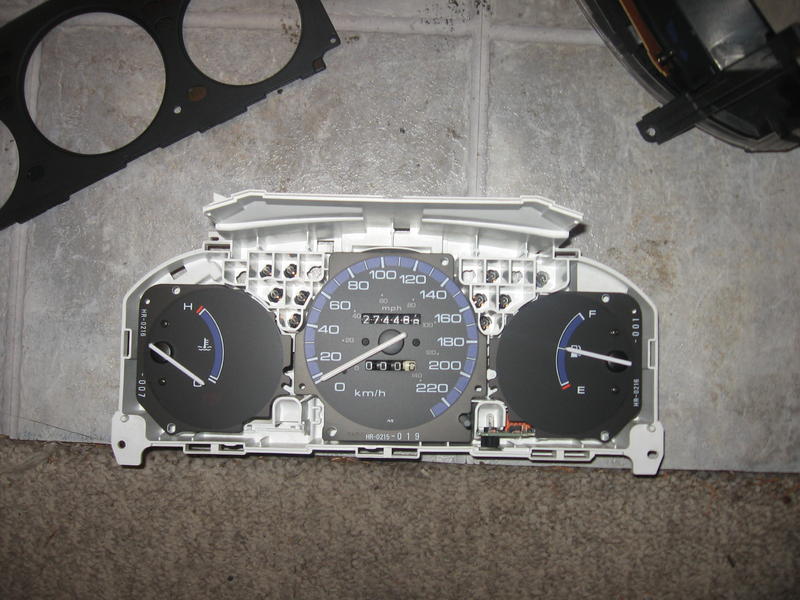

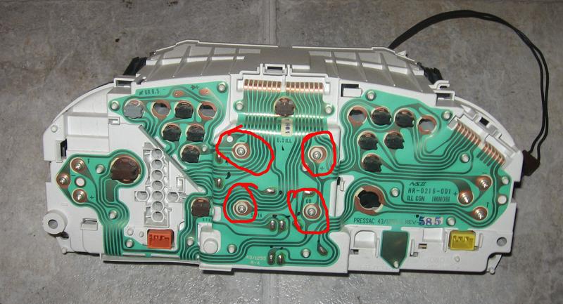

Actually the easiest thing to do on the 6 gen is just unscrew that 4 screws on the back of the speedo and swap it into your new cluster. If anyone ever asks anything just pretend to be dumb as a sack of hammers.
Since I can't see one here and probably won't ever again, I'll ask: Does that just transfer the odometer by itself or does that swap the speedo circuit board with it? Asking because the "intermittent speedo" problem is usually on the board.
Not the cluster printed circuit, I mean the board on the speedo itself.

Re: gauge cluster light question
The whole speedo just pops out as a unit. I did it to mine over 2 years ago now
OH you meant the entire speedo head, not the odometer alone.
