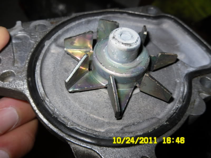

Leak's already diagnosed, and yes it is the water pump seal along with the lower radiator hose and clamp. As for the oil leak, the o-ring in the oil pump was the culprit.
Anyhow, as for the A/C screeching noise I recall over tightening the adjuster pulley and loosened the bolt a couple turns and the screeching noise went away when I turned on the A/C.
Final Conclusion:
If you're ever going to replace a part that has fluid (coolant/oil) behind it always buy OEM. Back when I did the whole timing belt/WP/drive belts/etc. change I bought a kit from Amazon cuz that was the most inexpensive kit I could find. Here's the original thread. At the time I thought I was saving tons of money but in the end it cost me more in down time by having to drive my truck which cost $100 a week in gas and buying replacement parts.
When I swapped the WP I kept the OEM and I'm glad I did cuz that's what's in there now and so far no leaks. I truly believe the design of the aftermarket WP caused the seal to go bad. The width of the groove where the o-ring seats is so small the o-ring sits on top rather than in the groove like shown for the OEM below:
OEM water pumps from what I've read on this forum and others rarely go bad. However, if you want to replace the water pump make darn sure it's bad before having to spend all that money on a new one.
