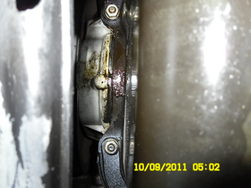

Anyhow, I'm hoping you guys can help me out again like you've always have. Yesterday I noticed a palm size of oil but as I looked closer I noticed a some green substance along with the tiny puddle. Great! It's coolant. Hoping it's not from my car (I had a few guests over at my place) I moved my car to another spot. Check it just now (6:15pm) and noticed a drip of oil on the ground. I jacked up the car and looked underneath and saw this on the left side of the oil pan where the water pump is: You can't really see it but there is definitely coolant present where the oil residue is along the water pump cover.
So, here's my question: What could possibly be causing the oil leak? And is the coolant present with the oil a sign of a broken rod? Sorry for the dumb questions. Would this be an easy fix?
TIA guys.

Most likely a bad headgasket with both oil and coolant present. Or you have an oil leak (most likely a gasket) and a bad waterpump. Any overheating?

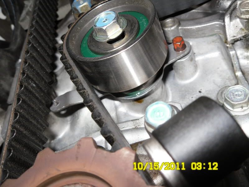

Okay, so I spent all day yesterday tearing down the lower portion and doing a thorough inspection to locate the root of the leak (oil & coolant) and here is what I discovered:

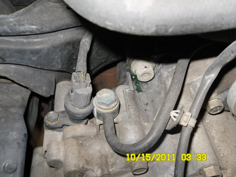

Here is where I noticed the coolant and oil leak...of course, at the time it had the lower timing belt cover (see initial post w/pic).
Coolant by the tensioner? And not by the water pump...weird.

More coolant by the sensor but probably residual from pic# 2

Then saw this coolant drip forming...why there? See pic below of what the actual part is. What is that?
Now, thinking the seal going bad on the oil pan/container/wateva you call was the root of the oil leak I saw this little sucker. What is this thing? Btw, the oil filter is not leaking:
I'm stumped as to what I should do? I'm thinking of replacing the water pump (again) and replacing the oil pan seal/gasket but that doesn't explain the oil drip in the last pic and the coolant drip 2nd to last pic.
So, looking at the pics what would you say is causing the leak (oil & coolant)?

Okay, I just took another look and found the root of the coolant leak in pic # 5 in post #8...and here it is:
But that still doesn't explain the coolant by the tensioner.

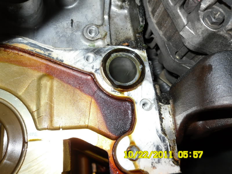

So, I got the oil pan off and saw oil was indeed leaking from the cam seal. The manual says you can remove the cam seal without taking out the oil pump. Yeah, right! Hell no you can't. That thing is sealed in there. I tried cutting the thing with an exacto knife and it's a no go.
At this point, I have no choice but to remove the oil pump and again the service manual makes it sound like all you have to do is unscrew the bolts holding the oil pump (which I did) and no way that thing's coming off. For starters, it's sealed in there tight and even if I was able to pry it loose you it won't come off completely because you have to slide it off the crankshaft rod (lack of a better term) where the pulley bolt screws into. But you can't unless you remove the bottom torque mount and pry lose the AC so you have enough room the slide the oil pump off the crankshaft rod.
I was this close to giving it and just taking it to the dealer but then I've come so far and really want to get this done.
On another note, when I poked the cam seal I noticed coolant mixed in with oil. What could this mean? I really hope my head gasket isn't warped/leaking. If it is I'm calling my mechanic to perform the job.

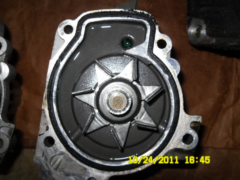

Update:
After taking off the lower engine mount off (a.k.a. rear engine stiffener & front mount bracket) I was able to finally get the oil pump off. Removing the lower engine torque mount is a MUST if you want to remove the oil pump. Well, that is for 1998 LX automatics. Fearing the engine would drop if I removed the lower torque mount I used my jack & a block of wood under the oil pan to support the engine from falling but later found out the upper engine torque mount was enough to support the engine.
Here is what I discovered: Matt_75 (see post #16) was correct in saying the oil leak that I was experiencing was due to the o-ring.

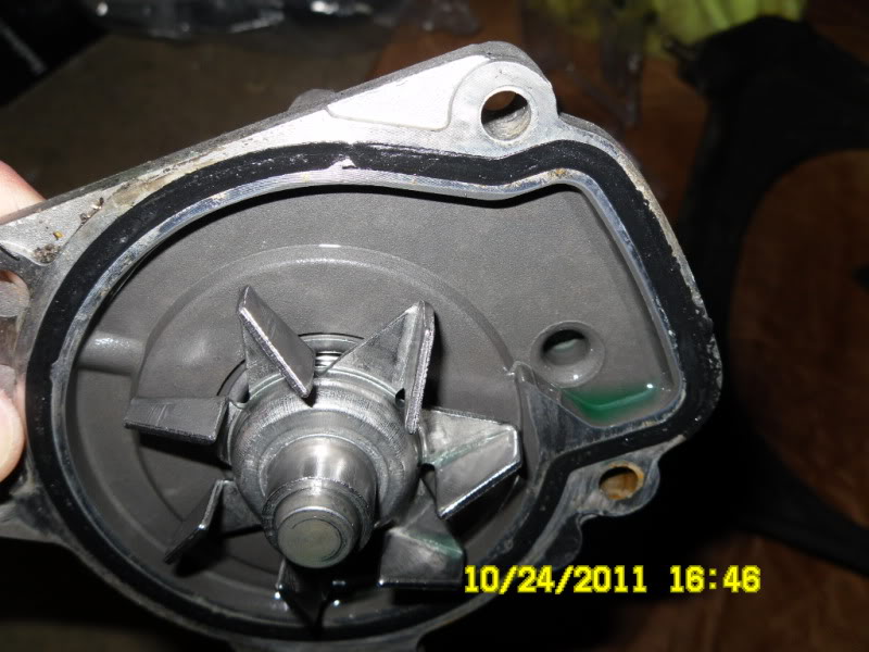

And I believe I've found the answer (see pic below): I noticed a tiny trace of coolant residue all along the edge of the water pump and when I removed the water pump I saw that the o-ring was flush and flat like paper. I've never seen anything like this in all my years of removing parts on a car or motorcycle, or even any household appliances. So, I'm gonna make an educated guess that the o-ring has gone bad. Comparing it to the original water pump o-ring (yes, I still kept it and boy am I glad I did) the o-ring should somewhat protrude out so when you install the water pump the o-ring creates a seal between the two matting surfaces. In this case the o-ring was so flat & flushed coolant was sipping through.

COMPARISON: Original water pump on the left
Now that I've discovered the origin of the problem I can put everything back together. Here is what I'm replacing:
Water Pump O-Ring (use OEM): Mine came with the aftermarket water pump I ordered which sucks
