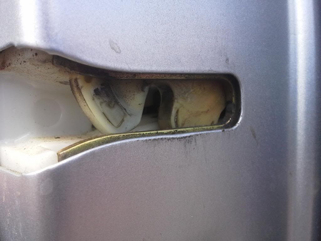

Since the keys still lock/unlock the doors, the lock assembly is ok at least.
First you find your door latch...
Using your fingernail, rotate it down and to the outside...
Until it looks like this.
Then depress this button and try your locks at the same time.
If it's a door sensor (as opposed to a lock issue) then the car will still think the door is ajar and the locks won't work.
Note that the passenger lock is slaved off the driver's side, so if only one side is bad it won't operate unless the driver's side is already in the desired position; i.e. the driver's side must be locked in order for the passenger side to lock.
***Remember to reset the door latch by operating the door handle with the door unlocked. Otherwise, you won't be able to shut your door!***

Thanks for the explanation, and for the pictures, made it a lot easier (english is not my native language so i don't understand all technical terms ... )
I tried that and the doors didn't lock, neither of them.
In your note you said that the passenger door will not lock unless the driver door is locked, if i manually lock the driver door (key or ****) the passenger door still doesn't lock.
So the problem is either the actuator for both of them not working only for locking (highly improbable bun not impossible) or is something common for both, a circuit or open doors detection.
