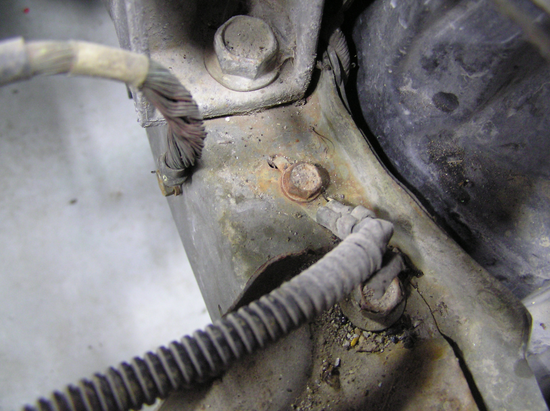

and everything suddenly powered off
If the battery, cables and cable ends are really making good contact and not dropping out, I bet you have a
Bad ground connection where the neg cable attaches to the body:
Disassemble, clean everything with a wire brush or sandpaper until there is clean shiny metal on all contact points (bolt, cable eyelet, and body), then cover liberally with dielectric silicone grease to protect it all.

Golnat - yeah it seems like that... but I don't understand how it suddenly rattled itself tight again when no one touched the car. It's kinda baffling. I'm going to look at your suggestions though.
Ezone - I looked at the ground from the from the battery... it seemed a little rusty, but still tight. I'll disconnect, clean, and lube it as you suggested. Is the other cable pictured (top cable that's bolted on the side) grounding the engine?

Re: 06 Civic EX Not Starting - Any Suggestions
Correct. It attaches to the body and trans.
