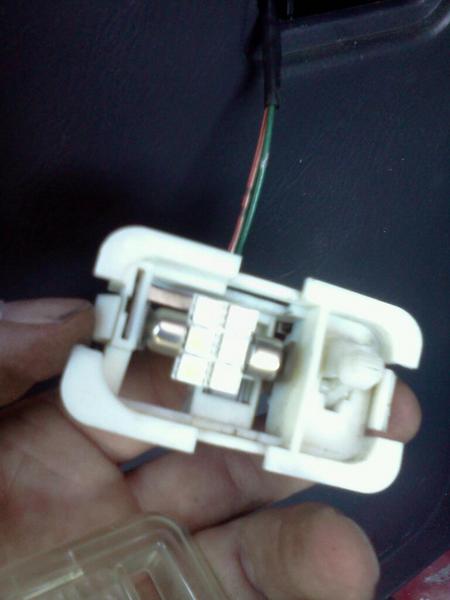

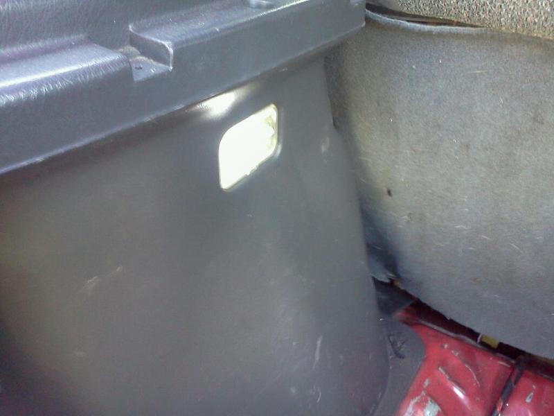

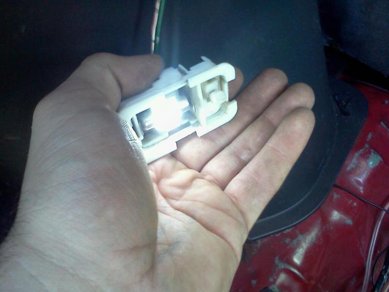

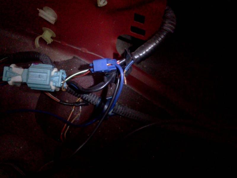

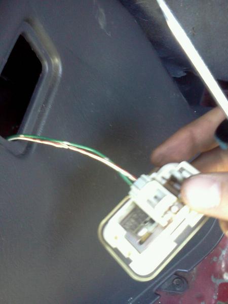

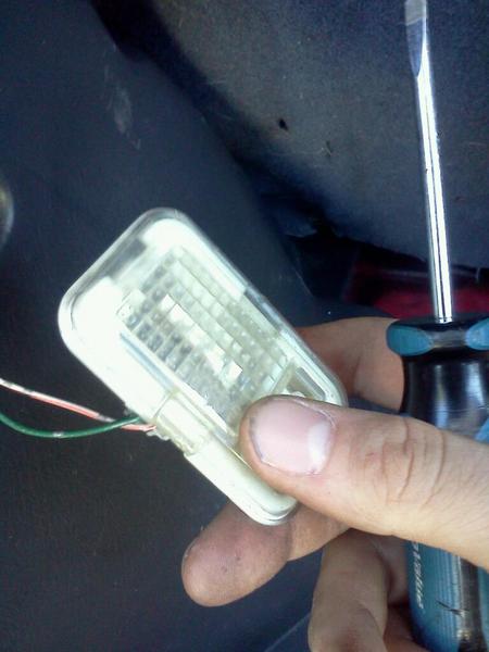

i know im the odd man out here having a 6th gen and all but it IS an LED thread to so what the hell. Not meaning to thread jack here either
My hatchback didnt come with a trunk light which, I don't have to tell yell is a royal pain in the *****. So I wanted to put one in and I have an infatuation with LEDs so why the hell not put one in?
I snagged a trunk light from an eg hatchback and I ordered a cool white SMD LED on eBay.
I wired the power to the positive terminal on my amplifier since its hot in.
I grounded the light to the trunk release indicator, its the blue with black wire on the passenger side of the car, underneath the rear speaker. In the sixth gen anyway...
popped it in place.
Voila, ill snag a pic tonight.

nice trunk light install. how did you have the right size hole already there? or was it just covered with a cap for your model.

^ im sure there was a cap there at one point but when i bought the car it was just a hole. I doubt honda would have left it like that brand new, i think it had popped out and the jack *** retard I bought the car from just left it like that. thankfully the eg hatch uses the same exact housing
