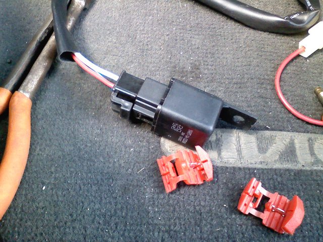

Hey guys, I have a few questions about the wiring for my ebay fog lights. The relay is connected as so:

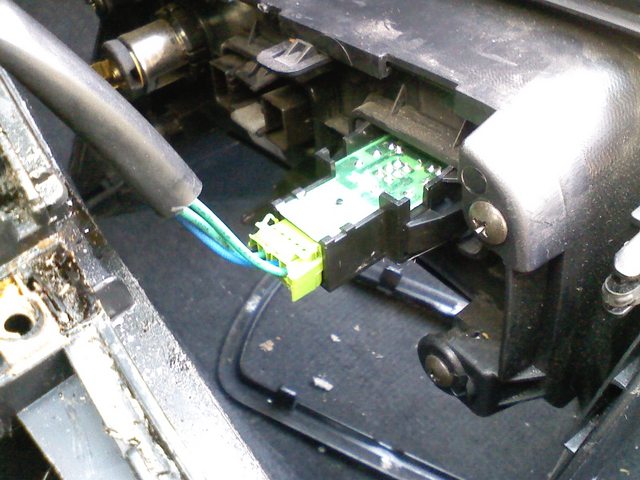

So that's set. The switch is connected correctly as shown here:

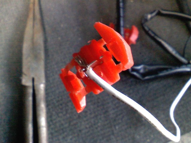

My questions start here. The green wire comes from the switch and then ends like this, with the red piece beng the snap connector it came in:

I can only assume this is how the wires go:
White to fused power to power the relay
green to fused power to power the switch
When you turn on the switch it should send power to one terminal on the relay which will let the relay senf the white power to the lights,(red wire)
You need to use a test light w/probe to check for power in and out.
