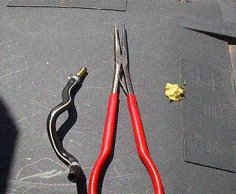

Originally Posted by fullgrown
i've used a plastic splice, and it's awsome. there's no melting. but you have to cut the ends so there's a better flow of coolant.
this is what i got. a universal vacuum connector.
Ditto. I just drove a 800 mile round trip with no problems.

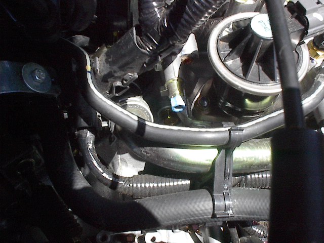

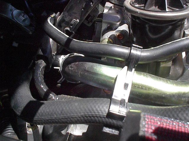

ok I got rid of the brass barb, which did in fact look like it had a bit of corrosion on the outside of the hose. I just made it one continous hose using the longer piece. Perfect length. Kinda tricky but got the job done with some long needle nose pliers. Lost a bit of fluid too. LOL When I first seperated the two hoses nothing came out then I pulled the short tricky one off and it started spraying. LOL So I quickly slid the other hose on there and stopped it. Pulled the metal hose clip down with the pliers pinching it open and slid it into place with my fingers. Easy, just a little tricky due to being in a tight spot.
