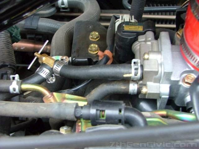

hey gearbox, i think this is another idea if your in a cold climate
Is that a 3 way valve? Cause otherwise, how would the coolant get to the next point?
Old May 13, 2005
  #157
suthrninca's Avatar
Posts: 304
From: Quahog
suthrninca is an unknown quantity at this point
That's my pic. Yep, it is a 3 way. Bought it at Lowe's.
