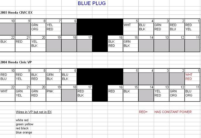

i need some help. i bought a 2004 civix dx. the previous owner said the instrument cluster went bad and he replaced it .i said cool how many miles etc.125000 ok. i asked if i could the old cluster with the car. here were i get confused the one he gave me the old one has a rpm gauge and is different the then the one thats in it. so i buy a used one like he gave me .plug but no play. my question is did any dx 2004 come with a instrument cluster with a tach. if not how can i make it work
Old Mar 5, 2012
  #402
Re: 01-02 to 03-05 Gauge Cluster Swap: DONE! Pics inside w/ Pin removing FAQ & Video
01-05 civic dx/vp only came with basic clusters (no tach), but the 01-02 lx/ex clusters with tach should be a direct swap just plug it in. the 03-05 lx/ex fancy led clusters (red or blue rings) need rewiring and this is what the thread here is about to repin the connectors to a new config.
Old Mar 7, 2012
  #403
tony nmn's Avatar
Joined: Mar 2012
Posts: 2
tony nmn is an unknown quantity at this point
thanks is there any way you could send me a print of what i have know with the green and blue plug and what it needs to be converted to green and blue plug. i know this is asking alot but i would appreciate it alot. if you want to email it to me at tony939500@charter.net that would be great and thanks for your time and knowledge
Old Mar 7, 2012
  #404
everything you need should be in this thread, including the two conversion diagrams. here they are again tho
https://www.civicforums.com/forums/1...ml#post4174905
The answer was posted earlier in this thread, but there's the link again. Red/White goes to fuse #9 under the hood...find what that fuse controls, and you have your answer.
^ OPDS unit for side-airbag (in the seat). and i think only the EX had the "side-srs" indicator light on the cluster.

I did an 02 EX coupe to 05 EX coupe cluster swap. I have side airbags but the new cluster doesn't. My original cluster was very boring and found a nicer 02 cluster that matched in mileage so I swapped that in two years ago. That cluster did not have side srs either.
So my post is because with the new cluster swap, the SRS is lit. I assumed because the donor car had a head on collision. So I did the SRS reset (took me 4 times but got it.) Started the car this morning, no light. Drove 0.1 miles and it came back on. 4 restarts - still on.
After work I checked the main SRS fuse under the dash but it is good. I have not checked the side srs fuse but since it is not the one feeding the light I skipped it for now.
Since the cluster was the variable, I posted here first. I bought green and blue clips and did a pin by pin swap. I did not pull the battery cable but I was very careful. Nothing is blown or else is effected. Any ideas?
TIA
