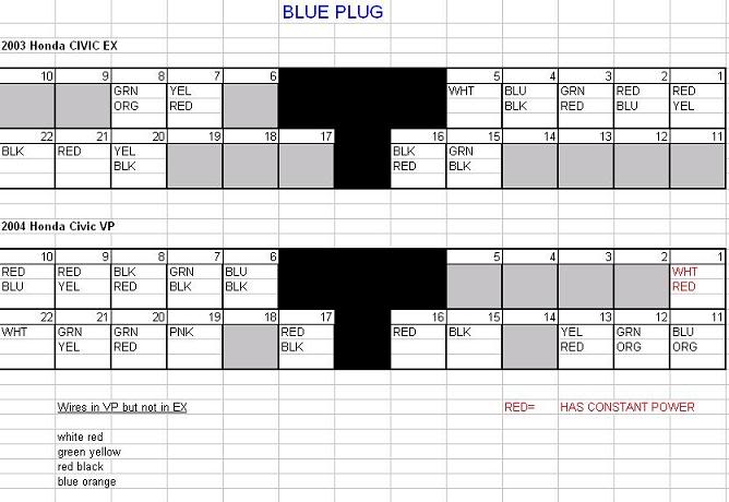

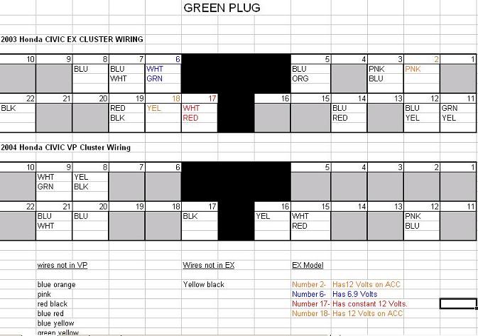

with regards to splicing the yellow black wire from the green into the blue. which red white wire is used? the one originally from the green connector or the blue? and what happens to this wire after it is cut?
accoring to the diagram:
there appears to be 2 x white red wires; one from green [15] connector and blue [1] connector.
and both are later plugged into green-17. is that right? or one is not used at all and if so which one.
according to taz757
http://cluster.dirtysamurai.com/
he mentions :
What I did was clip off the extra white/red wire, since it was long, and then spliced it into the yellow/black wire. That way it'll reach over there. Remind them that if they do that, they need to cap off the white/red since it's a 12v constant wire.
in other words,
the diagrams also show a white red wire in position Blue1 and position Green15 in the VP diagrams but only once in the EX diagrams at position Green17, so which wire goes to Green 17? Do you twist them together?
could anyone clarify this ? thank you.

for the two white/red wires if anyone else has that question, they are the same thing. you only need to pick one to move to green 17 spot. they both come from the same place.

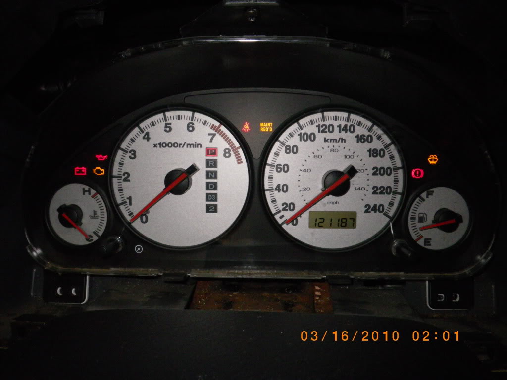

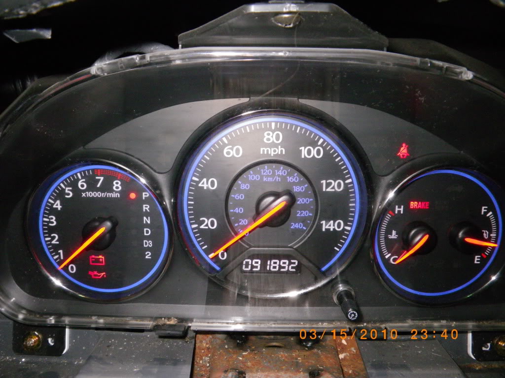

Have 2003 Civic (4 door Sdn) auto trans from the US (I think it’s an LX)
Okay I’m wondering if I can get a hand.
I did the cluster swap on our Civic not so much to have cool looking new gauges but because we live in Canada and we had a MPH unit in the car. So we wanted to switch to a KPH unit.
I got a great deal on a setup and it came with the old wires cut but still attached, so I just followed the video tutorial on how to pop the pins out (great vid by the way I was having a terrible time figuring it out on my own).
Once all the wires were out I just put the ones in the car in the same order as the harness that came with the new gauge cluster set. However I noticed that I did not have several wires in my car. My factory harness does not have the following wires that the cut unit did have:

To help understand here is the unit I had in the car:
And this is the unit I put into the car:

try working backwards from these as these were my notes for the install from and older dx non-tach swap to the one you have but in km/h.:
red/wht (gauges and indicators)
wht/blu (headlights)
blu/red is interesting, youre not supposed to have a wire there for 03-05 dx, but 01-02 dx it shows a wire in that spot for ABS.
check the wire diagram pinouts to see where they move to. for the green connector, red/wht is number 1 on your plug and needs to be moved to number 10, still on the green plug. number 13 wht/blu stays in the same spot on the green connector! do not move it.
for the blue connector, number 18 blu/red ABS gets moved to number 14 on the GREEN plug, as the diagram shows. i think you just missed this one.
re: red green wire [again work backwards]
“ok **** i missed one RED GREEN from the BLUE Connector an idea what and where it goes?”
“i was wondering when you would ask, since its another canada-only wire (for headlights). red/grn is number 9 in the blue plug (this would have been red/yel as the diagram shows IF you had an 01-03 civic dx and not 04-05 civic dx). this wire needs to be moved to number 1 on the blue connector. your red/grn wire is the same as the red/yel wire in the diagrams, except it has a different function.”
also you know your new gauges are not LED's right? that's one of the old ones that everyone in this thread is trying to get rid of. i would just keep current one and look around for the km/h.

canada is a whole different mess to work with. you know they make that same cluster with kph right?but anyway, here are the wires.
green plug
red/wht is for the canada only 'low washer fluid' light
wht/blu is canada only for the DRL (daytime running lights) control unit
wht/red is hot power from the fuse box that controls most of the gauge meters and power circuits as well as the beeper.
blue plug
red/grn is canada only for the headlights
leftovers
red/yel is canada for headlights (replaced by red/grn on newer models)
blu/yel is cruise control
blk/red is auto trans gear indicator
now lets figure out where they go. use these diagrams...
green plug
red/wht needs to move from pin 10 to pin 1.
wht/blu does not need to move, keep in pin 13.
wht/red needs to move from pin 17 to pin 15 as shown already
blue plug
red/grn moves from pin 1 to pin 9
leftovers
red/yel is the same as red/grn. 03 canada civic used red/yel, 04 canada civic used red/grn
blu/yel moves from pin 12 to pin 19
blk/red moves from pin 16 to pin 8 (auto trans only, leave disconnected for manual)

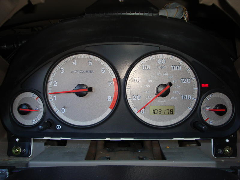

Hey guys I just swapped my 2002 coupe LX Manual trans cluster for a 2004 Coupe manual trans cluster. The 04 of course looks amazing. All went well and I ended up with the red/white wire left over as planned.
If anybody is looking for a 2002 coupe LX cluster for a manual trans (103,XXX miles)let me know. I'd be happy to sell mine for a fair price. I'll also be putting it up on ebay, I'll post a link when I do.
