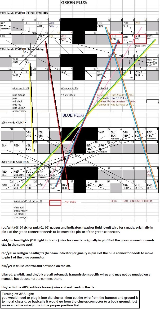

okay here are the changes if you are swapping an old style to a new style for canada: just refer to the diagrams above for the pin numbers.
red/wht (03-04 dx) or pnk (01-02) gauges and indicators (washer fluid level) wire for canada. originally in pin 1 of the green connector needs to be moved to pin 10 of the green connector.
wht/blu headlights (DRL light indicator) wire for canada. originally in pin 13 of the green connector needs stay in the same spot!
red/yel or red/grn headlights (hi beam indicator) originally in pin 9 of the blue connector needs to move to pin 1 of the blue connector.
blu/yel is cruise control and not used on the dx.
blk/red, grn/blk, and blu/blk are all automatic transmission specific wires and may not be needed on a manual, but doesnt hurt to connect them.
blu/red is the ABS (antilock brakes) wire and not used on the dx.

Man!
Thanks a lot gearbox!
I was waiting for them.
It's a shame I can' see the diagram you've been looking at, but it's still better than nothing.
This is between canadian clusters, what about canadian to us? But I don't think I would do that since I want the mileage in KM not Miles, same for speedometer.
Thanks again!

One thing, suppose I'm doing something wrong in the wiring (like not waiting for you reply and following the original diagram for US vehicle only), will it damage the electrical system if I plugged it ?
Old Oct 14, 2012
  #199
Rep Power: 812
Re: DIY cluster swap 2003 - 2004 dx also available for other models
possibly. im not sure which wires will get screwed, but i know you could blow something if you dont rewire it properly. just use the diagrams in the #181 post of this thread up above and the info i just posted. those are the only differences. if your car doesnt have abs but the new cluster has an ABS light, you may need to ground the abs wire instead of connecting to the cluster, otherwise the light will stay on.

I didn't quite get what you said about the ABS wire.
How can I ground that wire if my car doesn't have ABS?
Are there wires on the cluster itself?
I thought the cluster itself only had socket for the connectors that belong to the car wiring harness.
By "wire", are you referring to a "pin"?

i think every civic has all the wires in the harness already. so you probably have the abs wire on the connector. you would need to plug it into the cluster, then cut the wire from the harness and ground it to metal chassis. so basically it would go from the cluster/connector to a body ground. just make sure the wire pin is in the proper position first.

So this means the ABS wire is totally disconnected from the wire harness of the vehicle after you cut it and ground it?
I find it kind of weird to do that, I don't know much about electrical stuff, guess that explains it.
Old Oct 16, 2012
  #204
Rep Power: 812
i believe so. the bigger gauge swap thread has the details somewhere near the end. all you are doing is turning off the abs light on the cluster. you dont care about the car harness end since there is nothing that it connects to.

sorry for bringing up a 3 yr old thread but i didnt wanna make a new one if its about this.
for the blue plug on the 04; pink wire (#19). Does that not get reconnected to anything or nah?
im tryina make a harness instead so i can switch back to stock if i ever decide to. but i'm going crazy wondering where all these loose wires go

Hey you have the same idea as I had.
I just did it. I connected a second harness and I admit, it is a lot more hassle than simply repining the wires. The way you have to do it is if you can't find the corresponding wire colour within color connector, look at the other one.
That's how I did it, look within the same color connector, if it's not there, it's probably in the other, if it's not there too, it's not used.
What you should NOT do is look at the other connector before looking within the same color connector.
In my case it was the White Red Pin 17 of the Green Plug EX, I connected it to the White Red Pin 1 of the Blue Plug DX when there was one already in the Pin 15 of the Green Plug of the DX.
About the Blue connector of the DX, pin 19, yes it is connected to the pin 2 of the green connector of the EX.
I'm going to upload a modified diagram of how I wired everything together, currently working on it.
My car is a Honda Civic 2004 SE (Canadian model).
I too decided to make a second harness just as you in case I want to switch back to the stock one and I was right since my cluster seem to be defective, sometime, the needles and odometer would turn off randomly and suddenly turn back on, when it happens, I plug the old one and it works while the new one doesn't.

Here's my personal modified diagram, it's a representation of my wires, their colour and how I wired them.
Everything works perfectly except for the ABS light, I haven't tried grounding it yet.
Vehicle: Honda Civic 2004 DX-SE (Special Edition - Canadian Model)
Here's two diagrams, one without the links and one with them.
The notes at the bottom are actually from gearbox within this same thread.
ID:	87868   Click image for larger version
