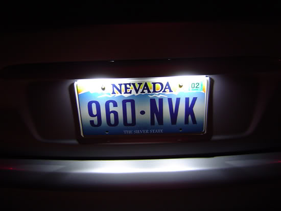

im working on my cool white plate lights right now. 3x nichia superflux (20 lumen each) per side running at 50mA each (0.5w per side total). i just need to get them sealed and installed prolly by tonight. very nice and bright altho a bit on the purple side but not too bad. its a good match with the 5400k hids.
Old Dec 7, 2010
  #123
Rep Power: 812
Re: DIY: TYC projector retrofit 2010

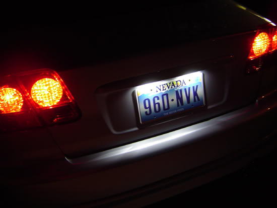

guess i shouldve updated this again. plate lights are all done, 6500k nichia is a bit whiter than the hids but still nice. very tiny hint of purple but otherwise cool white like a fluorescent. they are bright but not crazy due to the lens housing blocking alot of output and the leds being wide angle.

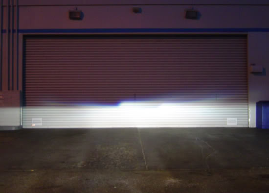

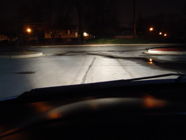

some pics to remember how suck the tyc halogen projectors were:
and these were with the brightest halogen bulb you can get, H1 +50 philips at 1800 lumens! omg no width and terrible hotspots

Rep Power: 812
yeah much worse. the hotspots and poor coverage, plus they did not have a consistent pattern. it was just blobs of light everywhere lol. i would say the middle streak was brighter than stock, but what good does that do. and aiming them was a real problem (lights had to come off the car and required special tools). this isnt good if you ever carry anything in your car or the stance changes. there is no easy adjustment, and the tyc adjusters are prone to becoming loose and causing shakes. with my retrofit, i can simply turn the wingnut i installed on top and adjust the aim in a few seconds with no tools and no taking the lights off. just pop the hood and turn.

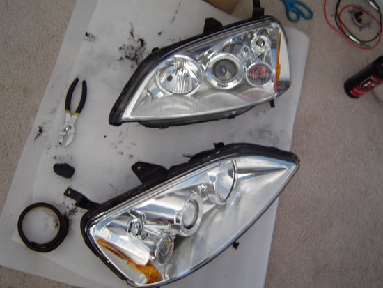

finally had time to take the retro off and fix it up a bit. not everything, but they are much better. i swapped on brand new shrouds and lens covers, went back to filament bulbs for park and turn instead of leds to make it more pnp, and spent most of the day redoing my entire wire harness. what a pita but its way better than the old one and completely hidden away. ballasts are mounted nicely next to the headlamp as well. will prolly be going back to 4300k bulbs to match the stockish look of the car, and replacing tezza grill with oem coupe grill. the hard part is aiming the lights again like they were before which always takes forever. later i may try to put led elef amber turn signal since it fits perfectly in the hole. pics later...

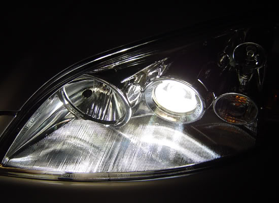

pic of the lights after getting new lenses and shrouds. all sealed and ready for install. here is the current bulb setup im using:
park light - raybrig hyper clear w5w
turn signal - cycolite 3457 NA amber (modded to delete park light function)
lo beam - osram 4300k d2s (for now)
hi beam - H1 55w halogen

yeah its as close to oem as you can get. and have some cool hids in em. the turn signal is way brighter than stock too. the fitment of the shroud isnt great and the park light and projector and hi beam dont line up exactly where they should, but overall for aftermarket its pretty decent.
and installed...oooh ahhh
toshiba wy5w NA bulb for sidemarker (VW dealer)

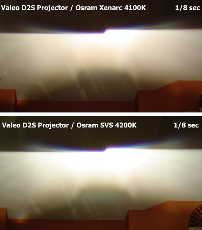

this retro is still working great. about a month ago i upgraded to osram silverstar 4200k d2s bulbs. next week i should have the osram LEDriving 4000k 1w led bulbs for license plate to match.

been using the silverstar bulbs for about 30 hrs or so, and they have already turned much whiter. really impressed with how the retro is holding up and the amount of light output.
