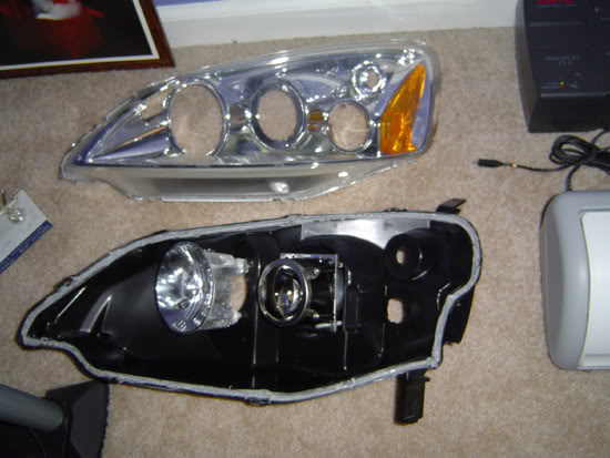

theyre here! very nice looking. the problem is, well, everything. all the sizes arent what i expected and already thers no way i can fit the hid projectors or the cadillac ones without serious cutting of the housings which im not doing. i think ill just work on the leds for now.
after alot of pulling and some blisters, i get one side open. and then spend an hour cleaning all the lil blue fragments of glass from the last explosion lol. so far here are the two final turn signal designs, however im having problems with the lens. the middle ring looks fine, but the other pattern is distorting the leds and making some look like theyre burnt out.
the middle ring of 9 leds looks fine
still working on the park light which is also not working out as i expected
pic of the light taken apart

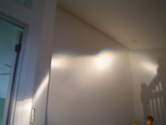

just for fun, the craptastic triple hot spot tyc projector with h1 bulb lol

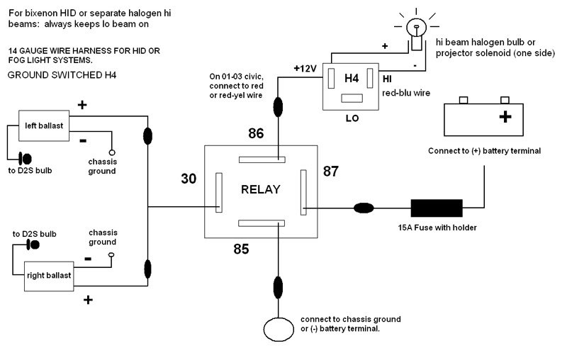

sounds good. i have them both done and sealed up, just finished putting pnp sockets on the led wiring. they should be on in about a week once i get the ballasts and wire harness pieces and actually make the harness. hopefully i can throw them on without making any adjustments other than vertical aiming. this is my wire diagram using new relay harness for hids and old oem harness for the hi beams.

diagram looks good. i went a little overboard with my harness and put each ballast on their own fuse and separate relays. since i initially measured over 12A of inrush on each of some PNP ballasts (~25A for both ballasts combined....and people wonder why you need harnesses for HID?), i felt better putting each ballast on its own relay and fuse.
Old Aug 20, 2009
Rep Power: 812
Re: DIY: TYC projector retrofit 2009
its a good idea, in case one relay fails, you wont lose both sides of headlight. but hi beams are there for emergency i guess.
