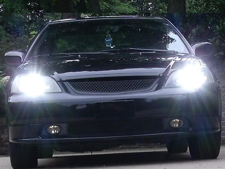

I Have the E46 stuffed (and i mean stuffed) into the TYC housing using 50 watt ebay kit and ebay D2S Bulbs, and its bright, just a bitch to aim. Side by Side with a BMW you can tell the difference, Only for my cut off is a lil tilted....but cool with me i guess...(and 6000K) Also i just went outside and noticed that my projectors are pointed in towards one another....but what ever i mean "retrofit" is another way of saying.."pull something out your *** to make it work, cause its not made for that"...so its almost never going to be perfect.
Ill need to take some pics so i can sho

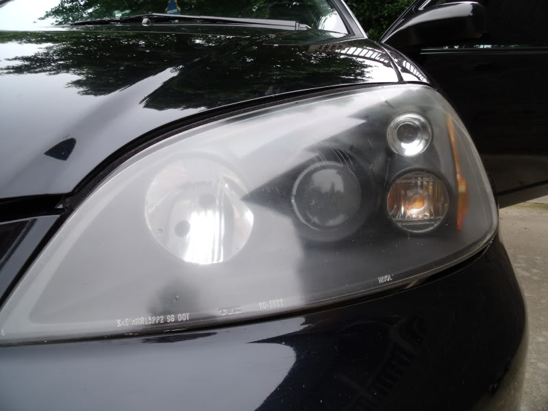

UPDATE: these turn signals worked out awesome. they are the 1.85 inch 48-led amber dual intensity clusters from radiantz lighting. i recommend these to anyone with tycs who wants a clear signal that flashes bright amber. i havent done a comparo, but i bet these look more intense than the filament bulbs.
http://www.radiantz.com/cart/index1.html?c14.html&1
these are huge among the biker crowd for their reliability and intensity. they only use basic 5mm leds, but they are so sharp and usually look brighter than a filament bulb. i will be using them as DRL in bright mode. also as standard park/turn lights. the parking light mode is actually way too bright, and i plan to add some extra resistor so it doesnt make my other park lights look messed and dim. install was a snap, i wanted these completely removable just in case something breaks (doubtful), so i just held them onto the stock tyc bulb reflector and filled butyl (3m windoweld) in the rear to hold it to the trim piece. i also painted the outer ring of the led cluster chrome/silver so it blends in a bit better. the leds also have some orange to the dies in the middle, but when everything is about an inch or two behind the diffuser, it looks crystal clear no problems. its so bright that the light even shines 180 degrees to the side and out the reflector window. so no need to add extra leds facing the side.
here is the cluster mounted to the turn reflector piece and held with some butyl. its not super strong, but it wont fall out either. the array is pretty light and everything is mostly sealed.
installed behind diffuser, this hides any weirdness of the array and looks like normal clear bulb is behind it.
look how bright parking light mode is. even light coming out the side. i could not take head-on pics because the intensity would kill the camera.
now comparing park vs turn brightness on the ground.

anyway here are comparo pics with 3457 stock amber filament bulbs, the brightest bulb in existance at 500 lumens (27w). for a LED cluster at 5w and maybe 50 lumens, its amazing the leds can even compare. bulb wins in this case obviously, but there are many other different turn signal setups where the reflector isnt as good and bulb is a lower wattage like 21w 350 lumen. so in some cases, leds may win. in this case, they are still very bright and good to use due to lower wattage, clear lens look, and low heat. prolly still brighter than many other cars' oem signals.
here is the filament bulb (hoping that haze comes off the lens lol)
and the led cluster
parking light comparo, leds clearly the winner with more intense light and pure color. i will have to dim these down later to match the other park lights on the car.
turn signal is no contest. bulb just has too many lumens. you can see the light spilling everywhere and the huge lens flare. led is also at a disadvantage because of the clear diffuser in front of the cluster.
