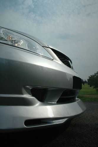

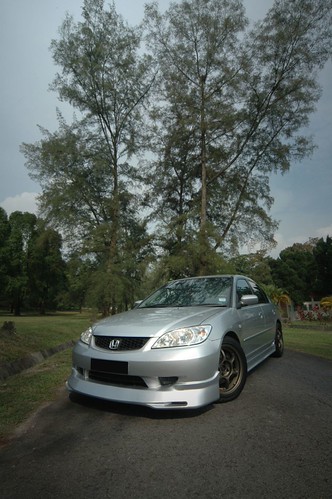

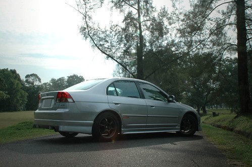

Thanks for your compliments bro! As request more pics of my bitch!
I was thinking of reducing the huge drop everytime I upshift. Another method is a close gearbox ratio. But changing FD will be easier. I wonder if We could use the EG civics gear ratio from Mfactory
Some photos of my humble ES Civic.
The photos below were taken on the Move coordinated with the photographer in another car. (My car was Running at 60-90km/hour)

nice photos man. singapore is doing it big lol.

what rear lip is that?

Customised Real Lip =)
EVO wannabe rear lip? HAHA

damn! you're car is sexy as hell!

damn it! i want that rear lip
maby when i go up to singapore at the end of the yr, ill find 1 that looks the same.

You won't find it dude. If you find someway of bringing it back, maybe I can contact the person who customised it for me
Singapore to USA, i wonder how much the cost will it be!
