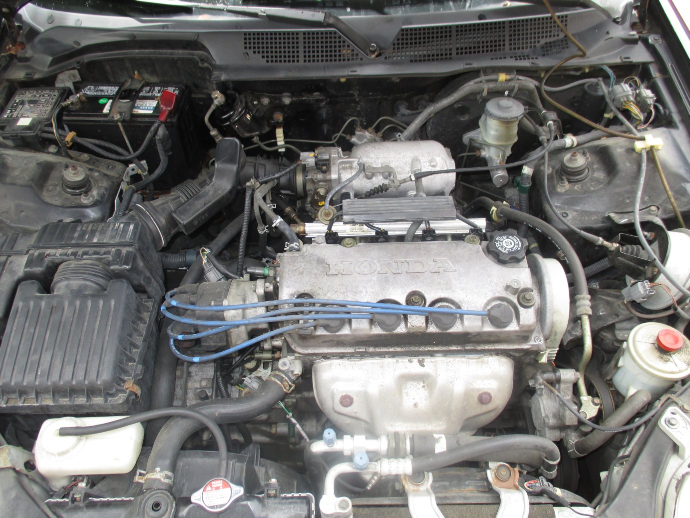

I've been having this issue for a couple months now. I am not a mechanic, but hope to do small repairs when I can. Sorry I'm longwinded, LOL.
I have a 1998 Honda Civic EX, 2-door coupe. The problem first happened when we were going to the zoo, about a 15-min drive on a hot day. The car stalled, and we could start it again and drive for a few feet, then it would stall again. Eventually the car had to be towed. After taking it to the mechanic, he said they got the car to work fine for two days and nothing was looked at.
I drive it home. My fiance drove it for a couple of months, but only short distances. Then we went to the zoo again. This time it stalled on the way back. I was driving it this time. It seems the engine totally died. I saw the RPM gauge drop to 0 suddenly and it became hard to steer. I guess power steering was lost. I was able to pull over safely but couldn't get it to start again at all. We towed the vehicle again.
We wondered if maybe I got dirt or water in the fuel, but I don't think we can check that on our own easily. We tried one of those fuel injector cleaners (dunno what they're called) for a few bucks, but that didn't work. I decided to change the fuel filter. But before doing that, I decided to try the car again and this time just go nearby late at night (I was really hungry). The car got there, but wouldn't start again after. I went the next day and was able to drive it home.
So this time we changed the fuel filter. It was plenty dirty, and I don't know if it was ever changed. I don't know much about cars, and nobody ever mentioned it. I wish I had changed it before, but who knows? So after changing it, it seemed to drive smoother, and we drove it nearby again. It got there ok, but now it won't start again. It's cranking, but won't turn over. The radio comes on fine... The battery is about 2 years old, not really old, and I wish I had something to check it with.
I dunno what's going on, and I hope you guys can help me. I'm happy we got the fuel filter out of the way, but I don't know what else to do. I'm thinking of replacing the fuel pump relay but that's $50 and I'm not sure how to do that. And I have no idea if that's it. I need help diagnosing this. I know that was all WALL OF TEXT-like, but I'm a firm believer that the more info you get, the more likely you can figure out the solution.
Oh I should add that when I can't get it to start, the battery light, the check engine light and oil light are all lit. The check engine light is always on, however, and has been for years due to a faulty O2 sensor. I think the battery and oil light are typically on when you first turn the key, right? The oil is only slightly low, and according to the mechanic shouldn't cause a problem. These lights also came on when the car stalled while driving. I called Honda about the ignition switch recall and they said my vehicle wasn't involved.
Currently I'm trying to read the error codes with a paperclip. My options are really poor because my fiance's truck doesn't work either and we're pretty poor. But hey, we're trying. Here's an image under the hood:

Re: Stalls on the road or doesn't start at all when warm
3 of the most common problem areas, but certainly not all of the possible causes:
PGMFI Main Relay, it can kill the fuel pump OR kill the computer. Common malady is cracked solder joints, resoldering everything on the circuit board is almost free and darn effective.
Ignition switch, when the engine dies the lights in the cluster would be off and they may flicker as you slowly turn the key and you may be able to make it stall by slowly moving the key.
Ignition (spark) problem... Igniter going bad, coil going bad..bad connections on the igniter, ....?
While it won't start, you need to figure out if it has lost spark or lost fuel.
Get someone to hookup jumper cables to it, start it (if possible) and drive to an auto parts store that will test your battery and alternator for free. Could very well be your alternator causing the issue. Follow Ezone's suggestions, review and use this: http://troubleshootmyvehicle.com/hon...rt-condition-1

Jumping to repairing the relay without knowing if it is actually the problem:
Location, 98 Civic:
Video, repairing said relay (this guy is an instructor at a tech school and there is a lot of extra stuff)
Video on checking for spark issue
NOTE: in order for testing to be effective, the car must be effectively dead, will not start.
If the car can start and run, the problem will not be found.
HTH
From 2:28 to the end is the start/stall, and I see the tach needle dropped like a rock at that moment it stalled.
At the point you twisted the key to crank it (2:32), I noticed the check engine light turn off for a split second as it started to crank, then it ran and stalled.
Also interesting is that after the stall and the engine had stopped, the tach jumped a little bit (your flutter?) before you tried to crank the engine again (2:36).
Not sure of the significance of those observations, but I would have them noted for reference as unusual and possible clues that may be worthy of investigation.
After it stalled, did you try pressing the gas pedal while cranking it?
There's no way I can diagnose anything from the Lazy Boy recliner I'm sitting in right now, but I'd still suspect an ignition related problem, not necessarily in the distributor---- actual testing would have to be involved to prove or disprove the guess.
Distributor has 3 sensors CKP, CYP, and TDC. Signals from these sensors are fed to the computer, the computer figures out the ignition timing it wants, and sends a signal to the igniter unit (ICM) to fire the coil and make spark.
If I found a 'no spark' situation that does not have a clear cause, I'd probably use a labscope to inspect the signals from the distributor to the computer, and from the computer back to the distributor to try to find where the loss originates.
Of course if spark is still present even though the engine won't run, I'd go a completely different direction in diagnosis.
And don't forget there's a lot of wiring involved. Wiring issues make some people pull their hair out, and no amount of parts replacing can fix real wiring problems.
So I guess first thing is to verify whether or not spark is present while it won't start.
Note how long you ran it, build up a repeatable scenario that a mechanic can use to easily get it to act up/quit running consistently, since getting it to break is necessary to diagnose it.
Oil (pressure) and battery (alternator charging) lights are supposed to stay on as long as the key is on and the engine is not running.
A test light could be as simple as a light bulb with a couple wires attached to it.
A real basic 12v test light might be less than $5 at some parts stores, or DIY for almost nothing if you have the right voltage light bulbs and wire laying around.
Know anyone with an identical car you can try swapping parts from?
