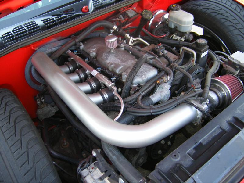

the larg square plenum design isnt good for flow. you would need to shape the entire inside for velocity. Good N/A I/M's spend countless hours on a flow bench. These motors like longer intake runners stock. what you have is ideal for a boosted car though. dont get me wrong. its just not going to provide you with the same benefit while N/A. it will take away from your top end after the volume of air it holds is used, because it will not flow at a high enough velocity to keep the plenum full. with air being forced in to it there is no need to worry about how fast air is being drawn in because it pressurized.
take a look at this manifold. i have never see anything like it. i was pretty impressed. i think it would be good for either application.

Old Jan 30, 2007
Civicman1988's Avatar
iTrader: (24)
Joined: Apr 2005
Posts: 4,441
Rep Power: 303
if you have seen the way it is set up inside its just just like a round tube the square corners are not square i just like the square look. i did my research it can go either way
Old Jan 31, 2007
familycar's Avatar
Posts: 3,566
From: so cal
Rep Power: 304
good job then. I wish you had some pics of the inside for me..
usually manfiolds arent good for both type of aspiration. but with the correct baffling and fabrication its defnately possible..
+rep for you for doing such a good job and being such a good welder lol
