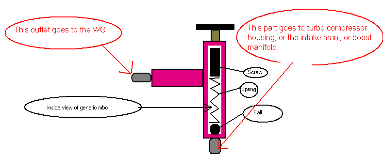

I recently sold my greddy profec spec II to a member. I just received my MBC.
Where do you guys tap ur vaccum lines to.
One goes to the turbo wastegate.
The other goes to???
I did a search and got this DIY.
It say tap the line between BOV and IM.
http://www.geocities.com/chmwatson/FAQs/mbc.html
What you guys think?

The inlet opposite side of the crew head is the part that goes to the intake mani. The outlet in the middle of the boost controller goes to the wastegate. The mbc that i made looks just like that one you have in your link.

Diagram
I was bored at work so here goes the drawing.

Dam. you got to do that at work!!!! That cleans a lot on which line hook up to where.
