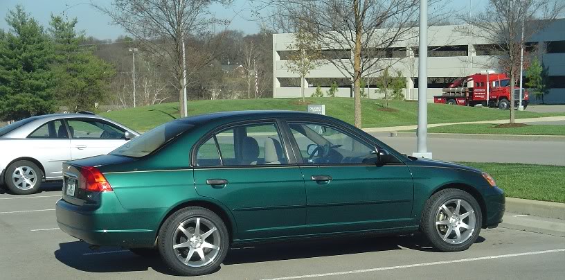

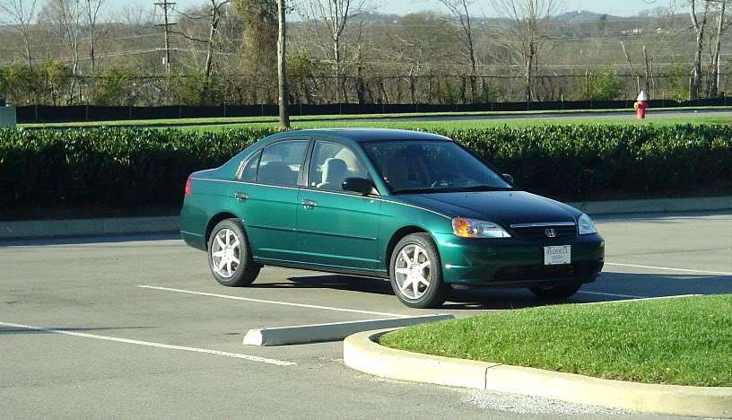

Let's see, I always drove VW's, and the first honda was just after i arrived in US. A Japanese guy going back to Japan just had a civic to sell.
It was a green 01 LX auto (that threw me off, but not many choices anyway...) and the tan interior (I know, i know, it looks like Sh** colored).

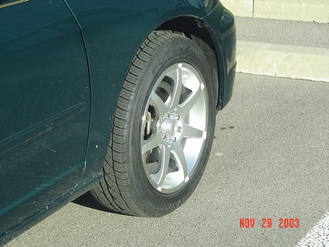

Driving it, the first thing i felt was: these tires do not hold anything...
So i checked the vics and saw that some uses 205/55R16 - that was my choice, even if it threw the speedo by a little.

Much better. I still use these wheels, but much better tires now.

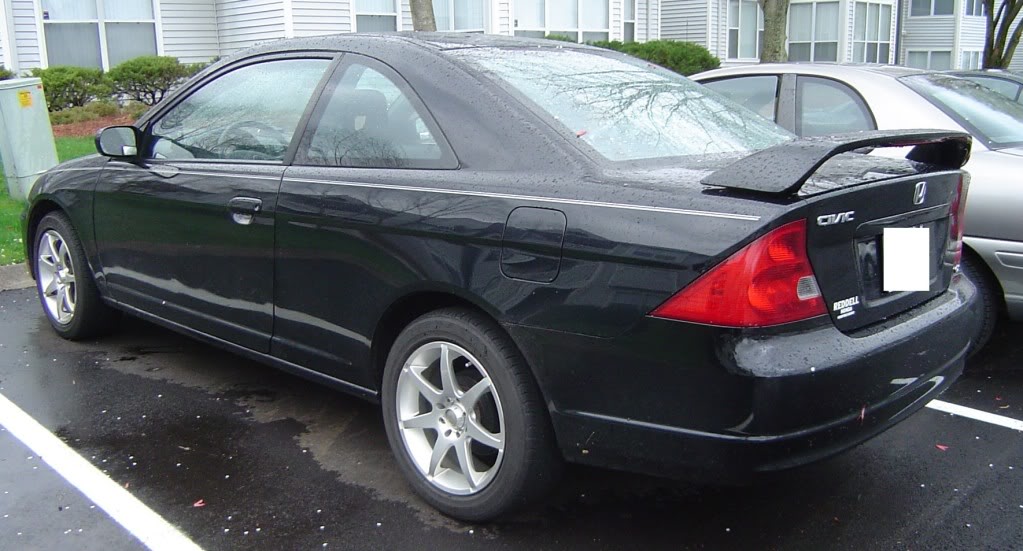

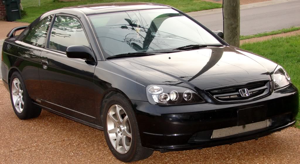

in 2005, i was just tired of the auto and found my current baby.
this is it - the first thing i did was to install eibach kit (Prokit, sways and the KYB AGX), since i felt it was just... too soft and unstable. Also, threw my old wheel in there.

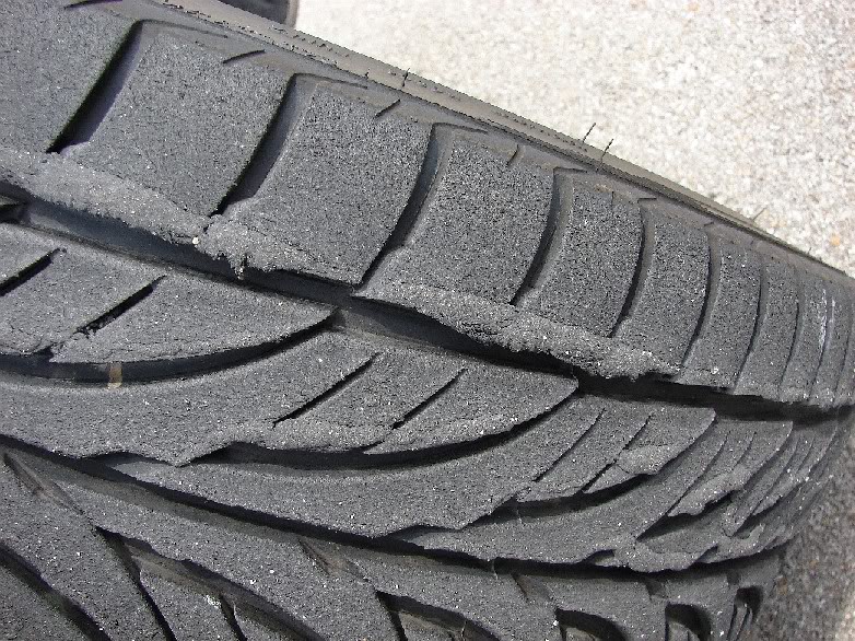

Have had a few road track runs with the car too.
The tires did not like the experience too much... Civic:
Miata:

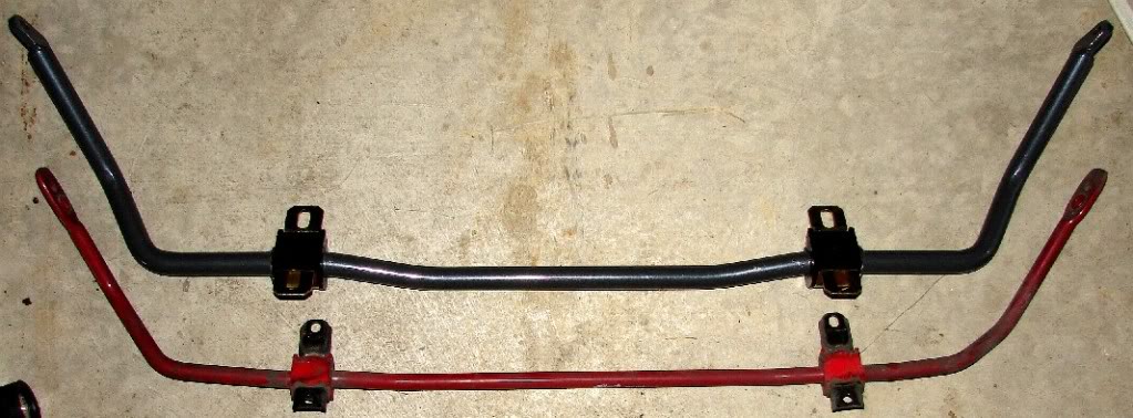

in 2009, I finally bit the bait and installed front/rear camber kits, the rear progress sway bar. Night and day!!!!
Progress vs the Eibach rear
progress reinforcements
Now the car rotates instead of sliding the front wheels! now me gearbox will live longer!

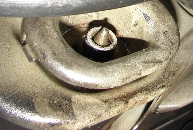

Sep 2009 - the last victim of the understeer - the LCA did crack... Yeah, it happens...

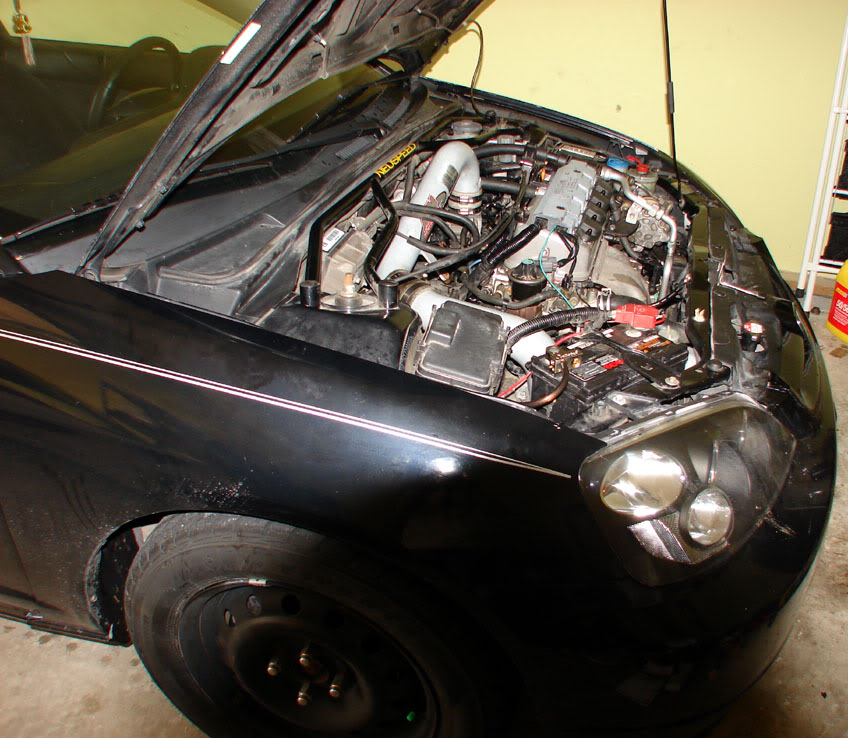

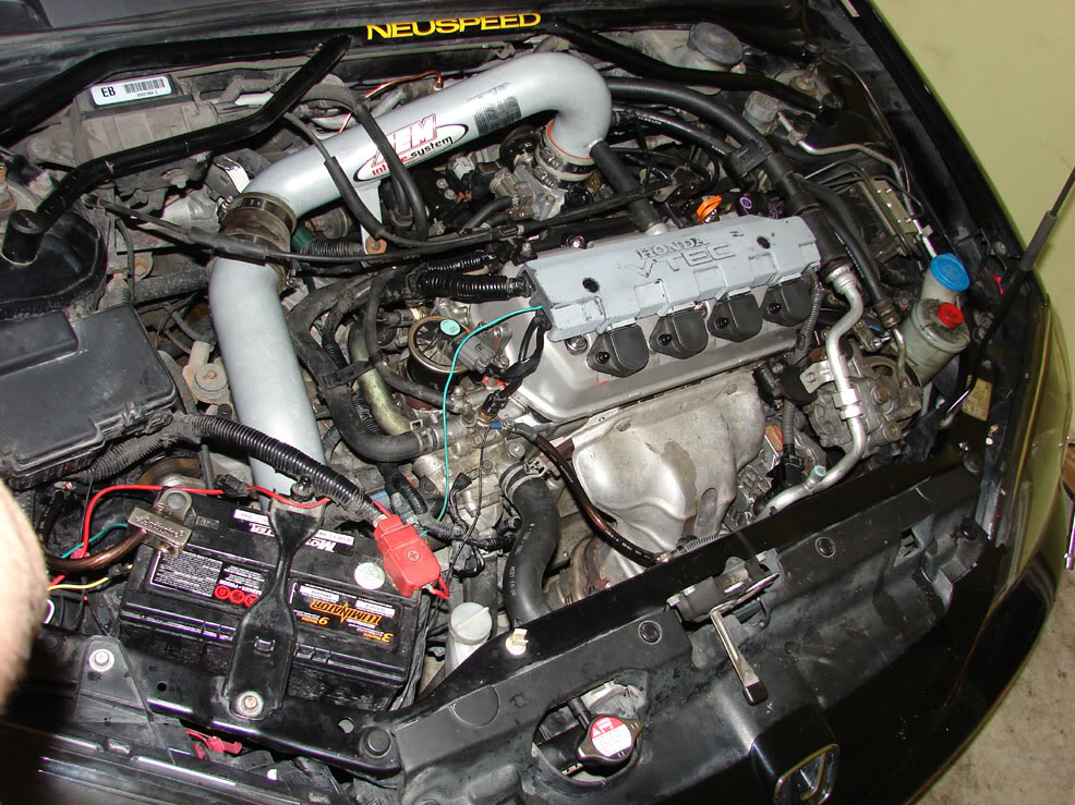

Now, finally back to a place with a garage to work in, and timing belt, water pump, head gasket and crower stage 1 cam starting to rock today!
Ah, the head gasket lasted dfor 3 months, and survived the 1200 miles trip and passed inspections when i arrived here

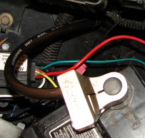

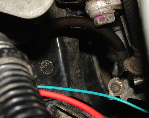

Ah, And Electric130 big-3 ground kit too
The ground kit thread - he still had some left now?
https://www.civicforums.com/forums/1...kits-sale.html

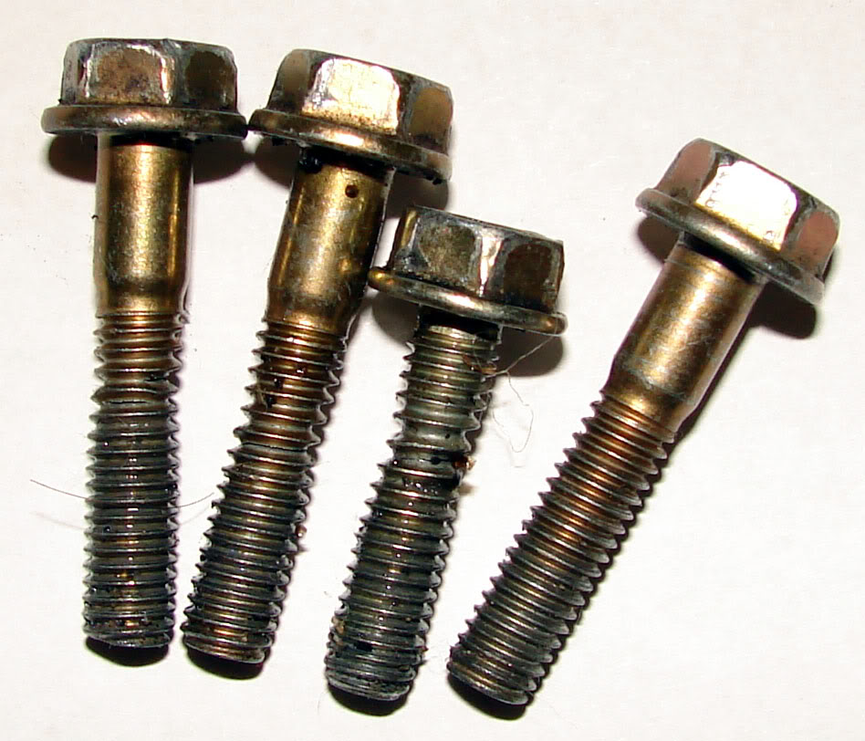

OK, then, for low torque applications, it is recommended to use a beam type torque wrench. The "click" type is not recommended since it is not too accurate for lower ranges.
Now, a quick quiz: Which of these 4 bolts are still good? (they are my water pump bolts...) I used the click type on them...

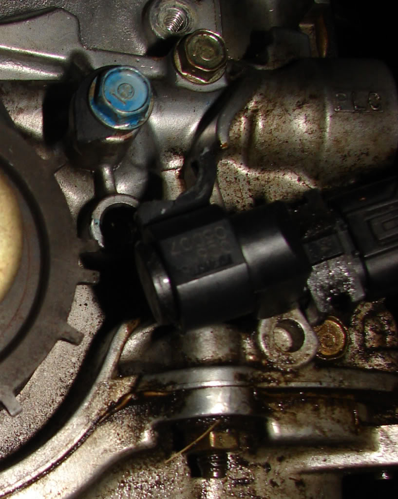

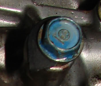

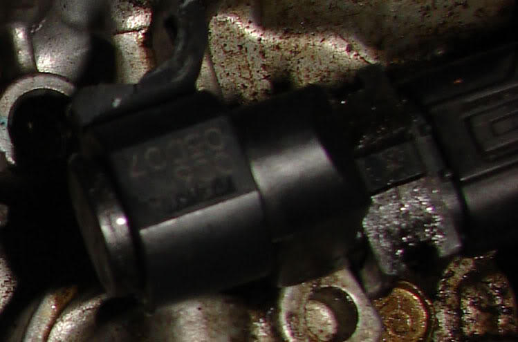

Crankshaft position sensor Part 1
Old Jun 26, 2011
Posts: 15,190
Likes: 1,609
Re: sdaidoji's 'vics stories
Crankshaft position sensor part 2:
?!? The hell?
Old Jun 26, 2011
Posts: 15,190
Likes: 1,609
Crankshaft position sensor, combo package
Ahhhh, do never overtorque a plastic sensoooor! I got it now, sir!

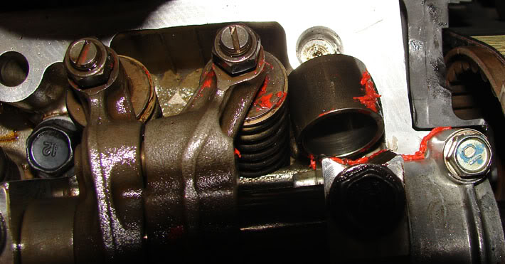

Rocker arms - they are not held by any bolts or clamps or anything, so when installing in the head, if they come apart, make sure to check if all the spacers are still in there. This is what i saw the moement i finished torqueing the arms...
The ring with the orange gasket maker? well, it's called spacer and was supposed to be in the shaft... He simply said: "suuurpriiiise!"

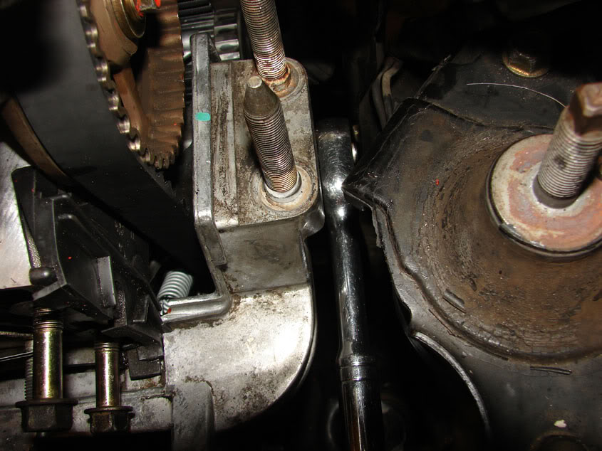

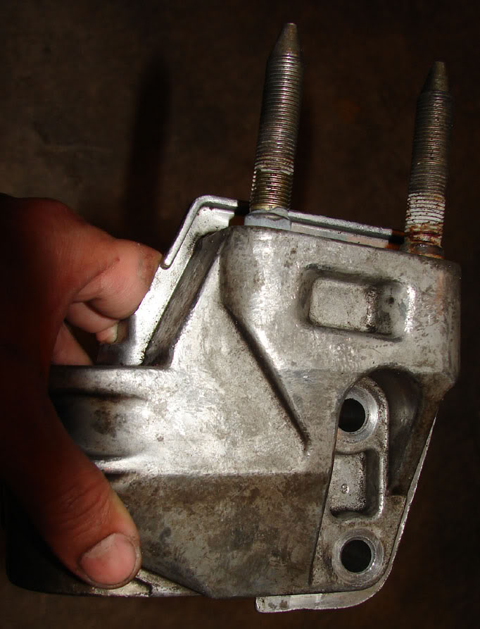

this is another for the timing belt - they made it to work with the engine out of the car, that is. My hands almost did not fit to place the wrench in here... And let me say, there IS a socket in there... Hate with all my life force the alternator bracket...
See how deep is the bolt dug in there? Daaarm!

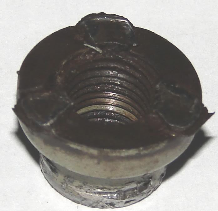

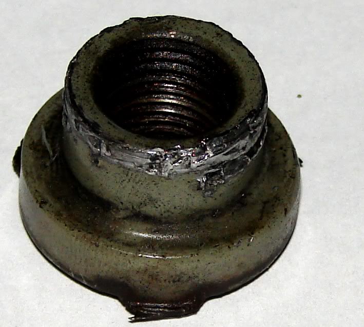

almost forgotten this ones that gave me grief during my rear sway install.
There are these bolts behind the mountings of the LCA in the rear, as seen in here:
They are on the other side, hidden in these holes:

Guess what? They are spot-welded in in place, 3 spots - (yeah, you can see the supposedly welded spots in here, so i can see some of you starting to roll on the floor laughing, just with the expectation of what is to come...):
Well, this is the other side of the nut... NO HEX to put a WRENCH!!!! IT"S ROUND SMOOTH!!!! And the welds did break, as some might have already inferred...
Sooo, to take the old sway out, i had to get vise grips with a thin "beak" to hold the NUT and take it out...

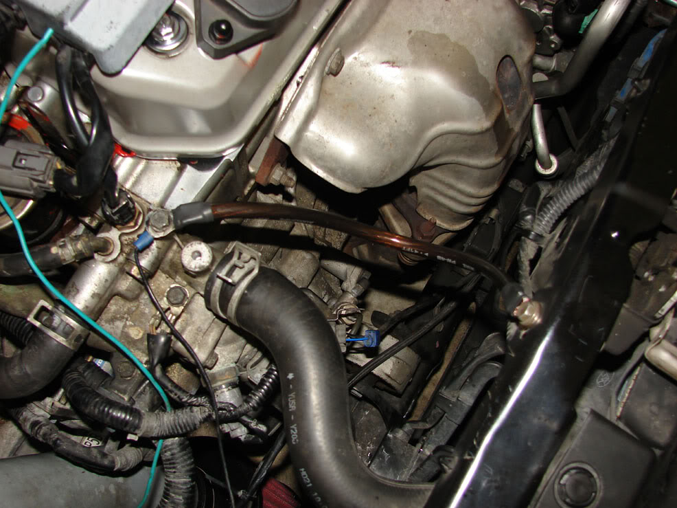

Yesterday, i was having a slight jerk when lifting off the gas, so i took a look - i actually adjusted the throttle cable wrongly, and too much slack - now i can open the throttle completely and no more jerks. But when refilling the coolant in the overflow, well, where is the cap again? (dumb, dumb, dumb! Off to buy a new cap again...)
After one more day of testing, all tools in the car, code reader hooked up during driving, and i can call a day fer the vic and start the heavier maintenance in the miata... (i guess the clutch is starting to slip...) never ending stories...
Civic is smoother with all the tune-ups, feeling freelier when stepping in the gas, ahhhhh! More powa (a little bit )
