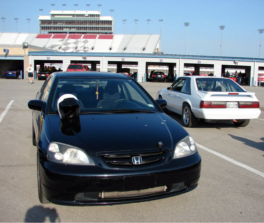

older headlights, at nashville superspeedway, a few years ago during a track day

No, the red truck is NOT running the track!!! :P

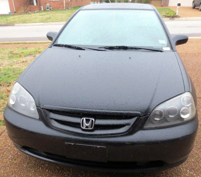

wacko weather... just below freezing temps, but we had freezing rain here in TN... WTF?!?
thought i would be safe this down south... no snow fell, but all frozen shut... even the hood...
^ oh, yeah, you can also notice the crack in the rear bumper right at the corner under the rear lights, one thing i never bothered to fix... it's not in the direction of hits anyway

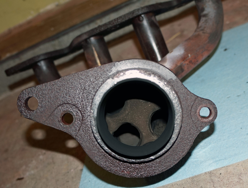

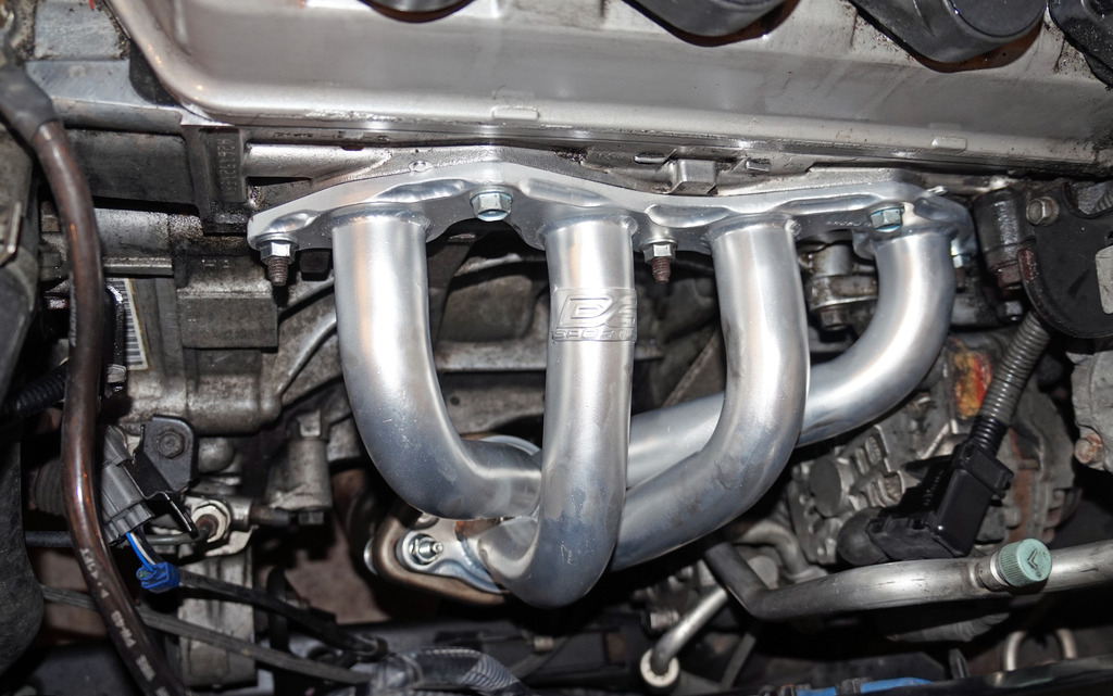

have been a while... mostly small stuff that need fixing, additional dents in the body (Hail, and a big rock on the hood... but did a change today - Downside was that found a tie-rod that need replacing...
Finally got a chance to pull the other car out (needing hood hinges... Fender is being a pain to remove to get to them...) and put the civic on the bay.
Had it since Thanksgiving, but had not finished the other car, so was in the backburner. (Hey, it was almost half price at THmortorsports, why not?
Just 7 bolts, but don't forget that the exhaust bolts are usually a pain, rusted to kingdom come... PB Blast!!!
The OE piece is really pretty good, I see, but the DC sports have a few things that seem better. Not just slightly bigger piping, but where all tubes conjoin is much better designed for flow. And the lower bolts have threads, so easier to put together. However, it's easier to do them from under the car.
OE with heat shield
OE without heat shield:
After - DC sports header
Side-by-side
LOL, yeah, they have different center of gravity

This is OE, where tubes conjoin
This is DC sports

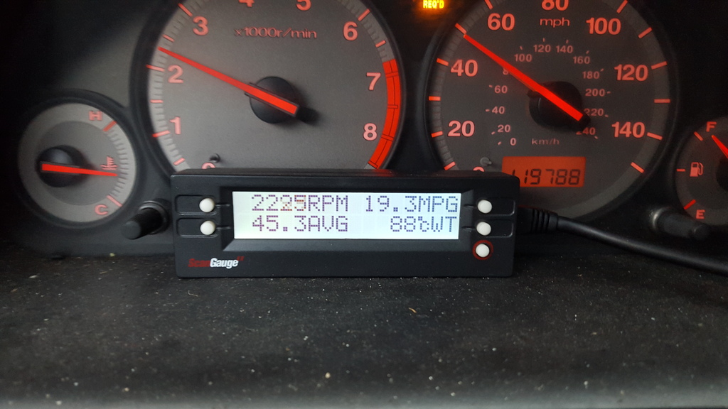

third best ever was the trip back from Canada, hauling all my stuff...
did not have the scan gauge at the time, so it was actual tank vs mileage, at 44 MPG
what i had in the car for my move? well, you would not believe how much stuff fits inside a civic...

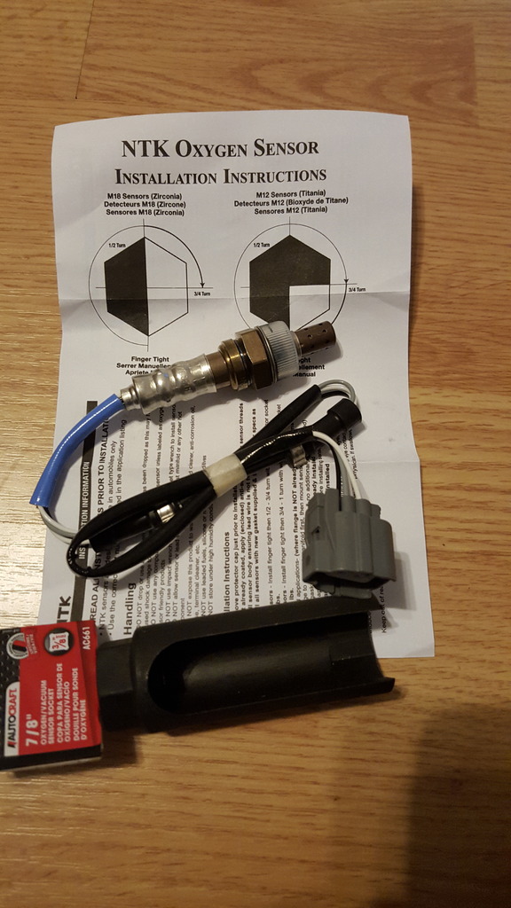

huh-ho...
good thing on the scan gauge type - it will let you know right away what the code is... Not that it will help you any, other than knowing what it is...
on the way back
Old Jun 29, 2016
  #54
Posts: 15,190
Likes: 1,609
Re: sdaidoji's 'vics stories
Done.
The plug is a pain, don't forget to push the tab to release it.
reach from the bottom, it's easier - from the top, the pipe bend directs the tool/wrench to the components n the left side of the car. From the bottom, the angle open the space.
Old Jun 29, 2016
  #55
Posts: 15,190
Likes: 1,609
Wasn't sure if it was due to recent temperature, but now it's clear... O2 sensor going bad but not there yet was causing:
1)lower torque
2) worse mpg 33-34, now back to 38-40

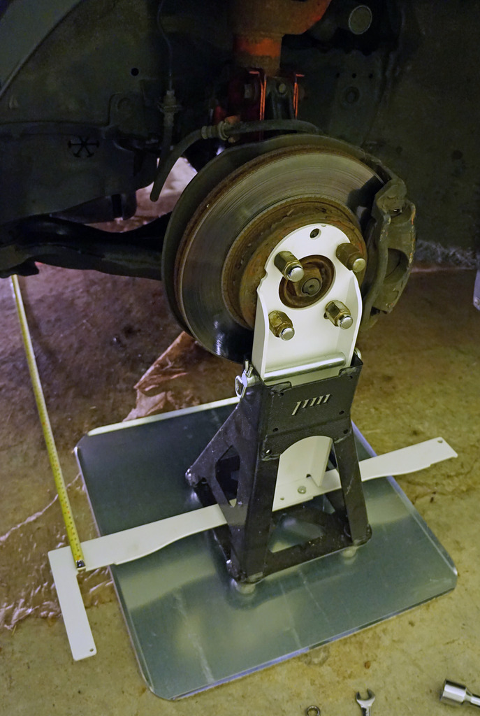

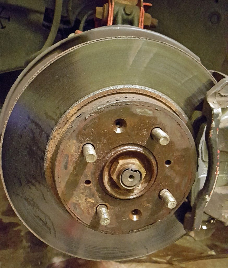

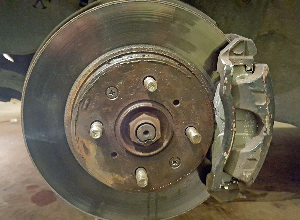

brake refresh - pads and rotors and slider lube.
but hit a snag and had some help
from the DIY tip section:
"The rotors in the 7th gen lasts a long time. Mine were still stock and if one was not warped, they would still be there.
after 1 1/2 year in Canada, they were stuck in place... One side, I had a bearing replaced, so it was removed (they did not put the bolts back, I can understand why).
the other... a pain!
I am referring to these ones that are still left in the rotor. They are simply there to hold them in place during the assembly line to not to fall out.
impact wrench, drill with driver bits, PB blast, heat, nothing could take them out. Also, I had to stop before they stripped.
that's when MAC and ezone told me of the impact driver. No, it's not an impact wrench.
this is not powered, it's manual.
it have bits that are screw drivers (straight, philips) and when you wack on them, they turn.
So, you don't need to push like crazy, the wack pushes the tool against the bolt, so it does not strip as easily.
took me two days wacking the hell out of it...
but victory was mine!!!
The holding bolts will never find its way back to the rotors!!!
thanks, Mac and ezone!
note: there's some of them that are reversible, but there's no manual that comes with them. Be sure it's adjusted to the right direction before you go wacking at it.
I pushed mine against the floor to see which direction it turned."

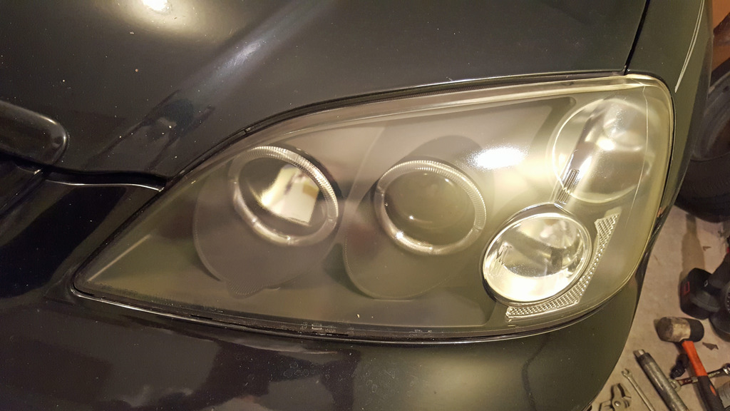

after polishing the headlights, followed xriceboyx tip to clear coat them still need to polish the coat, though...
"After polishing my headlights, it always hazed quite fast...
that's when xriceboyx gave the the crucial tip:
after polishing, just clear coat the headlight.
Don't forget to polish the clear coat, or the roughness will make the light scatter too much.
mine have been clear so far for a month, before it would haze back in a week.
pre-polishing the clear coat, so you can notice the roughness
