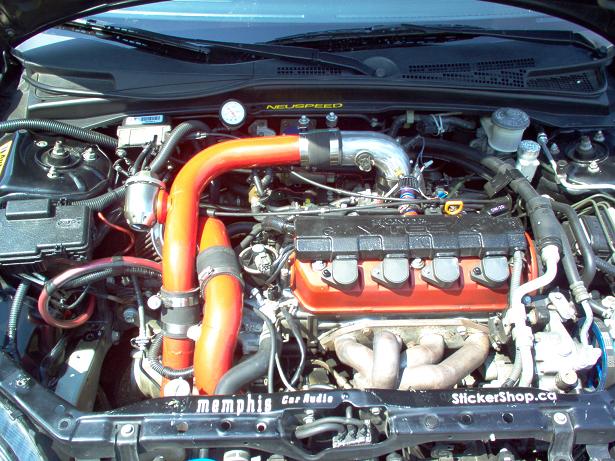

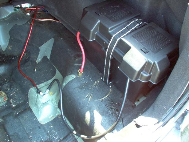

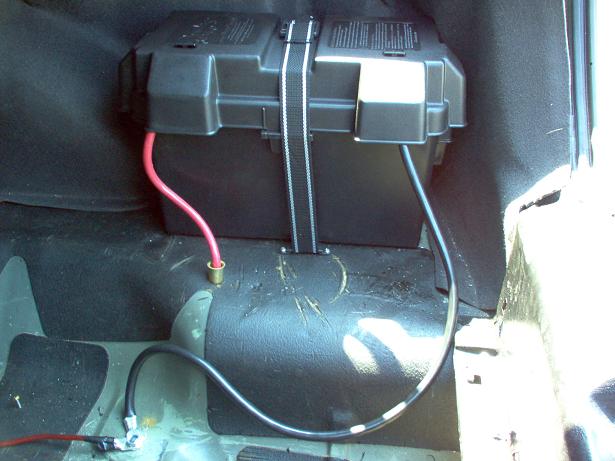

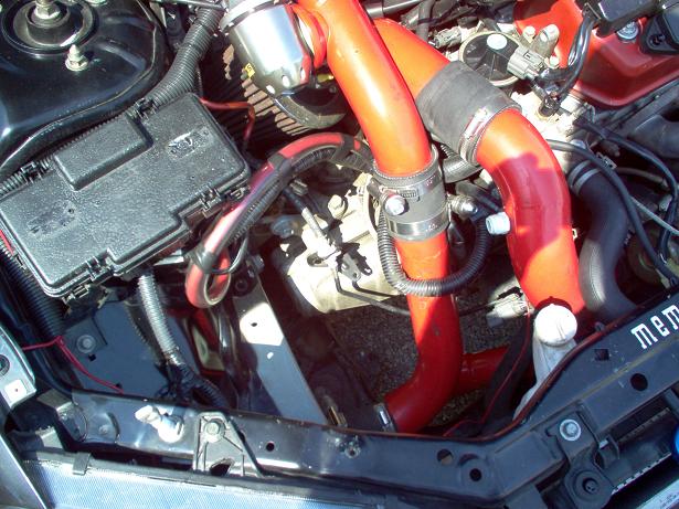

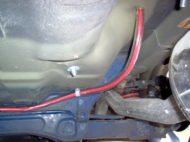

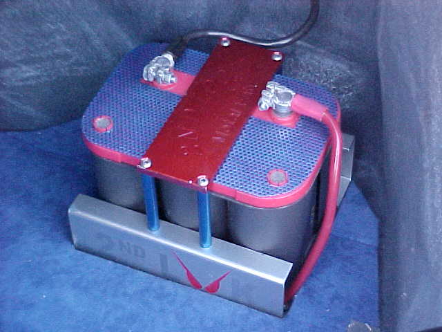

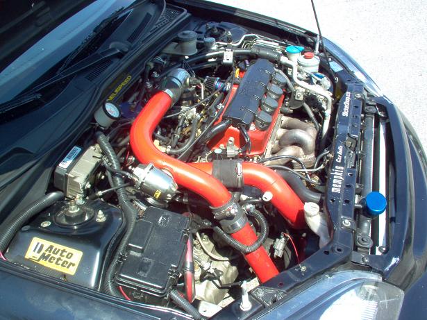

sup guys, saw a few battery relocations done and i decided to get the summit racing kit and do it too, check it out.
i think it maks the engine bay look alot better, i ran the positive cable under the car, i didnt know how it would hold up against the elements, so i ran it through a clear rubber line to protect it, the line goes from the trunk floor all the way to the engine bay where it is sealed so no water has any chance of getting to the cable. i also ran an line to the block to better ground out the battery.

looks real good! one suggestion/question... are you thinking of putting some kind of sealant on the tube that is going into the bottom of your trunk to avoid water leakage or is it a sleve that goes all the way though that I didnt see...? just wondering... looks good tho!

looks good. i wanna do this. ar eu running stock battery?
any start delay's or problems?
i wanna put two in the well of my trunk

your ride is tight ! any worries about leaving your battery cable exposed ? cable could be cut and car broken into in no time without tripping alarm if you have one ? for some reason I just don't think running the cable under the car seems to be a good idea. open space under hood seems odd too, but it may just be the camera angle.

Now you can relocate your air filter. I think you would get better flow putting it where the battery used to be.
well i dont have a alarm on my car first off, and second off if the dude is gonna assume i have a relocated battery and check under the car to cut the positive cable, he deserves the car. third off he could have done that with my battery in my engine bay because i have no lock on my hood, all i have are hood pins, i dont have the stock latch, so really anyone could go up to my hood and open it (if they knew about it)
and lastly i didnt like the idea of running the cable under the car either, that is why i insulated it in chemical resistant, 1/4 think rubber hose. and its sealed on both ends, look at the pics.

everything feels the way it did before the relocate, and no i got a optima red top
