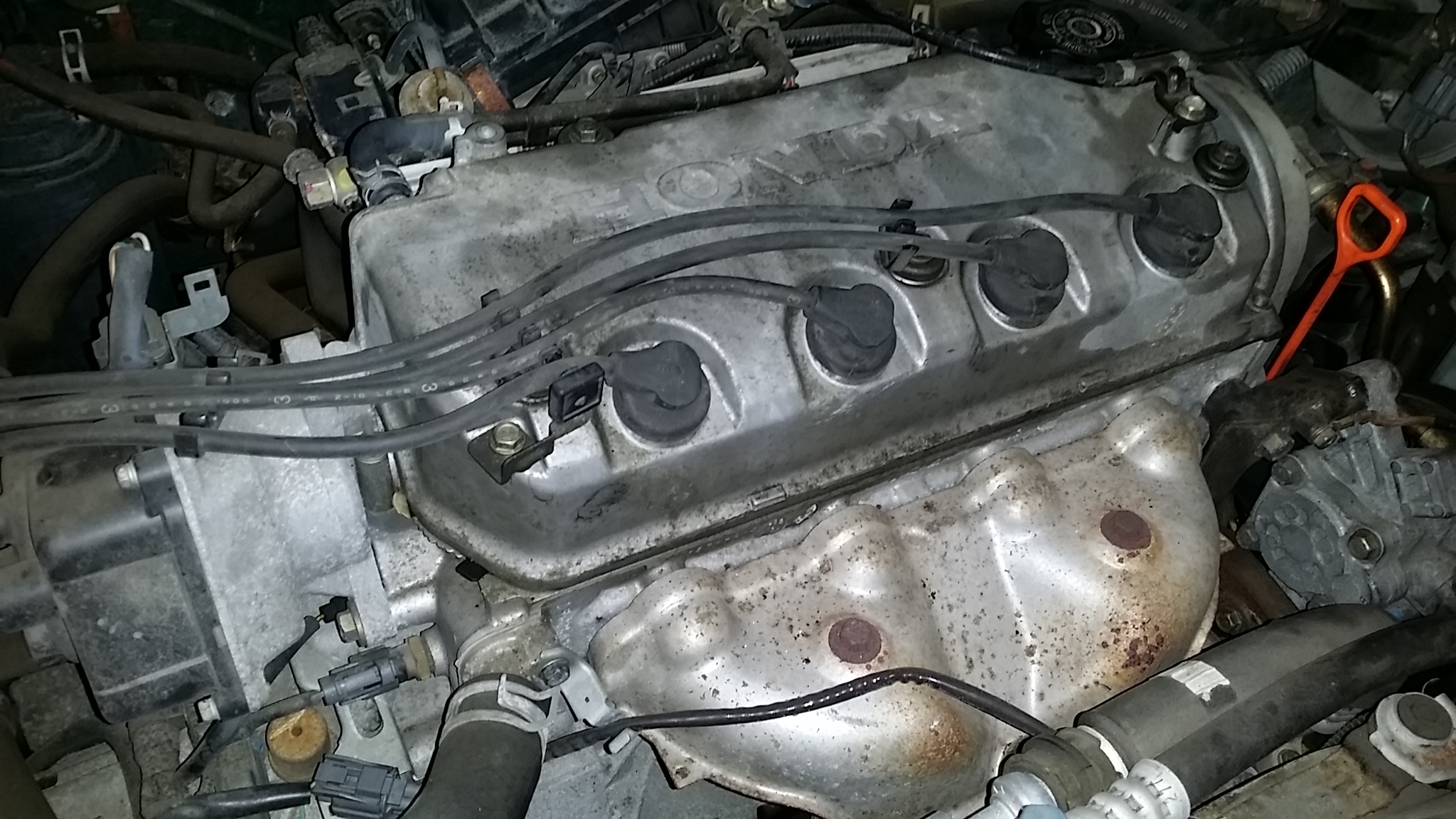

10 days ago, my engine started making a weird grinding noise from the belts area. Took it to a mechanic and he said it was the AC Compressor Clutch Pulley, but the timing belt and tensioner were fine. Car has 115k miles on it so its due for a timing belt, tensioner, water pump, etc. change anyway. He was charging $700 so I said forget it and would do it myself in the next few weeks.
A couple of days later, I noticed a burning smell every time I would shut off my engine after driving for a bit. It was a very strong smell. I didn't think too much of it. Well a few days ago I started the car and heard a loud squealing from the belt and the engine was really rough and idling really low. I shut it off, but tried a few more times to start the car after that. Same issue. So I left it alone, didn't start it and didn't drive it.
Yesterday, car is not starting. When cranking, it sounds weird as if its really struggling and underpowered. No battery issue and spark plugs didn't seem to be flooded (haven't checked to see if they spark or not).
I'm at a loss. I asked a local friend and he said the timing belt might have skipped a couple of teeth and bent a valve. I opened the head to inspect the timing belt through that little window and it looks okay (i.e. not snapped).
The bottom half of engine seems to be soaked in oil. I don't think it was like that before, but I can't be sure. Here are some pics. Any ideas on steps I should take to diagnose it?? Its a 2000 Honda Civic Automatic LX. No check engine light.
What has been done to resolve this issue?
I know, nothing was done to it.
Remove the belt for the AC and see if it will start.

Correct. The mechanic said not to worry about it and it is just making noise because of the bearing. Are you suggesting the pulley seized and is preventing the other belts from doing their job? I don't know much about that stuff, but it makes sense.

Re: Engine diagnosis - Crank but no start
Is this is a 96-00 car?
After removing the AC belt, spin the two pulleys and see if one is locked up or noisy.
The adjuster pulley is known for its bearing going bad and becoming noisy, and the compressor pulley can do the same.

ezone - you are a genius! I can't believe I didn't put that together myself. I took the belt off and tried spinning the idler pulley and the A/C clutch pulley. The AC clutch pulley was seized. Couldn't spin it at all.
Tried starting the car and it was cranking nicely, but wouldn't start. Probably because of all the other crap I tried doing prior. Had to give it some gas to get it started, but it did finally.
Seems to be idling a little rough, but not that bad. I'm planning on doing spark plugs, timing belt, etc. stuff soon, so hopefully its better.
Do you think I should try and replace just the A/C Compressor Clutch or the whole condenser? The clutch is about $100 but I think I've read its hard to remove the clutch from the condenser.
