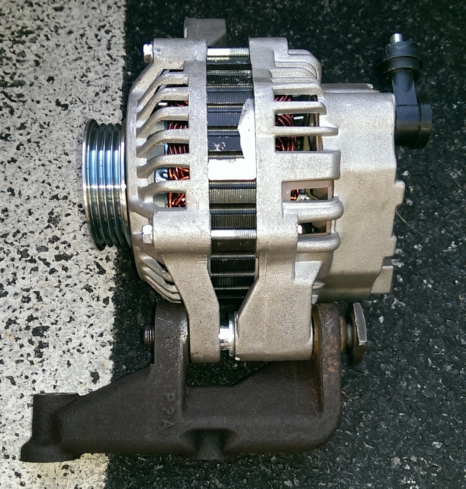

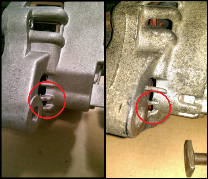

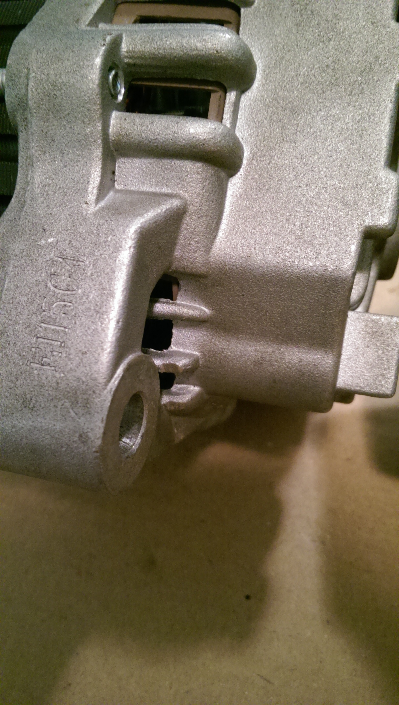

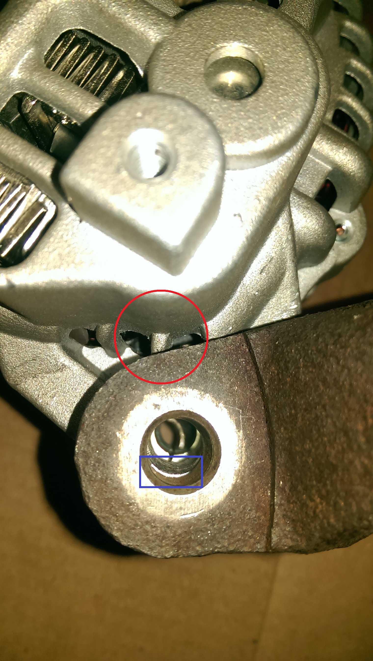

Well I figured out why it doesn't fit. Hours of trying to shift it and it turns out it never would fit right. When I tested the fit on the bench I didn't realize I had the bracket backwards. It fit that direction because the side of the bracket with the bushing is about 1/16" thinner... I am attaching the pictures of my alternators for comparison so you can understand why this was so frustrating...
Is it ok to file that little nub so this fits and my troubles can end?

I can't tell what the difference is from here.

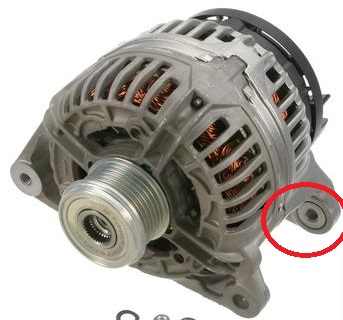

When I read bushing I figured it was one of these (pic) causing a headache, this bushing can move but you might need a hammer and drift to move it:

Not quite the bushing. Here, I took the some more pictures and made notes on them. The side by side shows the little nub that I mentioned on the new alternator. I also showed a picture of what it looks like looking through the hole with the bracket on as well as a picture of the "test fit" that I did before where it fits when the bracket is backwards.

Re: Battery problems and other issues
Grind that sucker off. Or grind on the bracket.
Damn aftermarket crap LOL

I know right? This is ridiculous how long it took me to figure it all out. Although next time I honestly think I could have it done within two hours max.
And to take these pictures I had to remove my alternator again. The first time it took me a whole day. This time it took 5 minutes... Amazing what happens when you known what you are doing!
Edit: Spent less than 1 minute filing down the nub and it's a perfect fit now. Tomorrow morning I should have this thing drivable again!

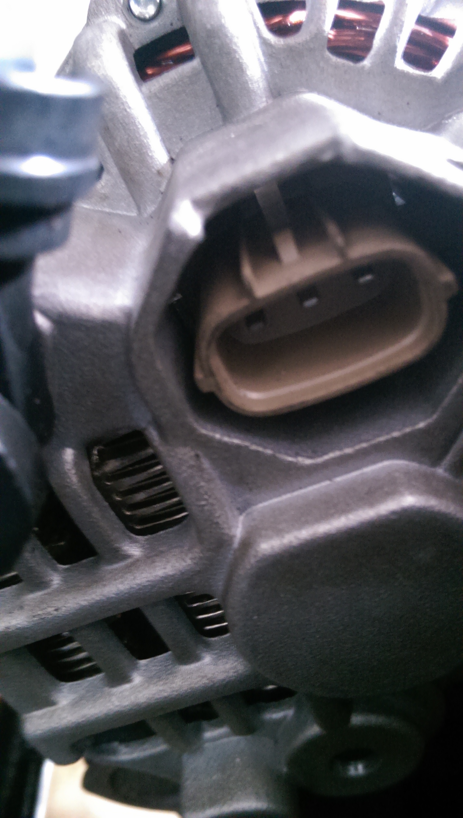

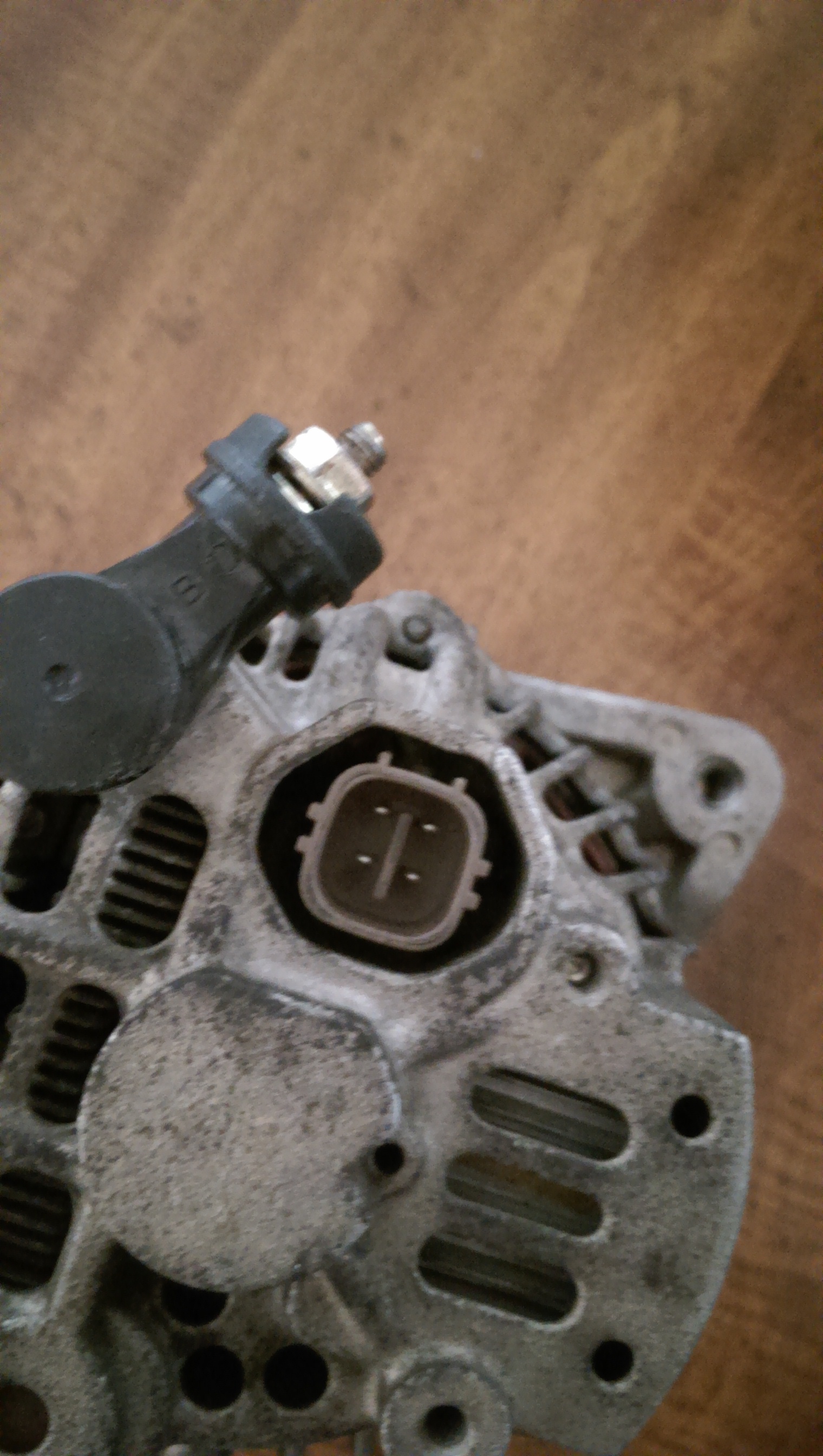

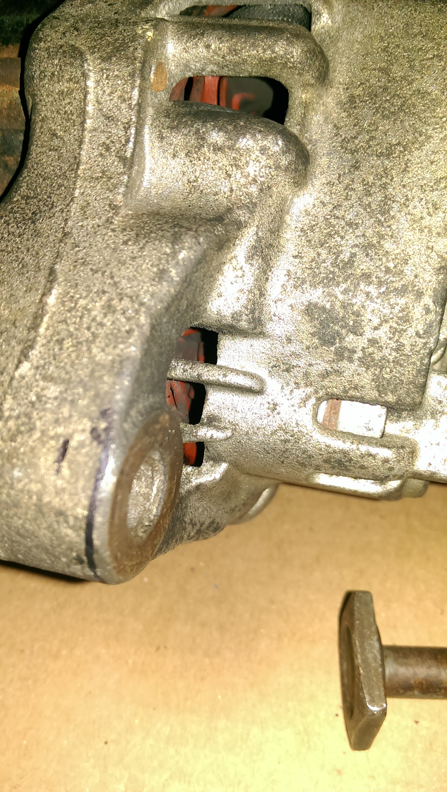

All I can say is that I hate whoever sold me this on Amazon saying it would fit... New problem: plug doesn't fit.
No wonder it didn't want to be installed.
The 3 pin plug is Canadian, 4 pin plug is U.S.
Has to do with the US model having and ELD (EDL..? Whatever that is!)
My new alternator should be here tomorrow and I can probably install it in about an hour. This whole ordeal sucked but I learned a lot from it and am now a pro at replacing alternators...
I think that's the first time I've heard of that but it makes perfect sense.
It's ELD, Electrical Load Detection, that's where the computer can turn the alternator charging up or down depending on needs, electric loads, battery SOC, and they do it for gas mileage.
