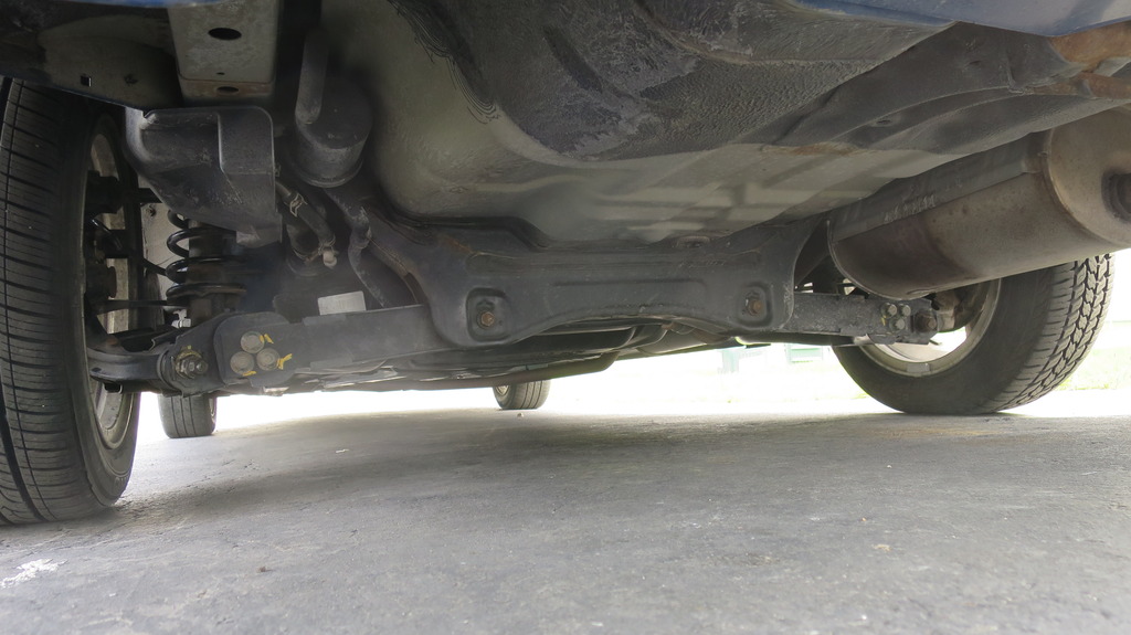

All the parts are almost here for me to completely revamp my entire suspension. My plan is to lower it 1.5", and replace all the bushings, ball joints, and tie rods all-round. So far, I've already replaced the rear trailing & control arms with ones from an '06 RSX. My reasoning on the RSX? The trailing arms, control arms (with excellent bushings vs. mine!), rear sway bar, bushings, and mounting brackets were $90 shipped off Ebay.

She sits about 3/8" lower in the rear end now, but that's marginal, so I can live with it.

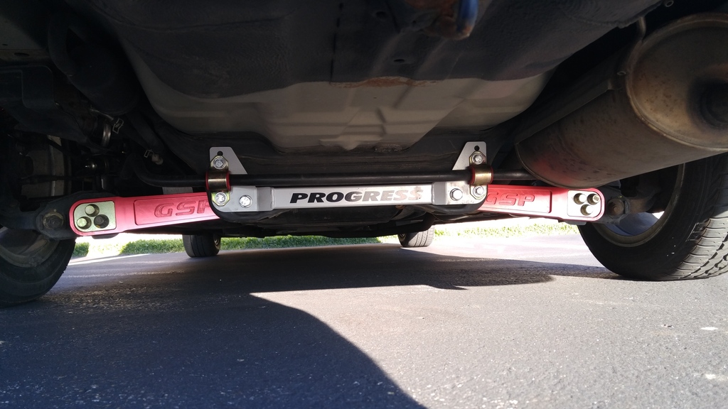

The only reason the RSX sway bar + my new Progress mount isn't on is because Progress forgot to send ANY hardware with my kit!

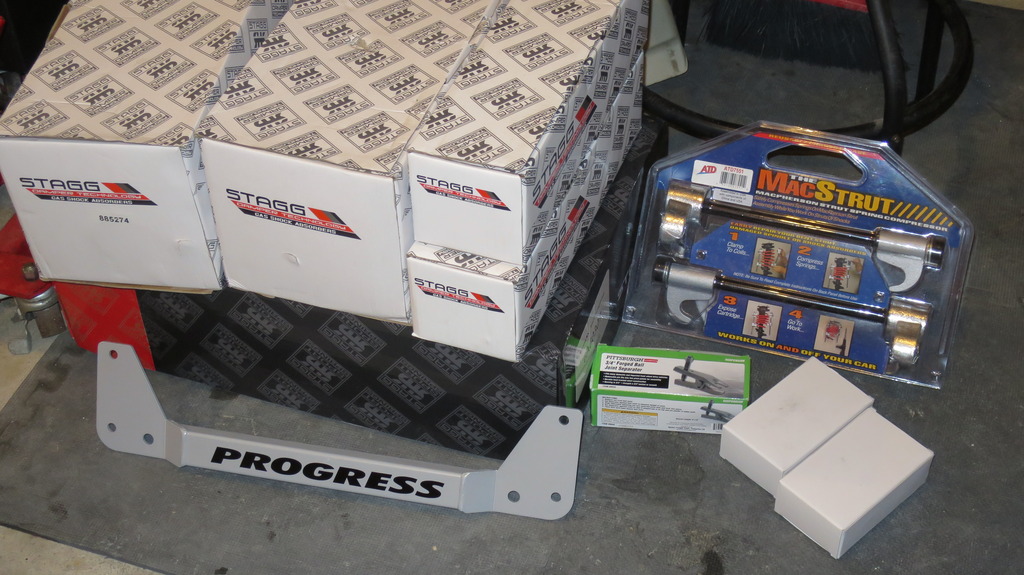

So here's what's waiting to be installed yet:
- Stagg4 1.5" drop springs
- Stagg4 Fr & Rr struts
- Progress rear sway bar mount
- '06 RSX rear sway bar (not pictured)
- brand new OEM front-end kit, including lower control arms, ball joints, front and rear sway bar mounts, tie-rod ends, and new tie rods (not pictured)
- New Moog front strut mounts + bearings
What's the best recommendation for rear (adjustable) camber arms? Heard great things about the adjustable ACDelco ones. Never a problem with fitment.
Also, can I just re-use my old strut spring insulators? How about the rear strut plastic sleeves (as long as they're not busted)?

Didn't know ACDelco made them for a Civic.
I would buy the used set that I have listed in my Sig SPC makes a great kit.
Yes as long as those parts are not busted you can reuse them. Also are your inner tie rods bad? I have never had a bad inner tie rod, not something that usually needs replacing (at least with my experience).
Also since you need to drill the rear holes for the sway bar make sure you have a very sharp drill bit. I burned up my drill making those holes.

UPDATE:
So far, I am loving the setup. Stagg struts and 1.5" Stagg drop springs seem to be a nice pairing, and give it a nice stance. But I REALLY love my '06 RSX 21mm rear sway. I definitely feel a difference in cornering. I am still holding off on doing any front sway setup, from all the understeer comments I've seen on here. What do you guys think? Yay or Nay on a front sway?

The only upgrade for our front sway is a smaller bar or none at all. I removed mine entirely and I enjoy how it feels.

That's about the way I see it. I like how she is now; I'll leave it at that.

Right on, not worth spending money on.
I'll let you know if my opinion changes after I install my coilovers and rear poly bushings.
As of now, suspension wise I have poly front LCA bushings, neuspeed strut bar, rsx 21mm rear sway with poly bushings, rsx-s front struts and springs and stock rear struts/springs.
