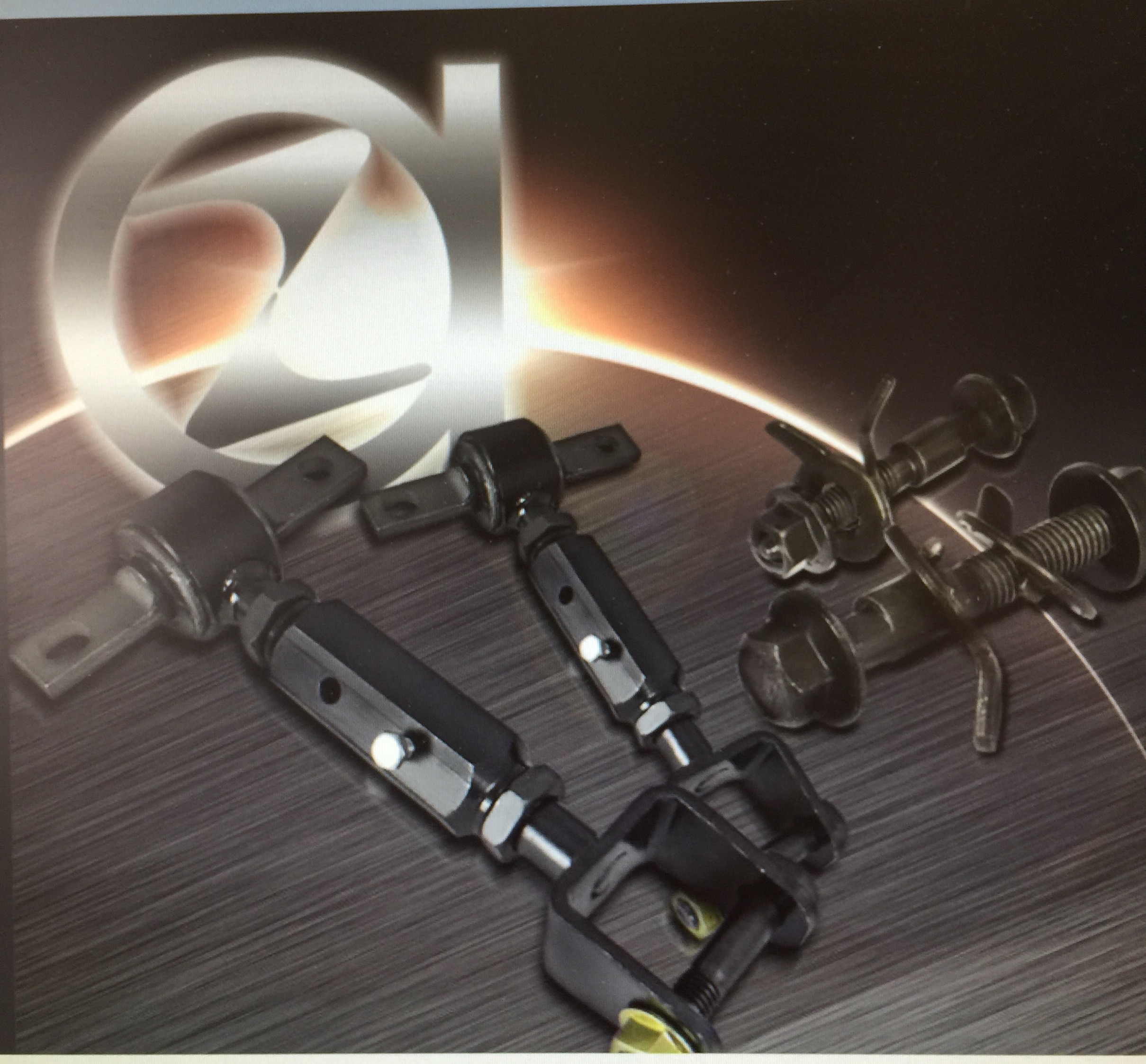

Camber kit

i would advise against the ebay camber kit. go with both the Ingals smart arms and camber bolts.
I agree the rear camber arms needed some modifications on mine. The front camber bolts were fine.
