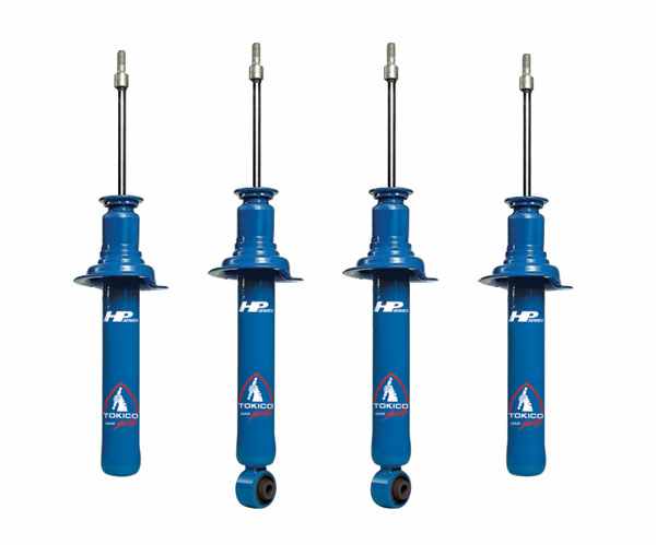

Ok i found the tokiko blues i think. They call them hp's? I hope you can see the attached picture and tell me if these are the right ones. Also with the eibach sport kit, will i need a camber kit to get a proper alignment done?

Yea that's them.
With a pro kit you should be ok without a camber kit. Only benefit would be the ability to tune your suspension using camber.
the sport will go lower, potentially you need the rear ones to bring the camber back to where it should be, closer to zero.
could be later, after you check if you are understeering too much, such as a rainy day. downside is you will need to align car again.

^ I fail! Good catch.
I had a Sportline kit and needed a rear camber kit to get back into spec (this is what the alignment shop told me). If you don't mind riding out of spec alignment then you will be ok.
