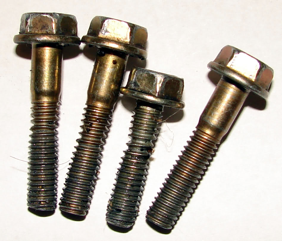

Just seems to me that a moving part like the valve pushrod ought to need more torque to prevent the nut rattling loose.
remember, the camshaft for example spins. the valve adjustment does not.
among other things. Ask a mechanical engineer. (I am one :P)
feel free to over torque. not my problem Some will survive, some will do this:

jeez I didn't realise those valve adjuster nuts could turn into bolts by overtorquing! (sorry couldn't resist)
Lol, good one
