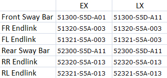

front/rear endlinks and the rear sway bar for both LX and EX have the same part numbers. the only different part number is the front sway bar. Made this handy little table for you to compare part numbers.
I'm not quite sure what the exact differences between the LX and EX front sway bar is, but I can tell you that they're the same size (since the bushings for the LX and the EX are the same part number, as well).
