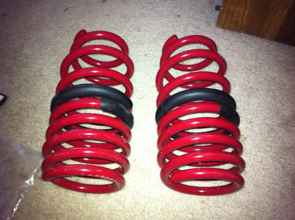

so i just got the eibach springs and had a question...they have this black thing on them (see pic) and i was wondering if i should keep them on or remove them when i install them? they're also on the front ones

Made of rubber, polyurethane or a similar material, right? Those are there to prevent metal to metal contact under compression, leave them on.
Old Aug 25, 2012
Re: questions about lowering my car for the first time
keep! they reduce or eliminate "spring noise" when the coils rub.
