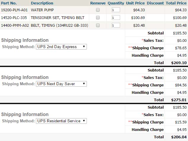

Agreed with everyone else. I'd replace it out of precaution. If you have the mechanical aptitude for a DIY job, it'll cost you about $210 shipped for a timing belt, water pump, and tensioner (from hondaautomotiveparts.com), and a good afternoon worth of work. Only one specialty tool needed (crankshaft pulley holding tool), and you can rent it from an autoparts store (I know my local O'Reilly Auto carries them)
edit: www.hondaautomotiveparts.com shopping cart and various shipping options screenshotted for your viewing pleasure
