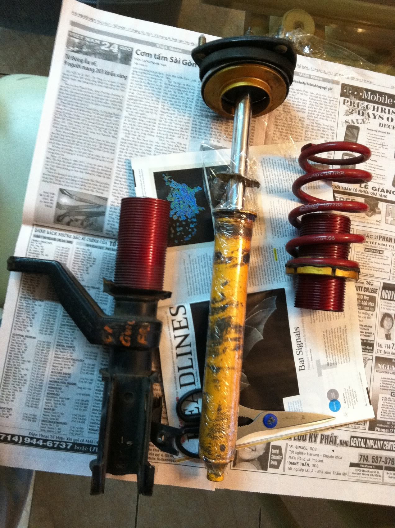

when you buy it, you will JUST get a tube (yours will be red tho, the picture shows the koni yellow series)
you will have to hack ur STOCK suspension, drill a hole at the bottom, insert the seals/rubber dusk cover the proper way, and then install it. its really a PITA.
heres what i mean:

no their direct replacements. no modifying at all. it replaces the oem housings with 50mm housings and a 50mm tube already installed together.
their not like the yellows, just like blues
http://www.7thgenhonda.com/forum/arc...p/t-17440.html
