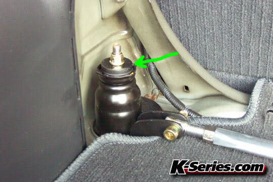

I also noticed that on the top of my rear strut theres a rubber piece sticking out of the top. Ill take pics tonight and upload it. Im thinking that might be the problem.
This is the rubber piece (Picture from Google) and mine looks like its sticking out on one side like it was forced out

At first, it sounded like the spring was still misaligned, but if the mount is damaged that will definitely cause clunking.

I think driving around on the bad spring mightve done that. Whats the worst that could happen? Just an annoying noise?
Look at what happened to this accord owner

^that's the worse that could happen and it if happens to break through while on a hard corner, well..
I'd just replace it if it is indeed damaged, they're cheap. I have a bunch laying around, I'd send you one for the cost of shipping if you didn't live in the states.
