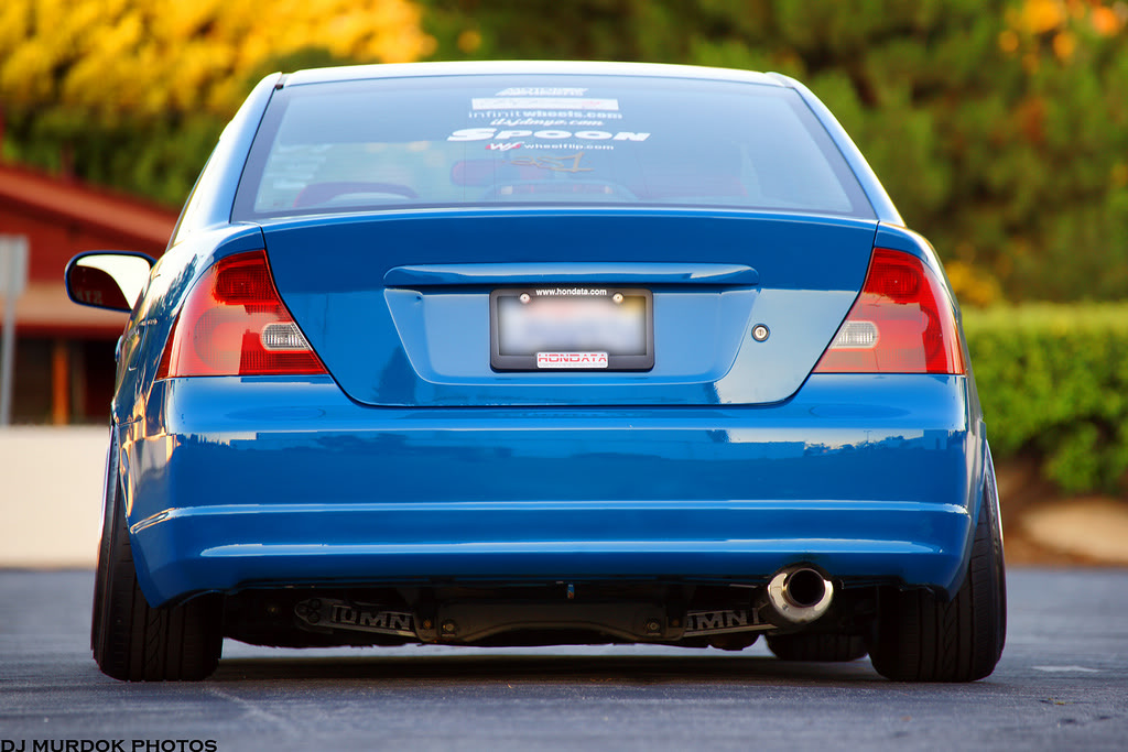

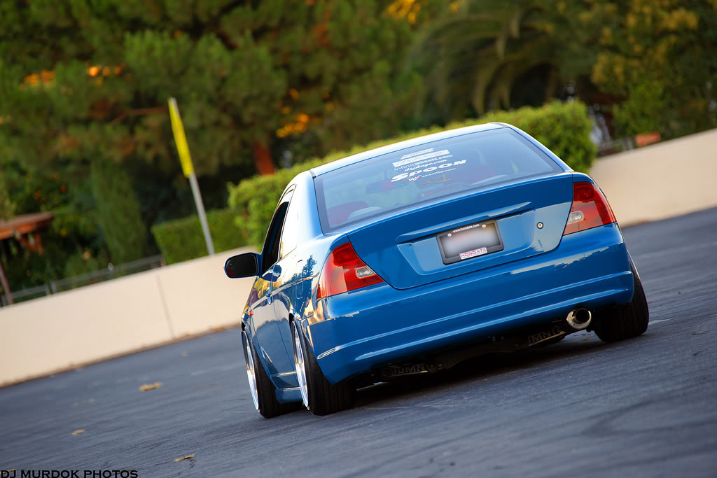

this guy is low
n he has stretched tires
just an example

Originally Posted by sdaidoji
it's just that if if ever the guy comes to high cornering forces, well, the tire could simply fall off the wheel in the inside due to the direction of the forces. ever seem how much a tire could twist during cornering? (PS: drifting is in kinetical friction, so the actual grip is lower than non-drift conditions).
stretched tires actually have less flex when cornering.as long as you use higher PSI and check them on a daily basis stretched tires are fine.
they might.
but working for a tire company, and the potential square footprint of the tires does not amuse me. Safe? could be.
but don't want to do it, but that will be a personal preference, so let's leave that at it

It would be cheaper to just get skinnier/shorter tires/wheels with a stickier compound. The camber on that will make you eat up tires very quickly. And will result in less traction. The "hella flush" look is definately all show and no go.

as long as your not obsurdly stretched 195/50 or 205/40 on a 8 inch wide tire your good. and id say your no more in danger then these people driving around with old worn dry rotted tires.

Where did you find those pictures- is that a member on this site or a different one? I dont recognize the car, but its pretty damn clean.
Tire stretching Wasnt this done by drifters that couldnt get the right size tires for their rims, and just made do with what they could get since they burn through them daily?
Get a set of fully adjustable coilovers and you can drop it super low, also get a rear camber kit and roll your fenders. You'll have some negative camber which will mess your handling up on everything from straight highways to curvey roads and eat through tires pretty quick, but that sounds like what you want.

The only way to go that low is a fully built suspension.
Coil overs will put you that low, but you need to upgrade every other part of the suspension to handle the tough conditions that being that low create. Definitely possible to do for a couple thousand though.

On the threads, the camber seem a little more even F/R than the pics here, so might be a little better than i initially thought. The 2nd pic in here the fronts seems with a little less camber, which threw a flag on me (bad experiences with excessive rear camber previously).

i think he's on 17x7 front and 17x8 rear work vs sx rims
n yea i believe he is K24 swapped he's probably 185/45/17 on the back and 175/45/17 on the front, idk if thats 100% right but a guess

That would be an absolutely insane stretch. Without going through his build thread, I'd say guess at 205/40/17-195/40/17 or 215/40/17-205/40/17
