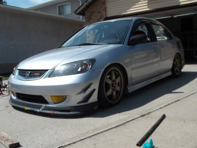

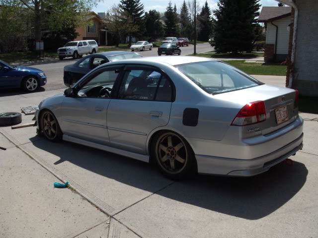

I just installed my coilovers on for my civic and as i dropped the car down i noticed that my car has really nasty toe out.
Is there anyway i can adjust this?
I don't want to drive it anymore because it's eating down my inner tread on my front tires really badly and it starts to tire screech when i go over 50km/h
Has anyone had this problem before?
btw here are some pics of the drop for who ever's curious
